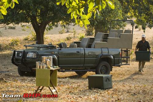

Tryting to attach a snap of the 4x4 vehicles used by Taj

One More photo of the telcoline 4x4 modified safari vehicle.

Which national park is it, where this vehicle is shown in the photo?

These vehicles are custom made for the TAJ group of Hotels,( it helps to be a part of the Tata group ) who run 2 Safari properties - Bandhavgarh and Pench National parks. The Bandhavgarh property was featured in the CondeNaste traveller mag.
Indian Luxury Travel | Taj Safaris The pictures are from their website. The vehicles featured in either Autocar or some other Auto mag a few months back.
Unconfirmed info - These vehicles are also being used by Cicada resorts in Bandipur.

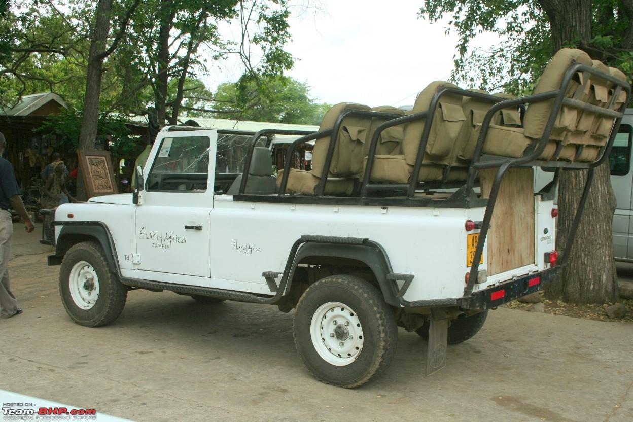

. The modifications on these vehicles are standard for all Safaris. Last to last year I went on a safari and sat on the last overhanging seat. The driver, it seemed had some scores to settle with me; he made sure that I got down with a sore ***.
The advantage is of a higher view, but it is over ruled by the uncomfort(I just wanted to share the experience with other members, if anybody plans such a trip, must keep this in mind.)
