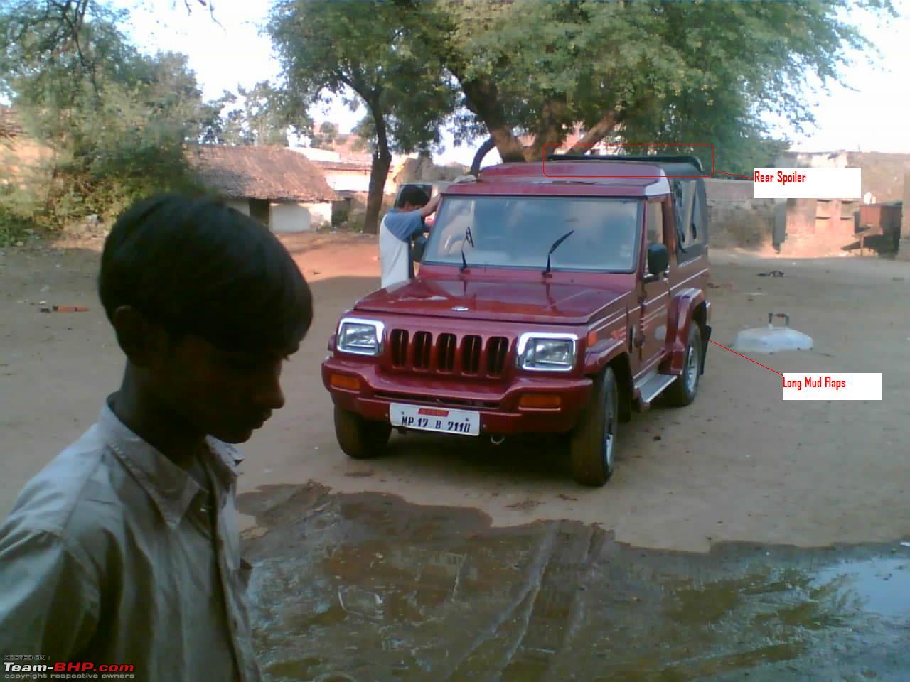

Hi Arka,
I agree with all your points/logic, but here i am talking about my first hand experince. I do not know technial jargons or as technically sound as you guys. But we have jeeps from GPW to 52, Willys, CJ3B to Invader. But we never faced this kind of problem in any vehicle. Infact this was the sole reason for selling this vehicle. please refer below pic where i have marked extra fittings by MM.
I am also waiting for Behram Dabhar reply on this .

Hi Arka,
Invader has more Bernoulli effect because of its shape e.g. especially that foil roof that pops air up into the...er, ... air. But the dust has to come in some opening. Find that opening, plug it and the problem is solved. If the doors do not fit tight they can be alligned and rubber molding material, even cut inner tube rubber, can be added. Same with the rear after market tailgate fittings. I will grant you, it is easier said than done. Holes leaking water or dust can be really hard to find. One way they find auto leaks outside India is to pressurize the interior with a strong fan with dry ice inside. Then watch for where the fog, vapor, comes out of the vehicle. They plug the hole and repeat the procedure.
My Tata Spacio leaks dust thru the tailgate and doors almost as badly as if there was a window open. It's a hardtop, too. I clean and cope.
Thanks DirtyDan. Just to reduce this cumbersome process, i have sold my Invader .
