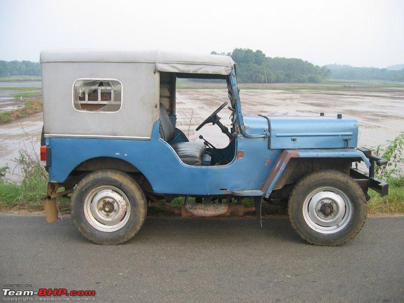

Default Pics of my CJ3B
Please find the pics as I was unable to attach them in my previous post.
Rebirth of a CJ3B, The Unstoppable Legend ! -By JeepCaptain-cj3b_front_closeup.jpg
Regards
JC

Hi Shibu,
Where are you getting this Jeep rebuilt? Background looks like Kerala?
Nice Jeep, why not some engine pics? How is the sheet metal condition?
67' means a kaiser right?
regds
Sant

Hey Shibu,
Wish you luck with the project. Are the wiper mounts in the original position?
beejay is offline

Hi Shibu,
regds
Sant
Santhosh, I am getting it done in kerala and my brother is helping me to do it. Its not Kaiser, Its made in India by M&M
Will post engine pics soon.
Originally Posted by beejay View Post
Hey Shibu,
Thanks Beejay, the current wiper is from bajaj autorikshaw i guess. I am replacing the entire windshield since ite rusted beyond repair so need to think about the wipers now. Any suggestions?
JeepCaptain is offline

Shibu, Do you think it would look nice if you are able to mount the spare wheel onto the side?
Stick to some of the old shades, I am sure someone here would have the brochure of the CJ3B. Me thinks the old shades are way too classy on a CJ3B. There is a CJ3b getting restored here in Coonoor. Amazing shade, a very light rustic brown.

Atul, the bumper extenders are already removed. Yes I have started the restoration after 2 years and I am trying to make it as close as to the original.
Beejay, I was also thinking to move the spare wheel to the side. And yes I will be going for one classic shade. Still havent decided on the colour.
Any suggestions are welcome.
