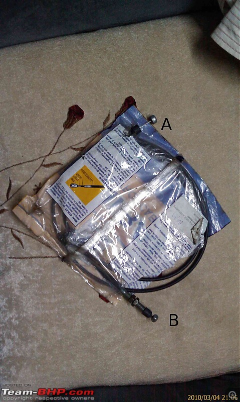

Jaggu Bhai, it is indeed that bad. I am not in any remote corner, I am in Delhi - and today I scouted Mayapuri and Kashmiri gate - the mecca of spare parts and couldn't find this cable.
Apparently there are 4 types of cable for Gypsies -
1. for MG410/MG410W
2. for Carburettor MG413W
3. for pre-2003 MPFI MG413W
4. for current MPFI MG413W
I was able to get accelerator cable for the current MPFI MG413W but it won't fit in my 2002 MPFI MG413W. I am attaching a pic of the one I bought. In this end A is round whereas end B is cylindrical. In the one for 2002 MPFI MG413W, both will be cylindrical, with end A being slightly smaller that end-B.
Now another issue is I don't know it's part number, so can't order it from GAPL, Okhla. If I can somehow know it, they will get it in a fortnight.
I am ay my wits' end. Please help me/give some pointers.
Harjeev/Amar, will Rahul (Motorcraft) have it? Please give me his phone number.
Nitin

I managed to procure the accelerator cable (it's part no is 15910M830A0) from GAPL.
I have also bought the spare parts manual for MPFI Gypsy. If anybody wants to know part number of anything, just drop a PM to me :-)
