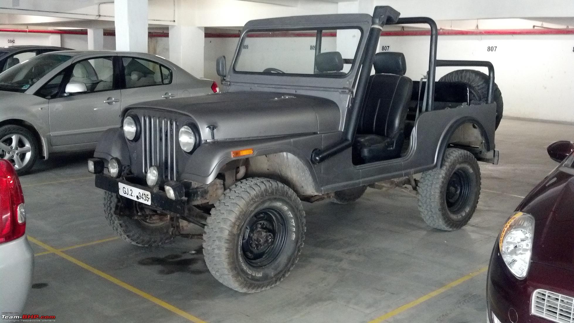

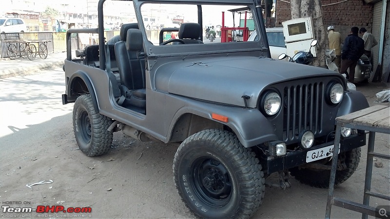

The Jeep came back around the end of last year after the paint job and the snorkel. Some pending issues that remained were
1) Broken windshield
2) Starting trouble
3) Change oil-based air filter to Bolero paper-type
4) Electricals - Foglights, instrument panel lights, front/rear indicators, wipers, etc
5) Front leaf-spring recambering
6) Fuel tank placed under rear seat
7) Seat cushions for rear front-facing seat and side-seats
8) Bikini soft-top
1) Broken windshield - Now I picked up new windshield frame from a local Jeep body fabricator Sabuwala. While fitting a new rubber strip around the windshield just before Mcube, the windshield had cracked but it was too late to do anything so drove with that and once it came back, things didn't move. When we started looking for a new glass, it didn't seem to be available anywhere. Finally after driving it for a couple of days without the windshield, I found a new glass at a shop and the job was done in 20 mins flat!

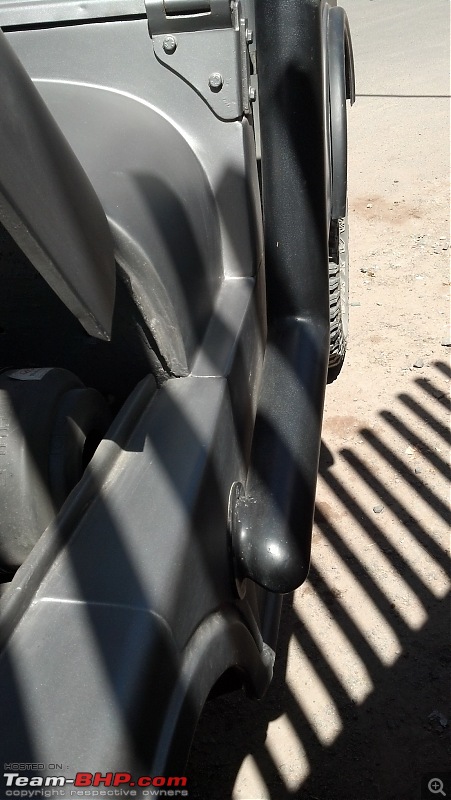

3) Changed air-filter to Bolero paper-type - Was on the oil-sump based filter and changing to the paper-type seems better and the engine does feel like its breathing better. I believe the TCIC Safari and Bolero share a similar filter element and have used the Arrowhead filter in the Safari and am thinking I'll install a similar one in the Jeep. Should help things further.
Taking the Plunge, bought an MM540DP. EDIT : Now with 14B!-filter-3.jpg
Taking the Plunge, bought an MM540DP. EDIT : Now with 14B!-snorkel-layout.jpg

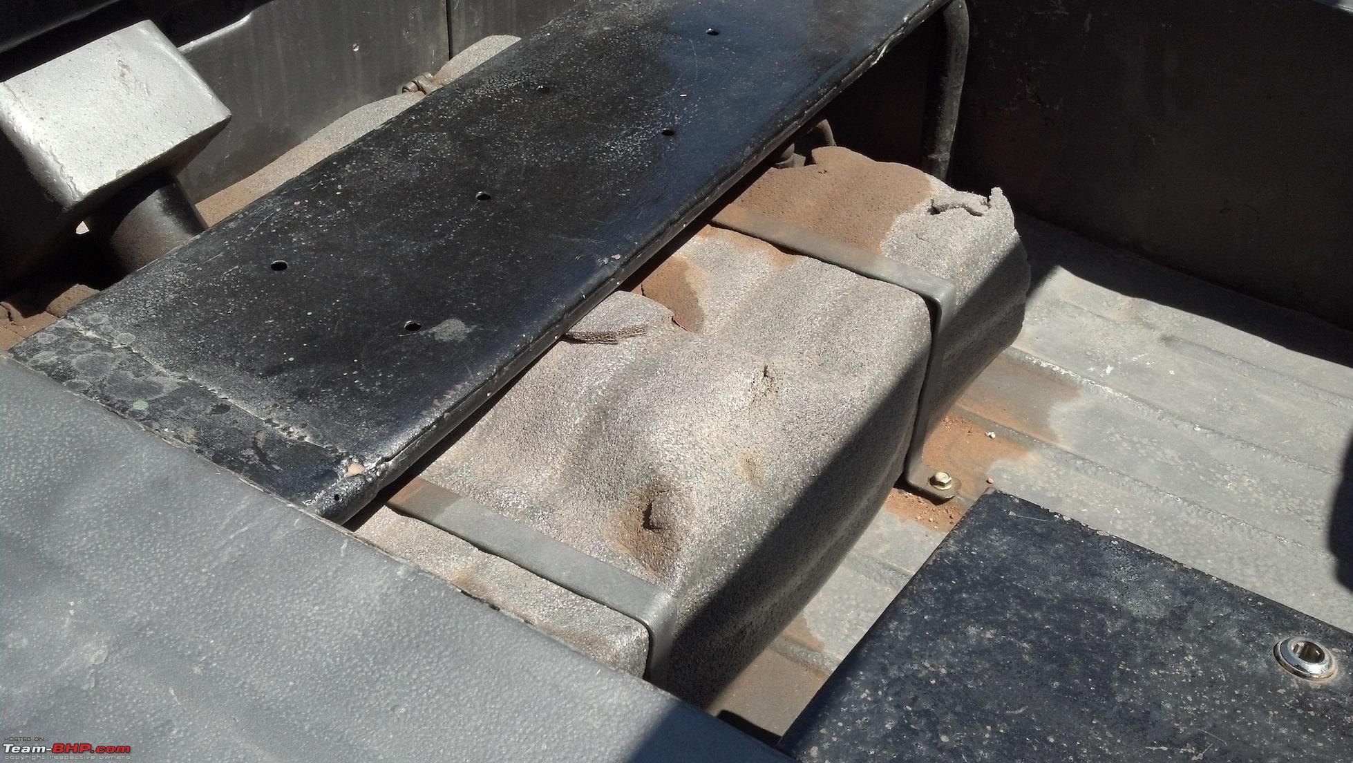

6) Fuel-tank under rear seat - Have heard a few people face a punctured fuel tank or the fuel-line so shifted the fuel tank above the body and placed a front-facing seat on top of it.
Taking the Plunge, bought an MM540DP. EDIT : Now with 14B!-fueltankunderseat.jpg

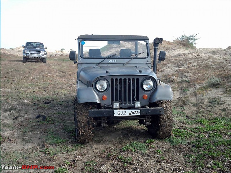

These two are pending and will be done next. Right now just enjoying the Jeep. And loving it. As usual, it goes where you point it and it comes out thanks to all the torque available! One thing Allan told me which I totally agree is that once you drive a 14B 5x0, you'll never enjoy the Peugeot engined ones again! Few pics from an off-road outing last weekend
Taking the Plunge, bought an MM540DP. EDIT : Now with 14B!-sandstorm1.jpg
Taking the Plunge, bought an MM540DP. EDIT : Now with 14B!-sandstorm-2.jpg
Taking the Plunge, bought an MM540DP. EDIT : Now with 14B!-sandstorm-3.jpg
Taking the Plunge, bought an MM540DP. EDIT : Now with 14B!-sandstorm-4.jpg

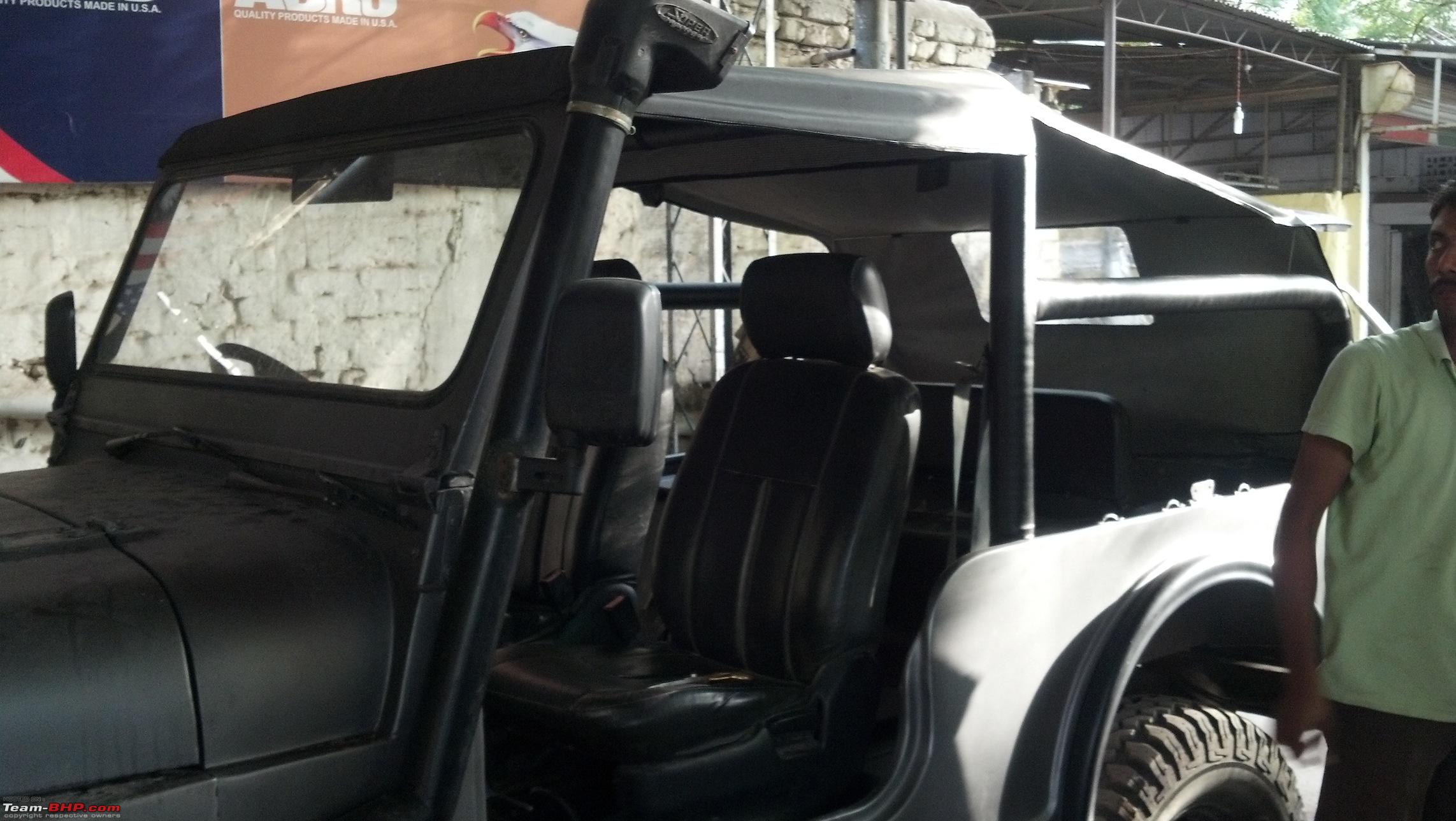

With the onset of the Ahmedabad summer, a topless Jeep becomes an odd vehicle to drive. Mind you, it still attracts the same amount of attention from the regular sedan crowd but now instead of appreciating the Jeep for its stance and build, they pity the driver for the sun-bath he's forced to have!
1) Soft-top - Wasn't looking to cover it on all sides but primarily the roof alone. Also, since I usually don't even have a passenger sitting along, I wanted a full and a half soft-top. And of course fully removable when I want the windshield down. Obviously the stock 540/Thar soft-tops weren't an option anymore. In any case, I don't like the boxy rear and wanted a sloping rear. Did a few amateur MS Paint-designs and this is what I eventually ended up with:
Front only

2) Seat-cushions - I had put a small front-facing bench on top of the fuel-tank as you see here
This had to moved forward to avoid the sloping soft-top from irritating the seat occupants. The space behind the front-facing seat will now have a flat sheet-metal base on top of the fuel-tank to serve as a luggage holder.

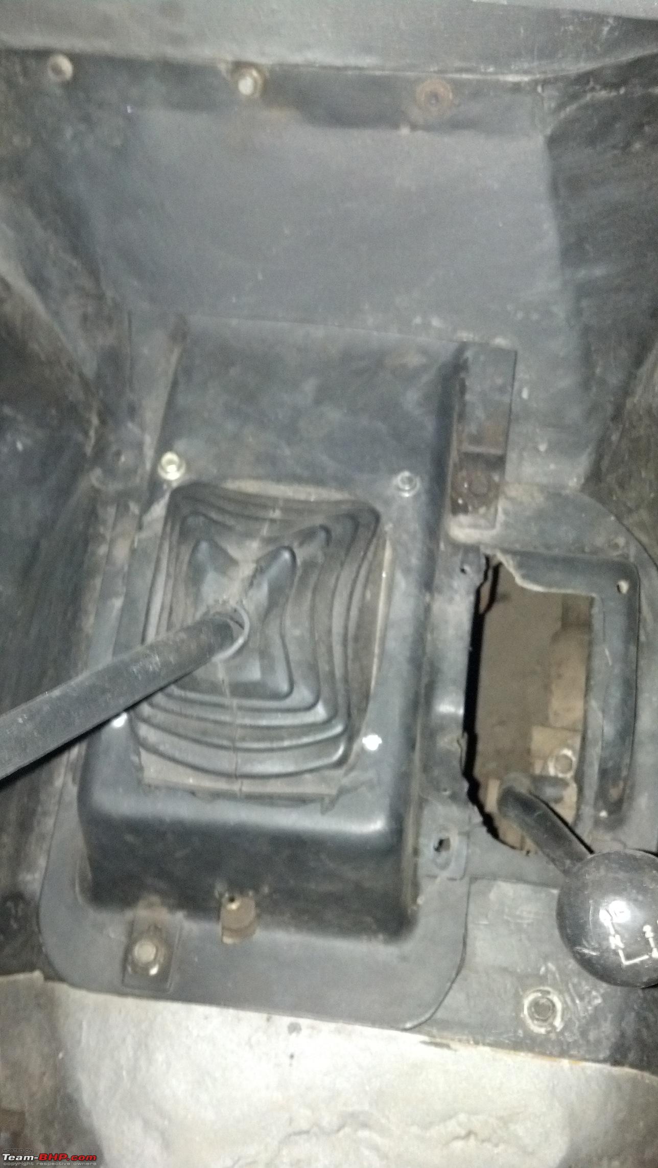

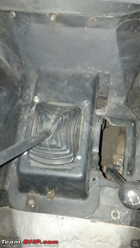

3) Flooring - My earlier floor looked something like this:
Taking the Plunge, bought an MM540DP. EDIT : Now with 14B!-20130103-22.46.12.jpg
Taking the Plunge, bought an MM540DP. EDIT : Now with 14B!-20130103-22.46.24.jpg
Not only did I need a new 2-gear fiber gear cover (found with the help from Nachiket in Goa) and painted it in black here:
Taking the Plunge, bought an MM540DP. EDIT : Now with 14B!-20130324-12.43.54.jpg
but also need insulation and floor mats though the same black cover couldn't be masked properly:

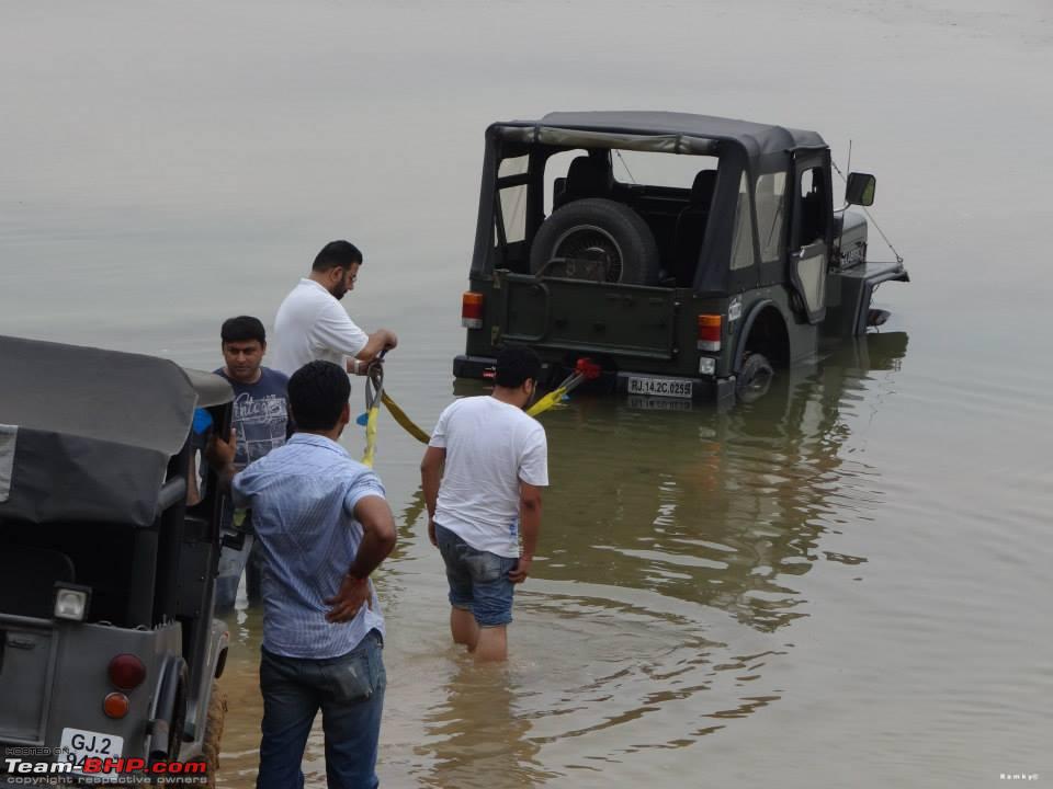

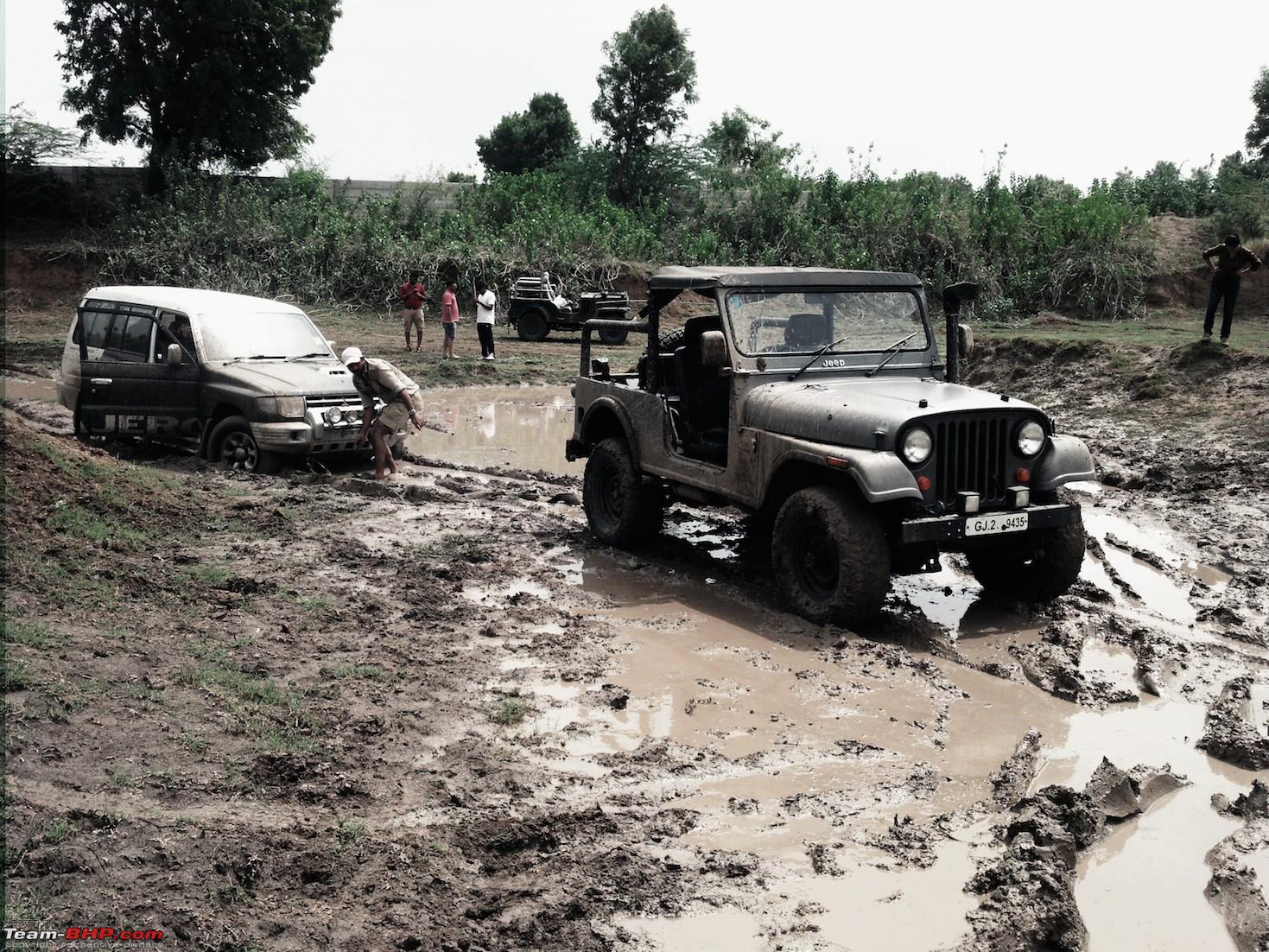

Ahmedabad has been rather active on the offroad scene lately and hence this post is only going to be about pics of my Jeep from the OTRs. No issues with the Jeep so far

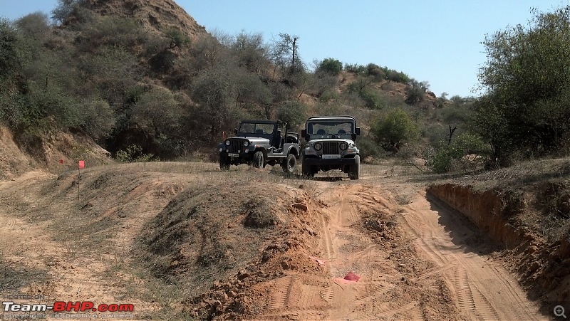

The OTR scene has picked up over the last year or so and we've been able to manage quite a few outings. I think we've managed to gain the critical mass needed to create an active off-road culture in and around Ahmedabad. This is our group Link
Some pics from recent outings:
