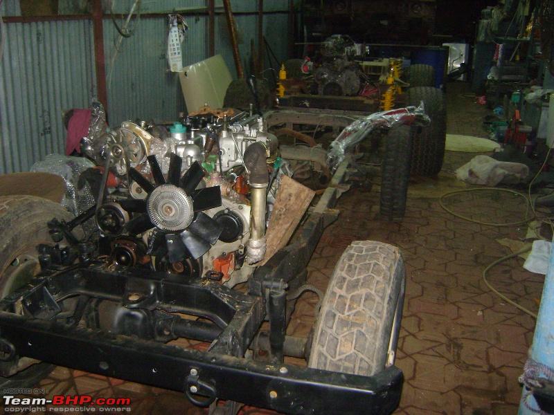

Another thing I forgot to tell you is that the oil filter will foul with the steering link rod. You will have to use a smaller filter (Isuzu).

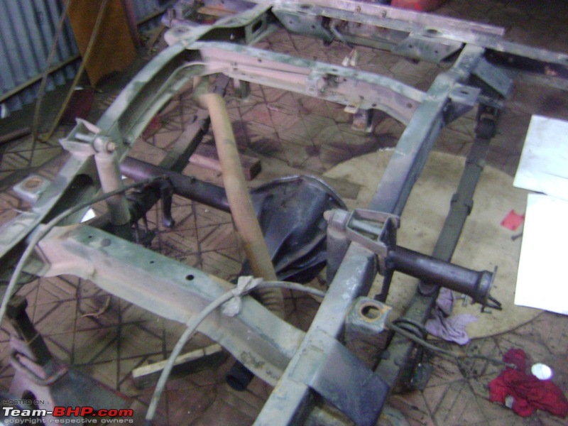

i just removed the axles and differential from the right offset 550,
also purchased the left offset diff housing
shall assemble this tomorow

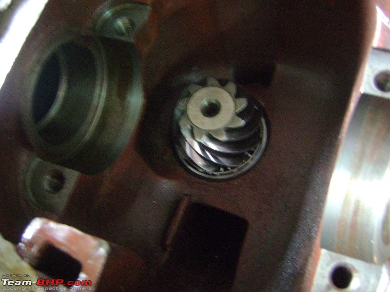

left offset differential is ready
only left to fit in the axles

the old diff orientation of the 550
the 550 differential removal along with the axles

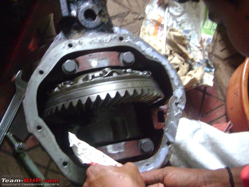

the two diff housings
550 and 2wd 540 with the axles
the assembly into the 540 diff

the new orientation clap:
