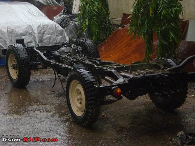

project on in full swing
body has been removed off the chassis to start full sanding of the body as well as the chassis

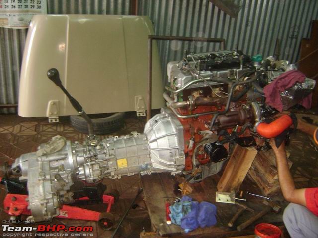

the engine

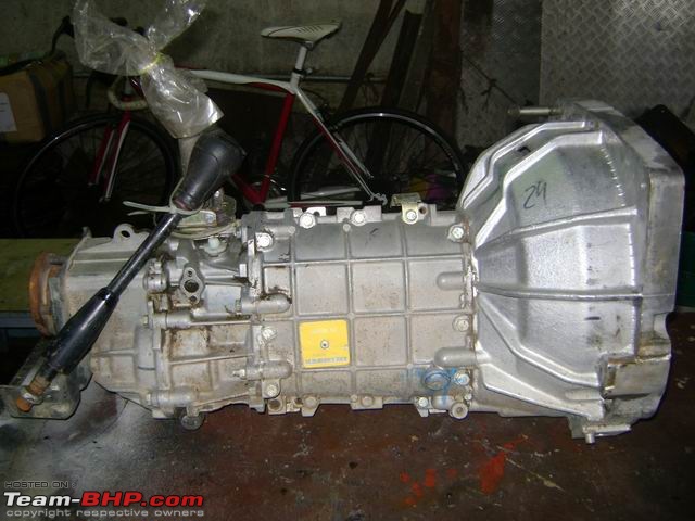

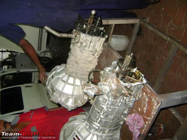

the ngt 530 3wd gearbox

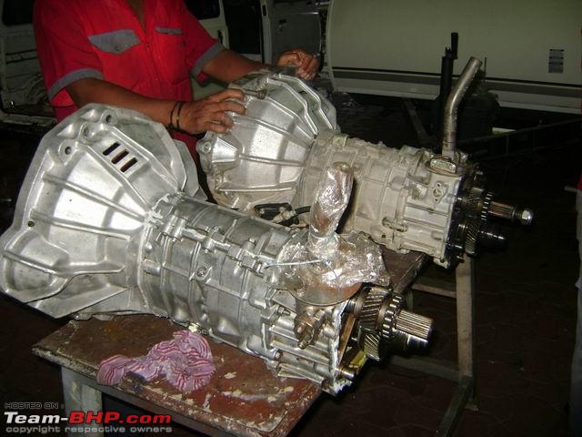

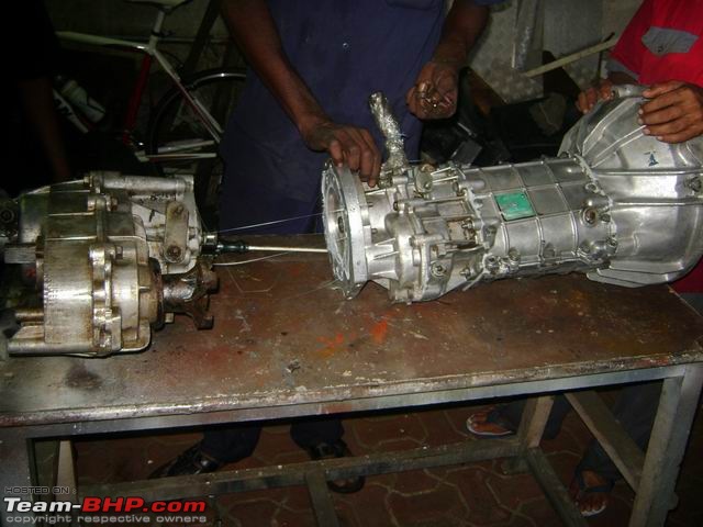

the ba10 4wd gearbox with the manual borg warner transfer case

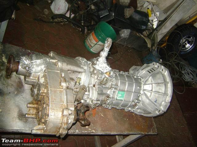

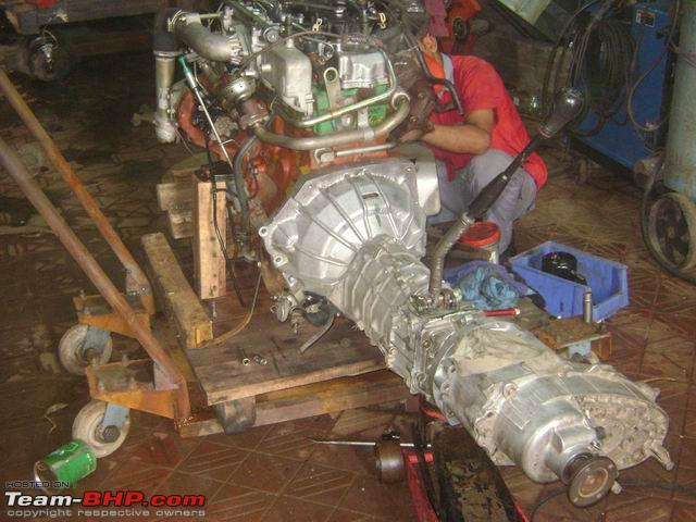

now the process to remove the transfer case from the ba10 and put it onto the ngt530

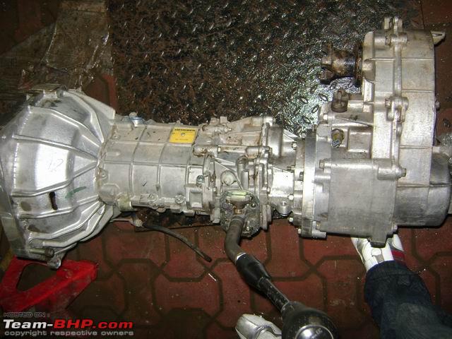

and voila the ngt 530 with the manual borg warner tranfer case, what some say is rareclap:
Hmm, interesting. This combination ^^ is present in a few export 4wd models.
Spike
PS- Allan what about the rear propeller shaft. Is the position of the transmission mounting cross member the same?:D
