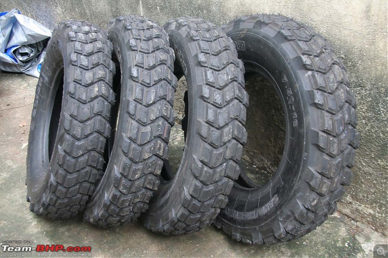

After long search for Tyres and rims, I end up with this brand new Army Sand/Highway tyres. :Cheering:
(In future I will upgrade to 8.5J rims and 32" MT tyres)
This time I don't want to miss Akc/Examm and of-course to meet all of you at the event, so I decided to go for only army tyres for time being.

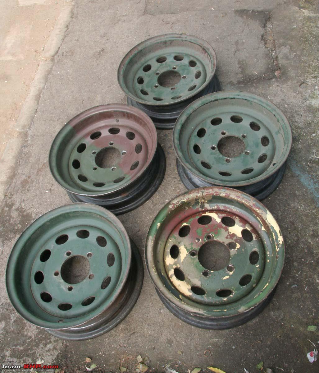

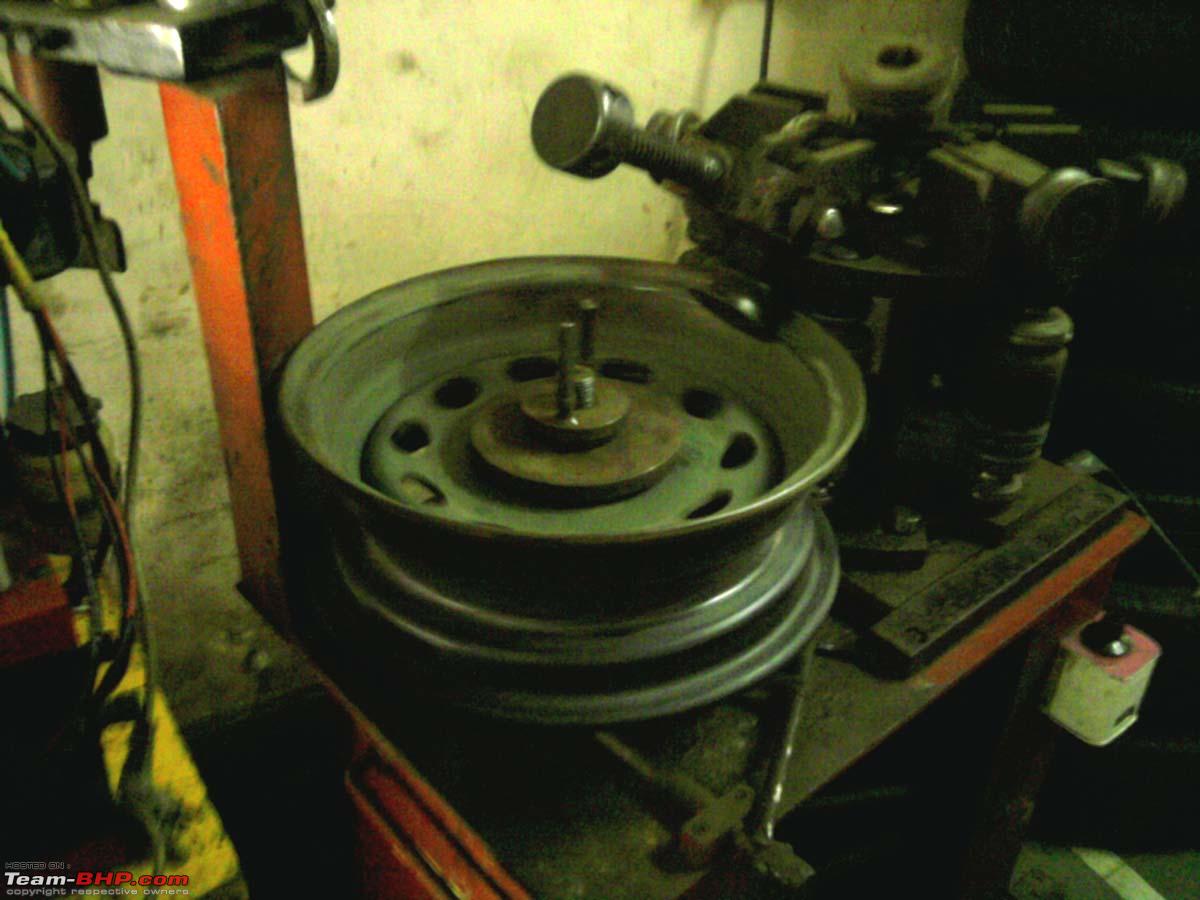

Process Done: Rim Alignment, Shot Blasting on Rims, Painting Rims, Installing New Tyres with Nitrogen Air
- Rim Alignment: in the process of rim alignment, I found that all rims were in good condition.

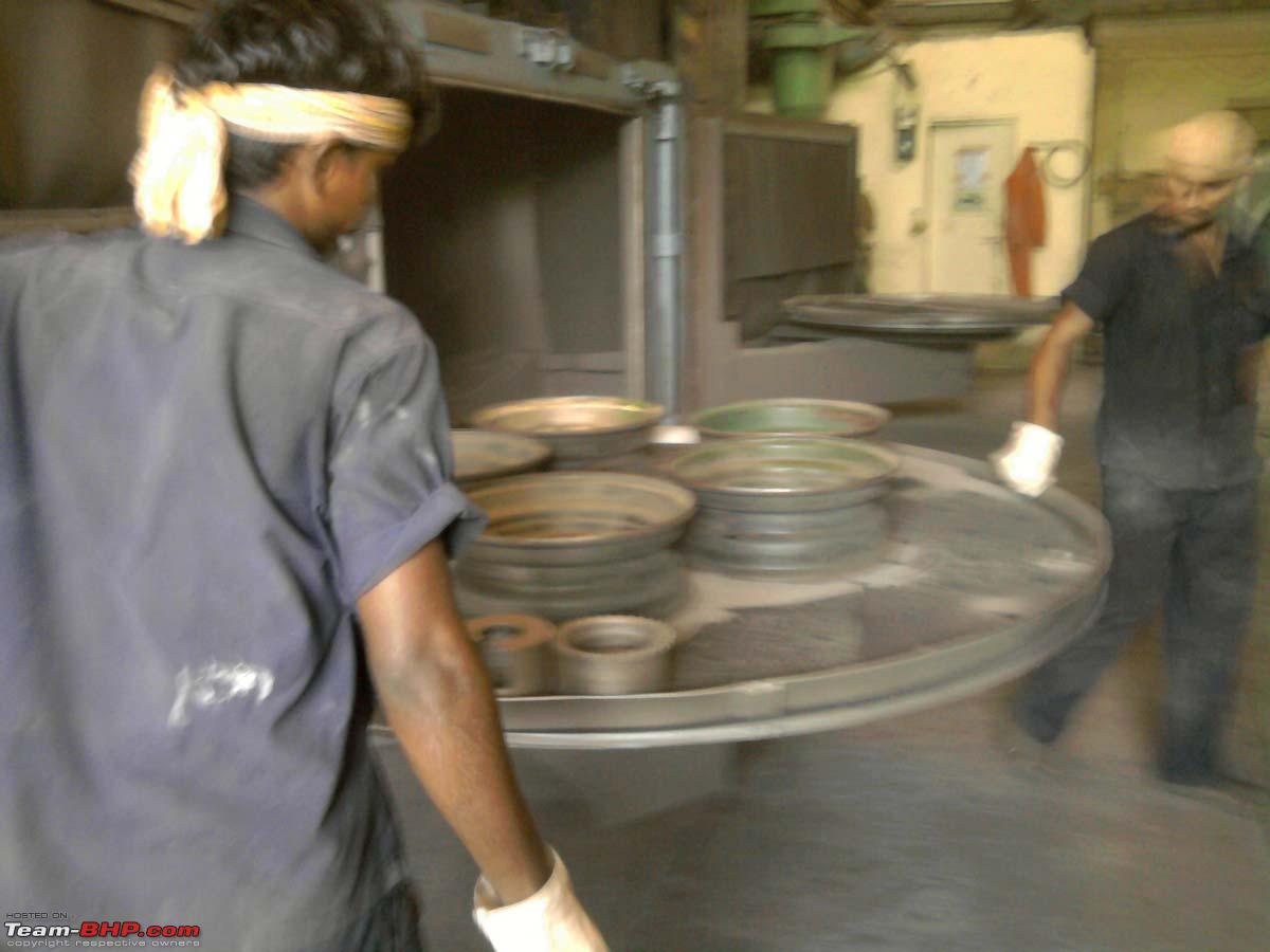

- Shot Blasting on Rims (to remove 3-4 layers of old paint)
WIP pics of Sand blasting

- Before:
Ex Army MM 550 - "It's tough, but not impossible"-img_5656.jpg Ex Army MM 550 - "It's tough, but not impossible"-img_5660.jpg

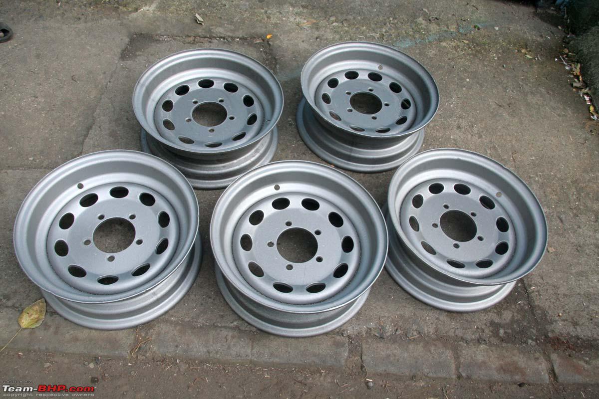

- After:
Ex Army MM 550 - "It's tough, but not impossible"-img_5662.jpg Ex Army MM 550 - "It's tough, but not impossible"-img_5663.jpg

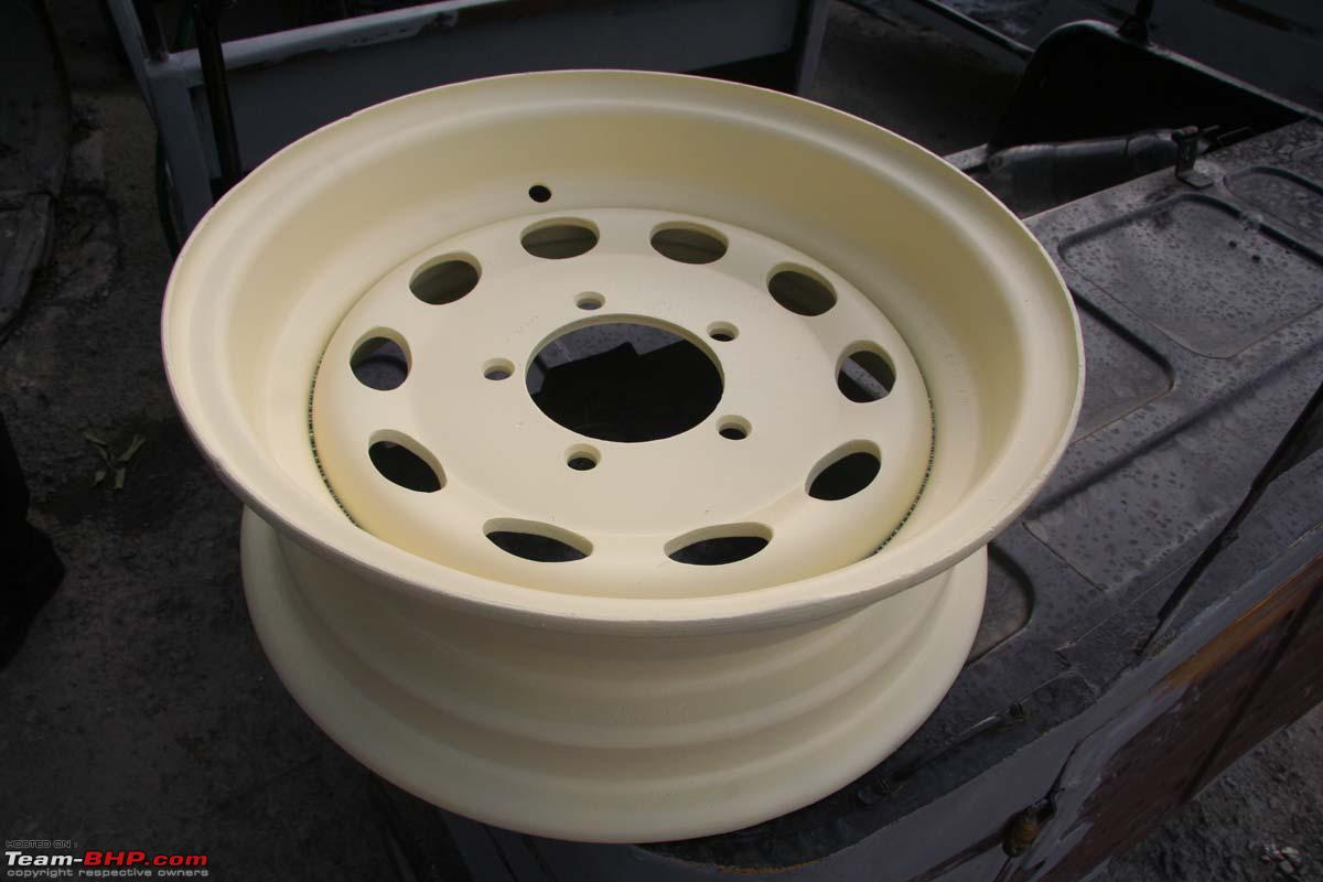

- Paint process: applied 2-3 coat of white primer.
Ex Army MM 550 - "It's tough, but not impossible"-img_5664.jpg Ex Army MM 550 - "It's tough, but not impossible"-img_5666.jpg
- Final Product: applied 2 coat of final paint.
Ex Army MM 550 - "It's tough, but not impossible"-img_5680.jpg Ex Army MM 550 - "It's tough, but not impossible"-img_5681.jpg

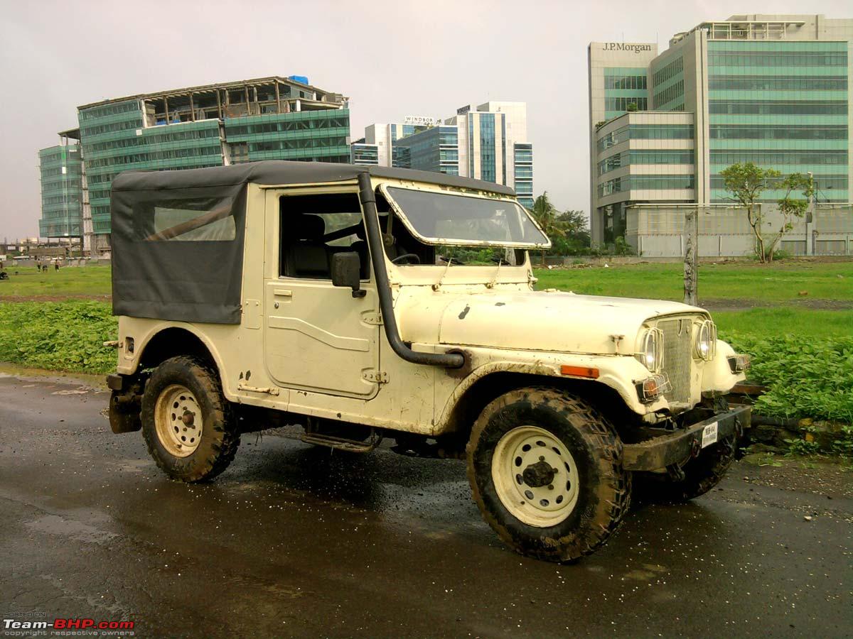

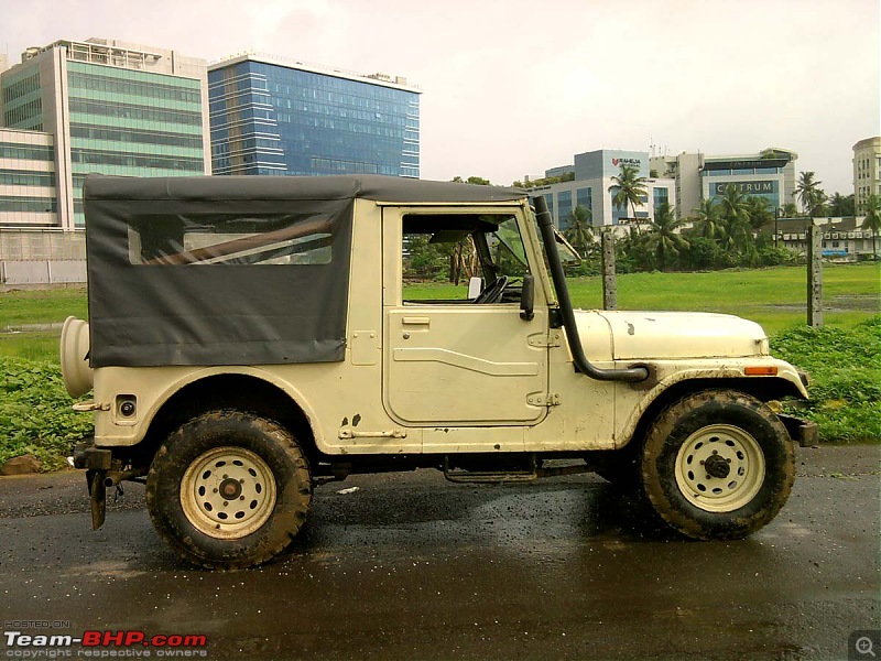

Below pics I have taken from my cell. This was my first experience with 4x4 after I installed new tyres, I have tasted them for 10 min in mud.
Enjoy Pics!

How are these tyres in mud? My understanding was they are better off for sand and road? What tyre pressure are you planning to use for slush?
But the work on the rims are very thorough! I definitely like it!
Dear Jaggu,
I have no idea how these tyres will perform in mud. I bought it for the time being.
I will try between 28-30 tyre pressure for slush. If you have any experience about these tyres, pls share with me.
Thanks!
Sanjay
Go lower pressure, around 15 is what saved us in munnar IIRC :)
This is purely in my experience - before I replaced them
I've run the Sand/Highway tires - Apollo Bullets -on road and wet mud
On road
- They're noisy ,and sound just like truck tires
- They're bumpy and tend to sway above 75kmph speeds
On wet mud
- They tend to 'chew' in and lose traction
To add to the ^^ With full air pressure, they kinda get backed with mud which will not dislodge and becomes as good as bald tyres. Lowering pressure but showed really good difference.
