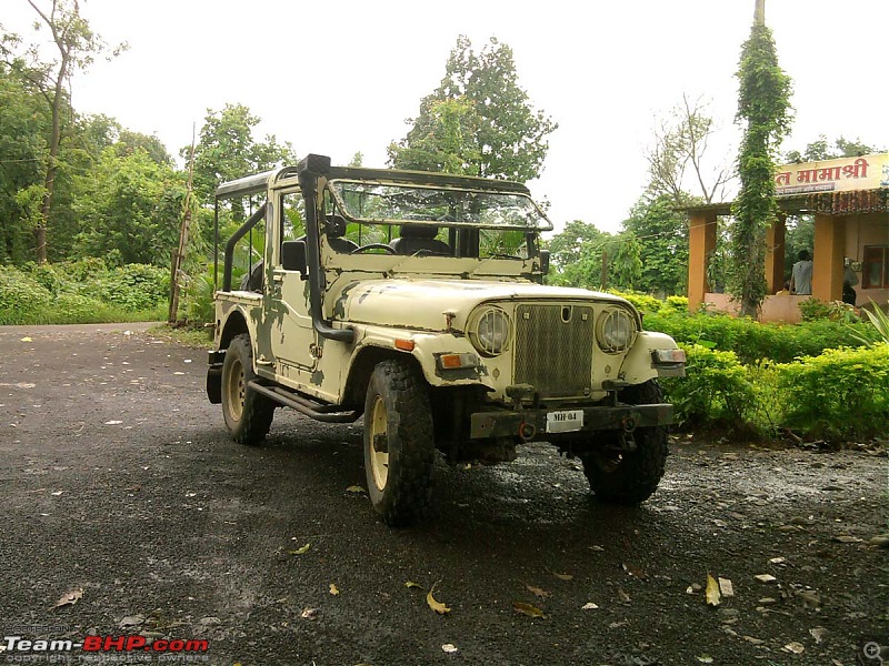

ROCK SLIDER:
Finally we got the another fabricator to do rest work of Rock slider.
It fits directly on chassis.

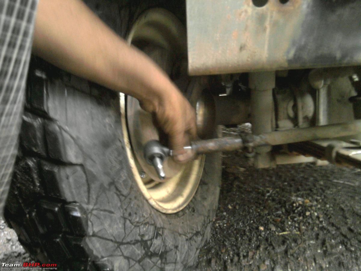

TIE ROD END :
Got new Tie rod end and fitted.

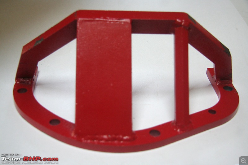

DIFFERENTIAL GUARD :
Received from Swatik Fab. Thanks Vijay!

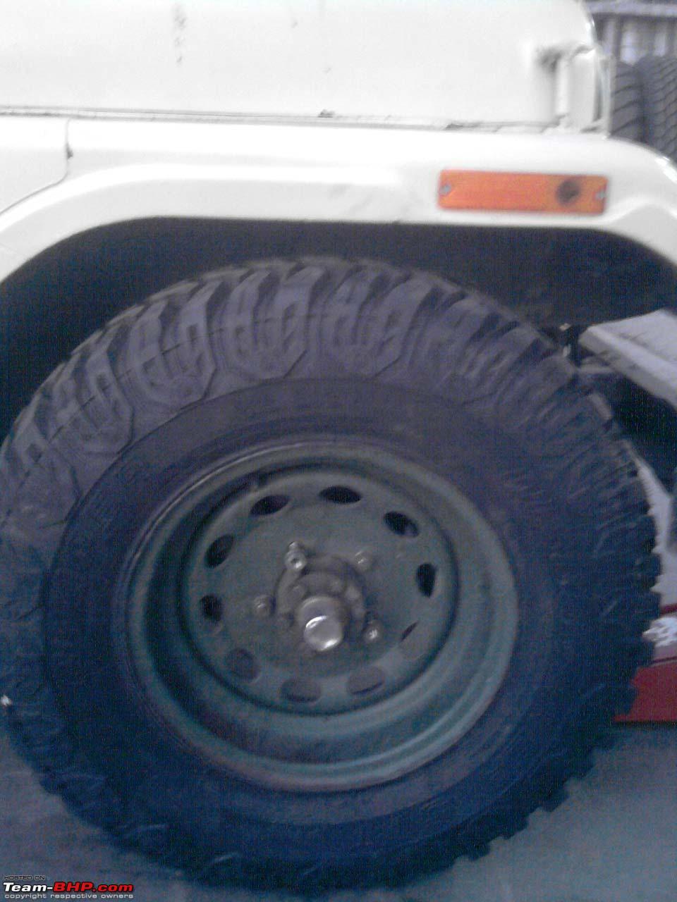

I have acquired my MM 550 XDP last week and would like to follow your foot steps. I would like to know the details about the below tires that you had tried once on your jeep.
Hi,
That is Cooper STT 235 / 85 / 16.

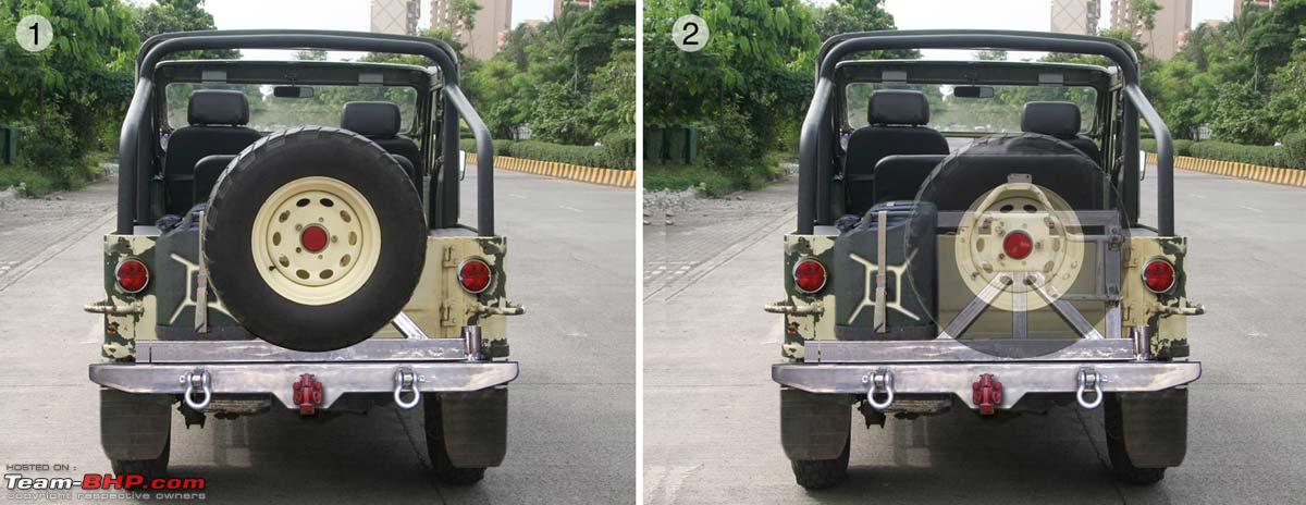

New Fabrication Project - Swing out Tyre carrier
Design 1 and 2.
In 2nd pics, I am using my existing brackets frame. So no need to fabricate new mount plate for tyre.

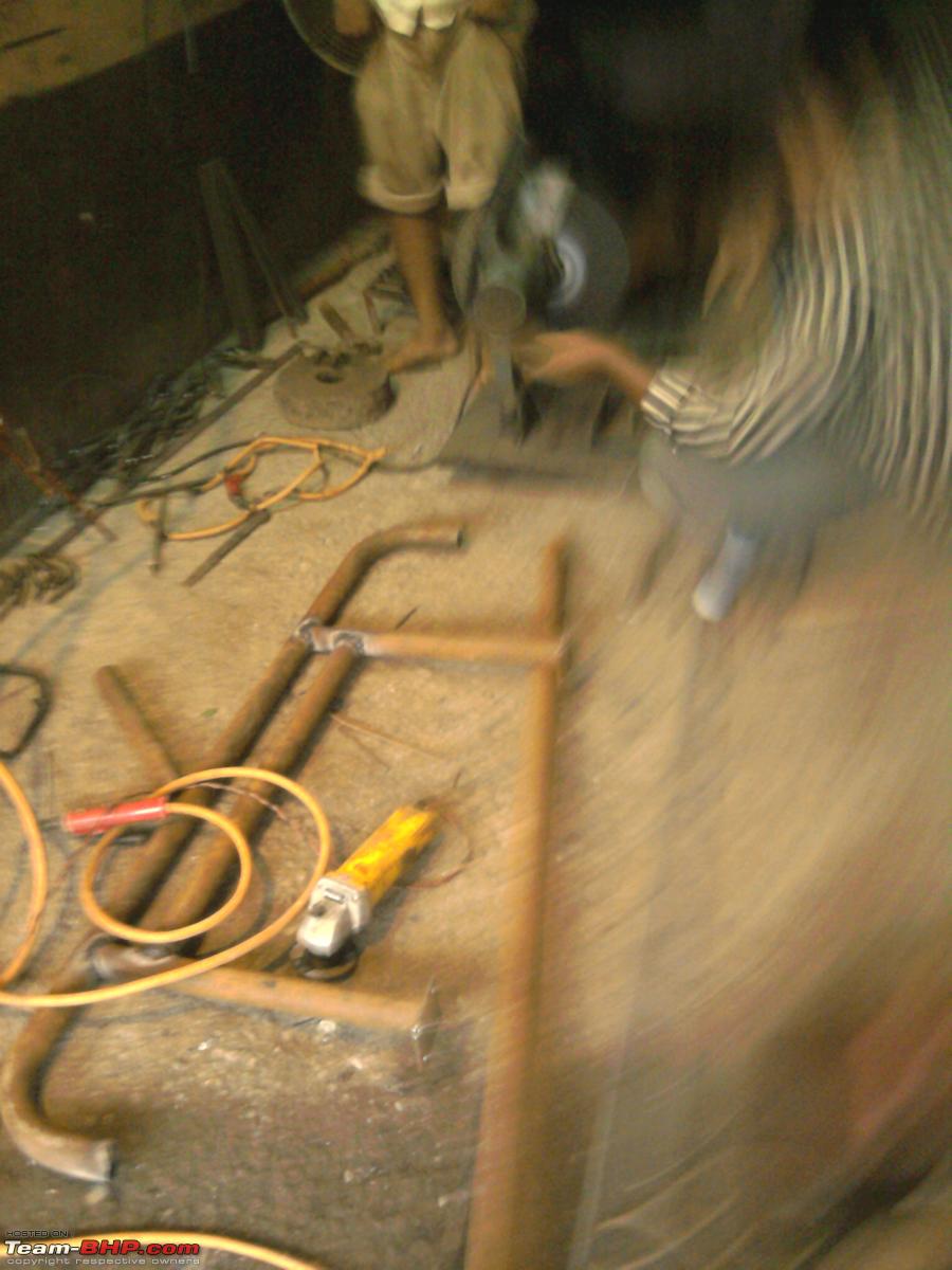

Just relaxing after completing 95% fabrication work of my Swing out Tyre carrier. Total time spend 9-10 hours daily for 4 days.
