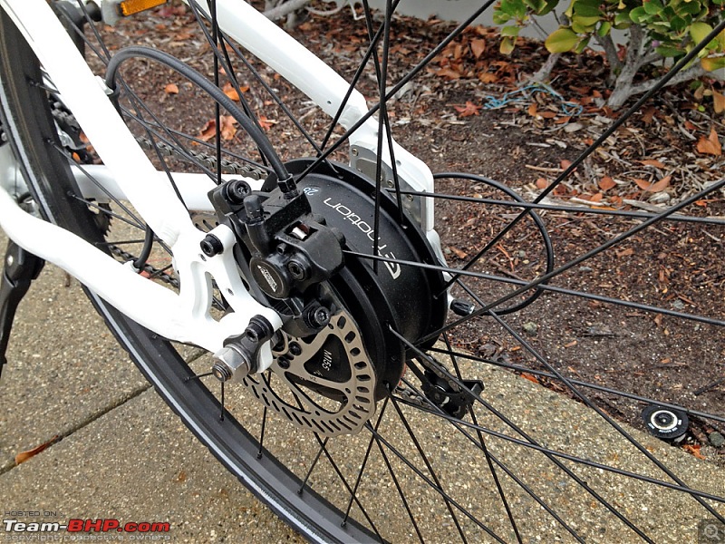

Hub Drive (Like my Spero E60)
The motor is integrated into the rear wheel, around the axle. You usually get the rim with the motor integrated, but if you know how to build wheels, you can go the DIY route.
E-Bikes (electric bicycle) : A comprehensive guide-gearedhubmotorebike.jpeg
(Credits: electricbikereview.com)
Advantages:
  1. It's a lot cheaper. If you want an e-bike under 70k, a hub motor is pretty much your only option, and you can get one for as low as 30k.
  2. It doesn't wear out the drivetrain. Since the extra power is supplied via the motor axles directly to the wheel, there is less wear and tear of the drivetrain involved. This becomes more important if you have high-end shifters and stuff installed.
  3. Since there's quite a bit of space within a rim, you can go insane. I'm talking 2-3KW motors. Of course, these are not street legal, but if you're into offroading and all, or a nutjob in general.

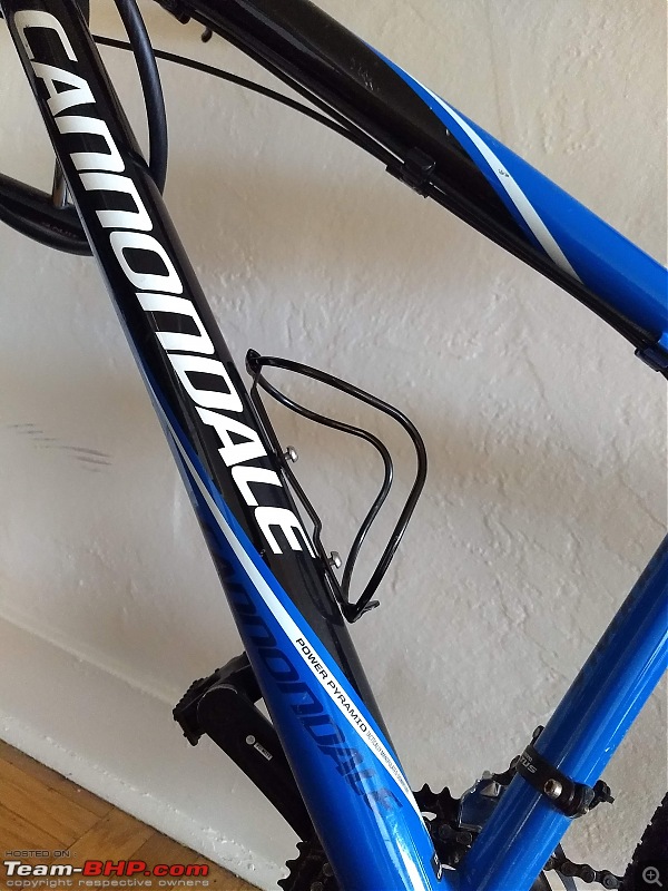

E-Bikes (electric bicycle) : A comprehensive guide-1.jpg
My donor e-bike, in all its muggle glory.

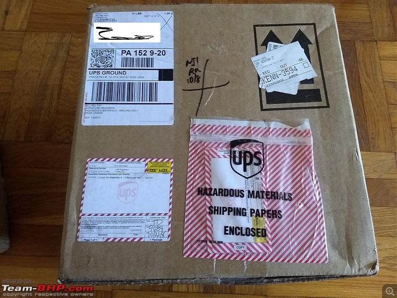

The boxes arrived after a painfully long week of ground courier. Can't ship batteries via air :)

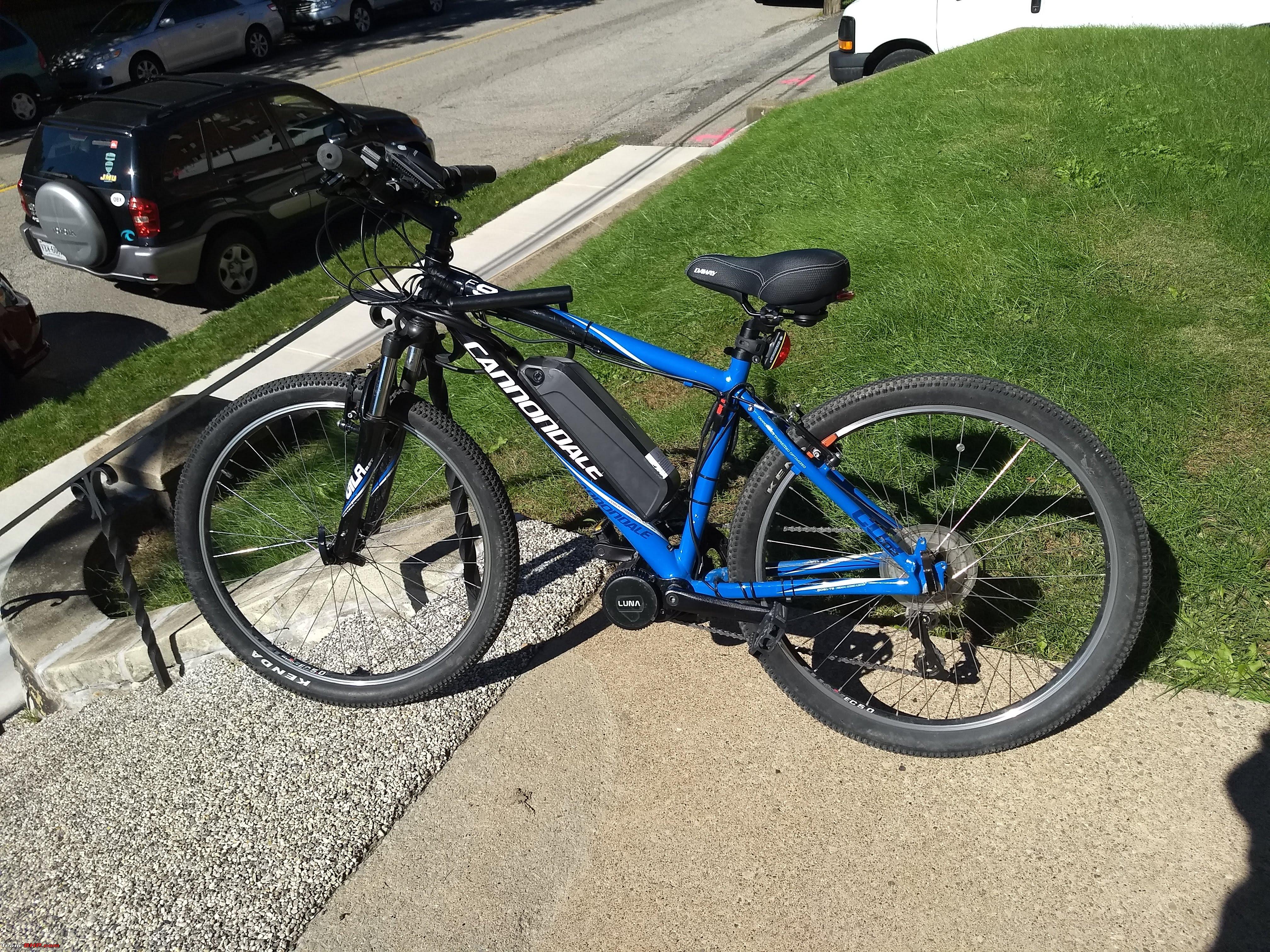

With the motor working, I went home and decided to attach the battery. It sits on the downtube where a bottle holder usually is. Removing the bottle holder.

Final pics!
E-Bikes (electric bicycle) : A comprehensive guide-final1.jpg
E-Bikes (electric bicycle) : A comprehensive guide-final2.jpg
How does it feel?
Absolutely amazing. With a 250W motor, you have to be a bit careful about how much wattage you're pumping through it on climbs. They can go upto 500W in bursts, which is helpful but risky to the motor's health if you do it on a sustained climb. This is anyway not a problem in most Indian cities, which tend to be flat.
There's absolutely no such problem here. This 750W mid drive will happily accelerate from 12 to 20 mph on a 10% incline. The first day I was grinning like an idiot going 20 mph on hills I had struggled to do 8 mph on, without breaking a sweat. I could not care less about where I was going - took the wrong turns and weird detours on the way home.
It has only become smoother with the addition of the extra sensors since then. There are some problems with the rear cassette and I might have to end up changing it, but nothing major.
With such a large chainring, I find myself needing only the first 3 (out of 8) gears to hit the 20 mph cap. Both the gearing and the motor have plenty of room to go further, if I decided to make firmware tweaks. These motors like to spin fast so it's a good idea to stick to lower gears as much as possible.
