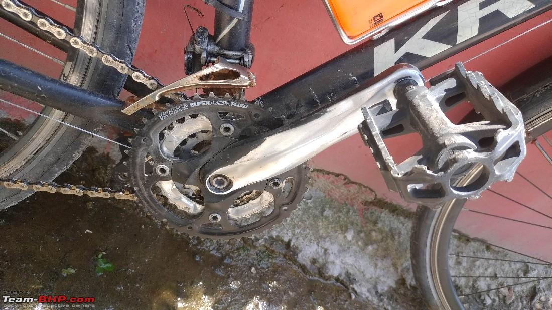

So today stopped by the scrapyard to scavenge some.parts, and layimg buried under an old desi roadster, discovered probably my best find yet (other than the full-suspension ACT 108Max):
The brand in my experience bears a well-earned association with (to be honest) fairly junky kid / youth cycles... But even before I could extract this one from beneath all the scrap material covering it, a glance told me we were dealing with something of an entirely different caliber.
So this is Kross's international "Trans Pacific" model, a full-on tourer that's fairly lightweight and quite nicely featured/equipped.

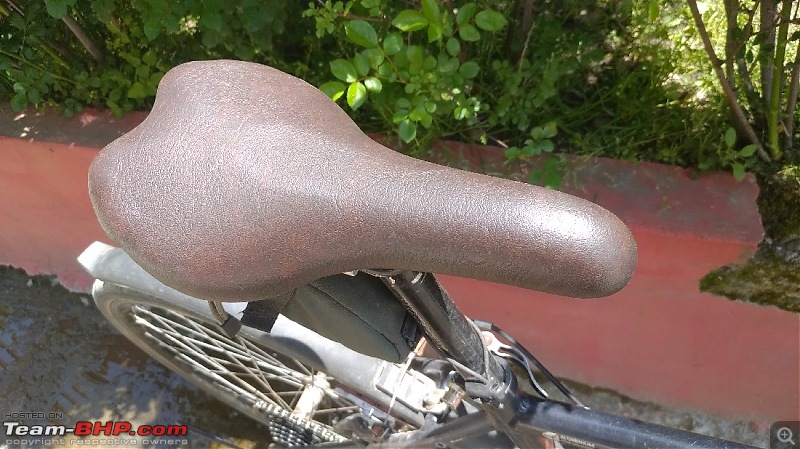

I think I'm gonna like this one. First cycle I've had with a powder-coated frame, which even after being tossed around and buried in the scrapyard has no significant scratches on the main frame tubes. First with concealed cables. First with a roadster-style backswept handle. It's got an adjustable neck that's longer and steeper than any I've seen. Light and close-fitting front múdguard, a Shimano generator-equipped front hub, and (the remnants of) head and tail lamps. Sturdy aluminium carrier is fitted as well. SR Suntour forks of reasonable sturdiness are there, and almost everything's aluminum.

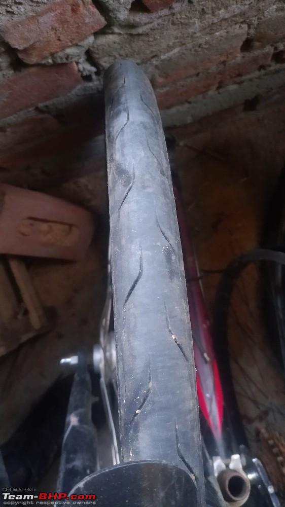

Tyres are Thailand manufacture 700Cx35 semi-slicks good for 90psi. Also has replaceable frame dropouts, which I'd never seen before but seems a good idea.
I had a spare seatpost and seat of appropriate size in the parts bin, and already installed them. Beyond that will need both derailleurs plus all the usual: cables, the handle straightened, brake pàds, and a good general CLA.

Saddle is B'Twin redone in a brown leatherette Rexine.

Second one here I rescued from the roadside just in time, five minutes later and it probably would have been gone. But came to me in terrible condition, with only one wheel (worn through and bent), and one totally gone full knobby tyre. Had second thoughts about it but am glad I went ahead and bothered.
Considering the massive amount of aluminum in the box-channel frame, the scrap guys didn't want to let it go too cheap - indeed, all other major components are aluminum too, and it's fairly light as full-suspension bikes go.
Unlike cheap desi models it's a linked suspension with a shock that actually has some damping - net result being that it rides very, very plush over the worst of surfaces. Came (oddly) with V-brakes but I converted to discs with Tektro calipers - easy as the mounts were already there.
Got it out in the mud / (downhill) wet stones today, also through the worst patches of broken pavement and potholes I could find, and found it to be good fun.
