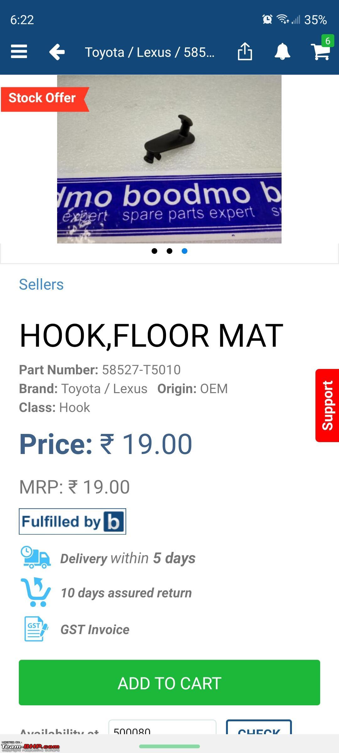

I have firsthand experience with this lamination. I have it on the entire floor of my safari. SInce I use it as a farm vehicle occasionally, it's a boon, cleaning is a breeze, BUT It's a smooth surface and footmats slide a lot on it. PLS PLS PLS buy velcro and stick it to your footmats and the floor. It will go a long way in keeping you out of trouble. Sliding mats can get stuck under pedals. Huge problem. Alternatively, you can buy some clips for footmats. Perhaps something like this,
The Damping Material and Sound Deadener Thread-screenshot_20210411182208_boodmo.jpg
