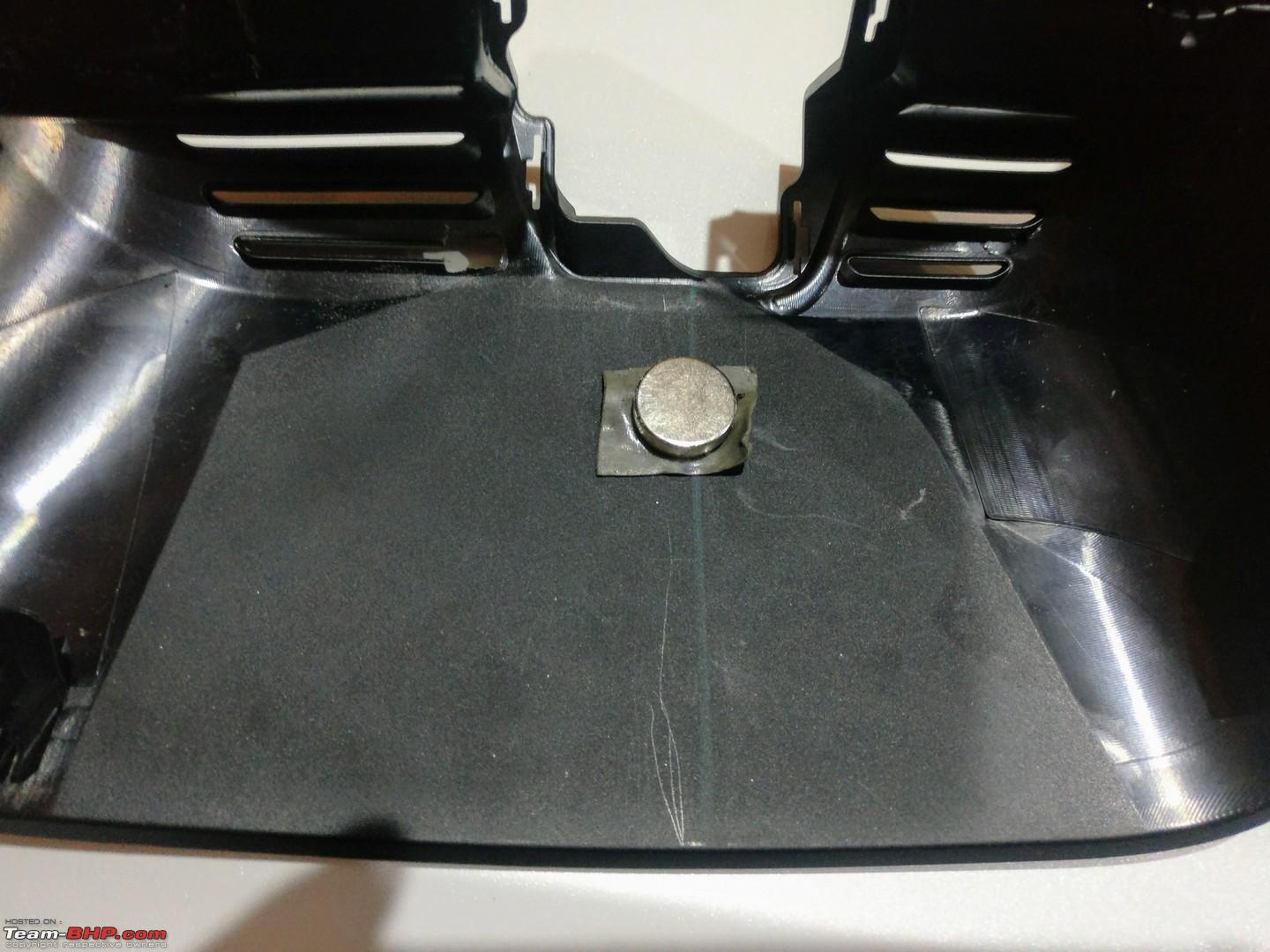

The Dashcam / Car Video Recorder (DVR) Thread-image09.jpg
Magnet on this inside of the housing.
