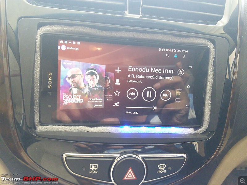

Hi Guys, This is what I have done to the XSP N1BT to have bigger phones fit into it.
Sony cradle turns Smartphone into an In-car Multimedia System-img20141219wa0002.jpg
What I did was, opened the head unit's faceplate and removed the top & the bottom clamp, and fixed the faceplate back., then fixed a T2 ultra back case with 3M double tape directly to the faceplate. Then fit the phone in there, so that I can place & remove the phone as needed. The border is now filled with heatlon foam as a temporary arrangement. will work on a making the borders perfect. I do not have any WIP pictures, as I did not have any plan as to what I am going to do. I just did it.
