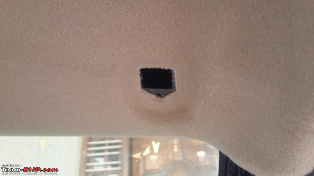

Loosened the screw securing the driver side Sun Visor and pulled out the visor. This huge hole was good enough for me to pass the microphone wire behind the roof line and route it through the A Pillar
Ertiga DIY: Installing a 2-DIN Stereo with Bluetooth-mic-routing-02.jpg

The Microphone wire was not stiff that I could easily push this through the smaller gaps at the back of the dashboard. Hence, used a Thicker & stiffer cable, passed it through the gap, attached the microphone wire with a temporary insulation tape and merely pulled the thick cable from below the dashboard to route the microphone wire as desired:
Ertiga DIY: Installing a 2-DIN Stereo with Bluetooth-mic-routing-04.jpg
Ertiga DIY: Installing a 2-DIN Stereo with Bluetooth-mic-routing-05.jpg
