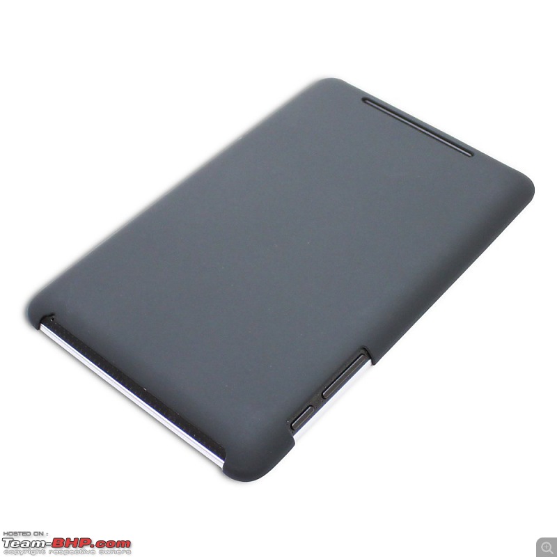

Tab Accessories
Wanted to get a protective case to prevent the tab from getting scratched and to absorb the vibration/shock from the vehicle. The choice: Fosmon Snap-On Case. Also got a pack of anti-glare screen protectors.
The snap-on case has chipped and cracked in a few places now. Might replace it with a silicone based cover soon.

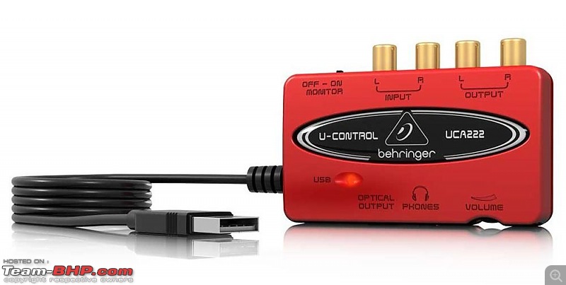

While the N7's built-in DAC is good, the temptation to add an external DAC became stronger after hearing lot of positive things about them. Based on the reviews, had zeroed in on Sabre DAC. Unfortunately, at the time of ordering, it was out of stock and I did not have the luxury to wait till it came back in stock, since my parents were returning home shortly. After another round of reviewing the rest, settled for Behringer UCA 222. It turned out to be a blessing in disguise, since this DAC had an additional stereo line-in as well as a dedicated optical output.
DIY: Tablet as an In-Car-Entertainment Console-behringer-uca-222.jpg

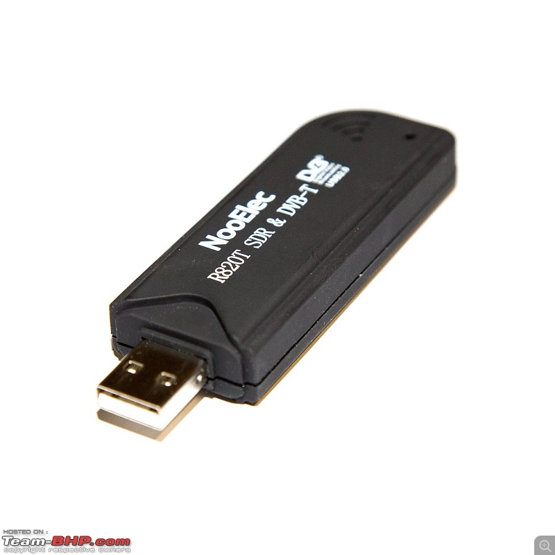

FM Radio
Now that the HU is going to be locked away in the glove-box and out of my reach, and mine being a pre-facelift Figo with no steering stalk controls, there was going to be no way I could switch between FM and other sources while driving. I had two options:
  1. Get a FM tuner hardware that could work with the tablet
  2. Assuming that my HU has support for a wired-remote, get the steering stalk controls alone fitted from FASS or design/fabricate one on my own
To play it safe, I went with a dedicated FM tuner. The key for these to work with android harware is the RTL2832U chipset. SDR touch was the only decent front-end in the play store and it needed this chipset for it to work.
DIY: Tablet as an In-Car-Entertainment Console-nooelec-dvbt-sdr.jpg
However for the records - we were able to design and build our own remote for the Head Unit later. Would like to reserve those details for a separate post/thread.

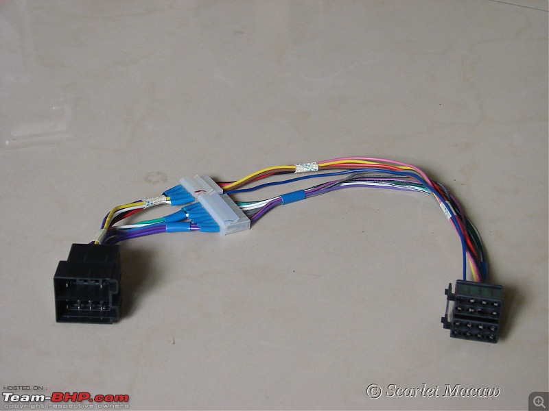

Head Unit Extension Cable for relocating it to the glove box
DIY: Tablet as an In-Car-Entertainment Console-head-unit-extension.jpg
Female End (sourced from Ritchie Street)
DIY: Tablet as an In-Car-Entertainment Console-hu-extension-female-end.jpg

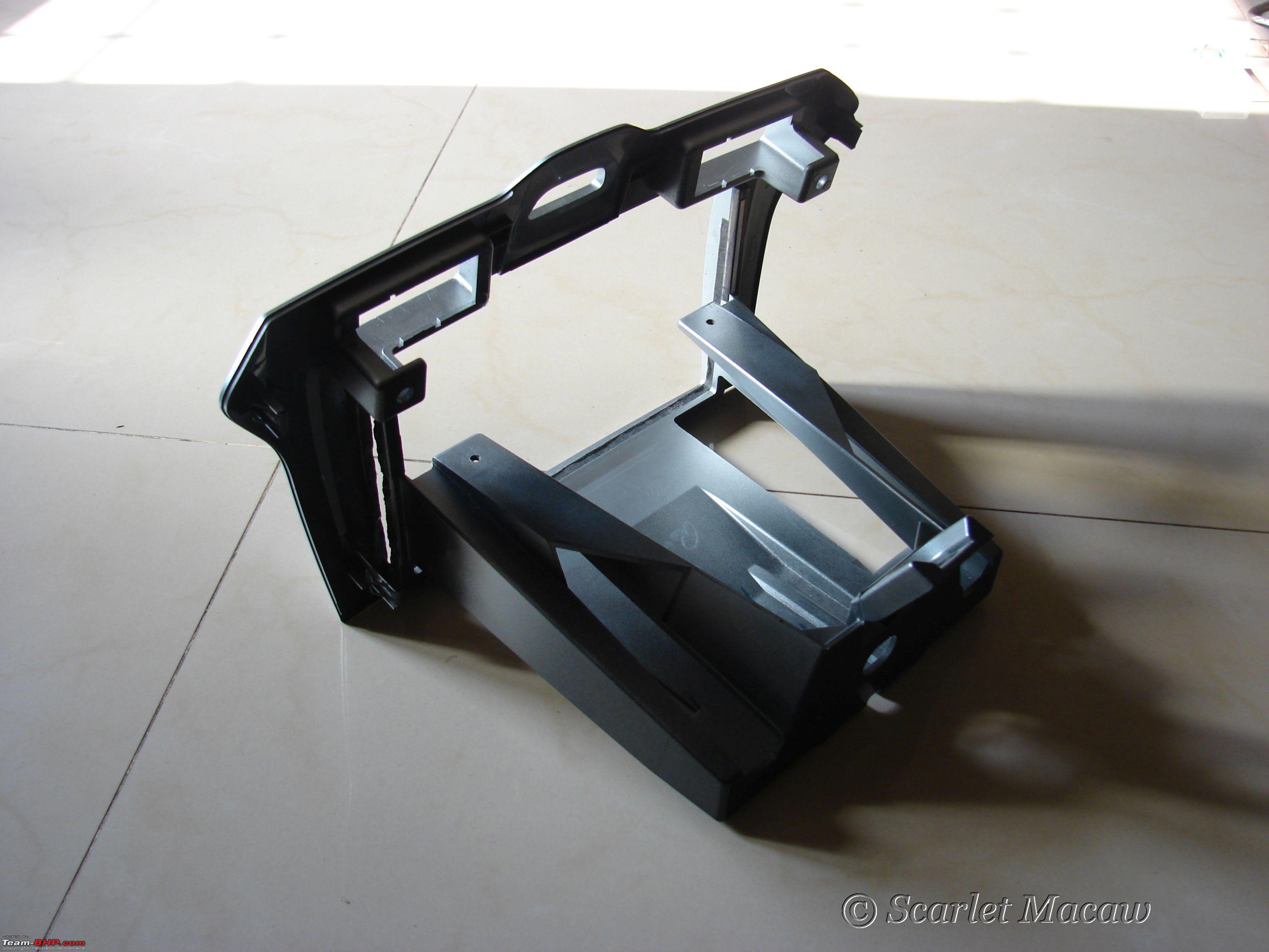

Console Frame Mod
Console Frame Modification
To accomodate the additional width of the tablet in the frame, the initial idea was to make a slit on the left lip of the frame, since that was closer to the glovebox, where the head-unit would eventually be placed. However, between the frame lip and the dashboard, there was very little space - too little to run up a cable comfortably. So the slit was made on the right lip. Also a cut was made as shown in the picture along the entire length of the lightning symbol, to provide some leeway for the tab to be inserted, without being forced. This cut detaches the right lip from the bottom lip and makes it movable backwards. This comes in handy when inserting and taking out the tablet.
DIY: Tablet as an In-Car-Entertainment Console-frame-right-lip.jpg
The frame after the mod:
DIY: Tablet as an In-Car-Entertainment Console-console-frame-after-mod-1.jpg

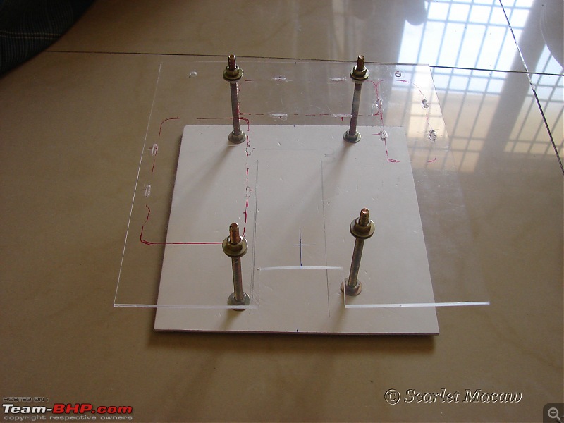

The Mount
The Mount
Next, we needed a structure where the components could be mounted and attached to the console frame. Taking cues from other projects, had initially decided to build a box-like structure using acrylic sheets. However, my dad came up with an ingenious idea of a simpler and effective design.
Rather than explaining it, will let the pictures do the talking:
DIY: Tablet as an In-Car-Entertainment Console-mount.jpg
DIY: Tablet as an In-Car-Entertainment Console-mount-2.jpg
DIY: Tablet as an In-Car-Entertainment Console-mount-3.jpg
The top sheet is acrylic and the bottom one a foam-board. Wanted the top one to be see-through - hence the choice. The four bolts serve the purpose of holding the two sheets together and maintain the right spacing between them. The red sketch marks indicate the positions onto which the DAC, usb hub and FM tuner would be fixed. The holes along the periphery of these sketch marks were made initially with the thought of using zip-ties for fixing the components onto the board. Later decided against it and used 3M dual-lock tapes.
Some pics of the mount attached to the frame:
DIY: Tablet as an In-Car-Entertainment Console-mount-frame-1.jpg
DIY: Tablet as an In-Car-Entertainment Console-mount-frame-2.jpg
DIY: Tablet as an In-Car-Entertainment Console-mount-frame-3.jpg
DIY: Tablet as an In-Car-Entertainment Console-mount-frame-4.jpg
DIY: Tablet as an In-Car-Entertainment Console-mount-frame-5.jpg
The mount with the components affixed:
DIY: Tablet as an In-Car-Entertainment Console-mount-components-1.jpg
DIY: Tablet as an In-Car-Entertainment Console-mount-components-2.jpg
DIY: Tablet as an In-Car-Entertainment Console-mount-components-3.jpg
DIY: Tablet as an In-Car-Entertainment Console-mount-components-4.jpg
DIY: Tablet as an In-Car-Entertainment Console-mount-components-5.jpg
DIY: Tablet as an In-Car-Entertainment Console-mount-components-6.jpg
DIY: Tablet as an In-Car-Entertainment Console-mount-components-7.jpg
DIY: Tablet as an In-Car-Entertainment Console-mount-components-8.jpg
DIY: Tablet as an In-Car-Entertainment Console-mount-components-9.jpg
DIY: Tablet as an In-Car-Entertainment Console-mount-components-10.jpg
DIY: Tablet as an In-Car-Entertainment Console-mount-components-11.jpg
