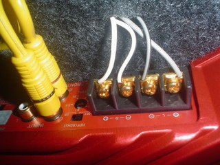

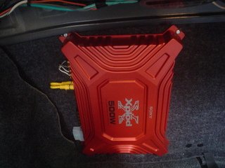

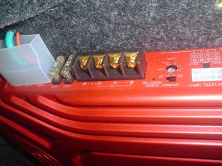

sony 504z..a brand new one as the other stuffs were shifted from old car...THe pics..
THe rear speakers
THe ts-20`s
HU
Sony 504z
Now i have queries regardin the connections...as the installers out here really S*** at electronic knowledge...So would want to verify if the connections are fine.....they have run a single RCA cable to the front channel of the amp...and have connected the ts-20`s nd the rear speakers in parallel..Have no idea why they did that...told them to connect the tweeters to the head unit....but they said that it would sound better if connected to the amp......the connections are shown in the pic...the rear channel is free..so are the connections fine??... plannin to fix front speakers too...thats next on the agenda ..
thinkin of installing the front speakers by myself....inspired by vivek you see:)...OF COURSE WIT HELP FROM TEAM-BHP....so guys do i have to run another RCA cable in order to connect the front speakers..nd also do i have to run wires too for the fronts???.have SUB in mind too...but in the next stage...
Get the 427, get another RCA. Power all speakers frm amp.
Presently they can run the TS from teh HU as you wanted and feed the rear frm amp.
my recomendations.
a) space the 2090 out as far as possible
b) rotate one 2090 180 deg. I'd consider the left one in the pic above
c) dump the TS20 or if you want to use pad it down about 6db
d) Get the 427 asap.
e) if you dump the TS20 then run all 4 speakers of the amp if you dont dump the TS20 pad it down 6db or so (10 ohms in series) mount iit in the rear and run it in parallel with the rear speakers. since the TS20 effective (post padding) impedace will be 14 ohms of which 10 ohms is purely resisteve it will not load the amp even if it is in parallel with the rear speakers.

Well sir... i cant move the rear speakers away from each other as a hole cannot be cut due to some design prob of the seats....if thats what you meant by space out...Will def rotate the them by 180 deg......nd the 10ohm shud be connected in series to the posivte line right???withstupid
and the 427`s wil be in within few weeks....Wel there`s a pair of lightning audio 4'' fronts for 2.4k.....with 35 watts rms...any reviews bout that??
I know I was suggesting a new MDF deck! the 10ohm/5W or 10ohms/10W resistor is in series with the +ve leg.
