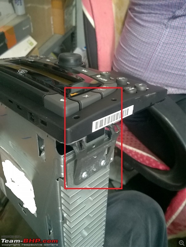

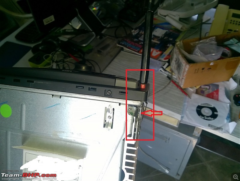

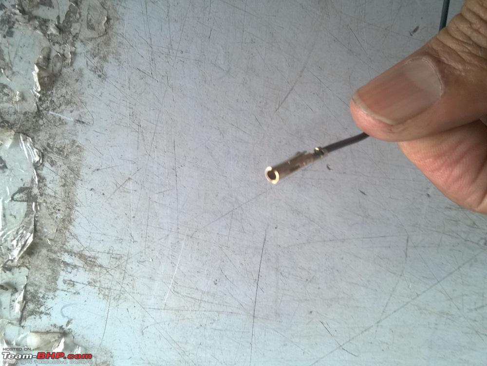

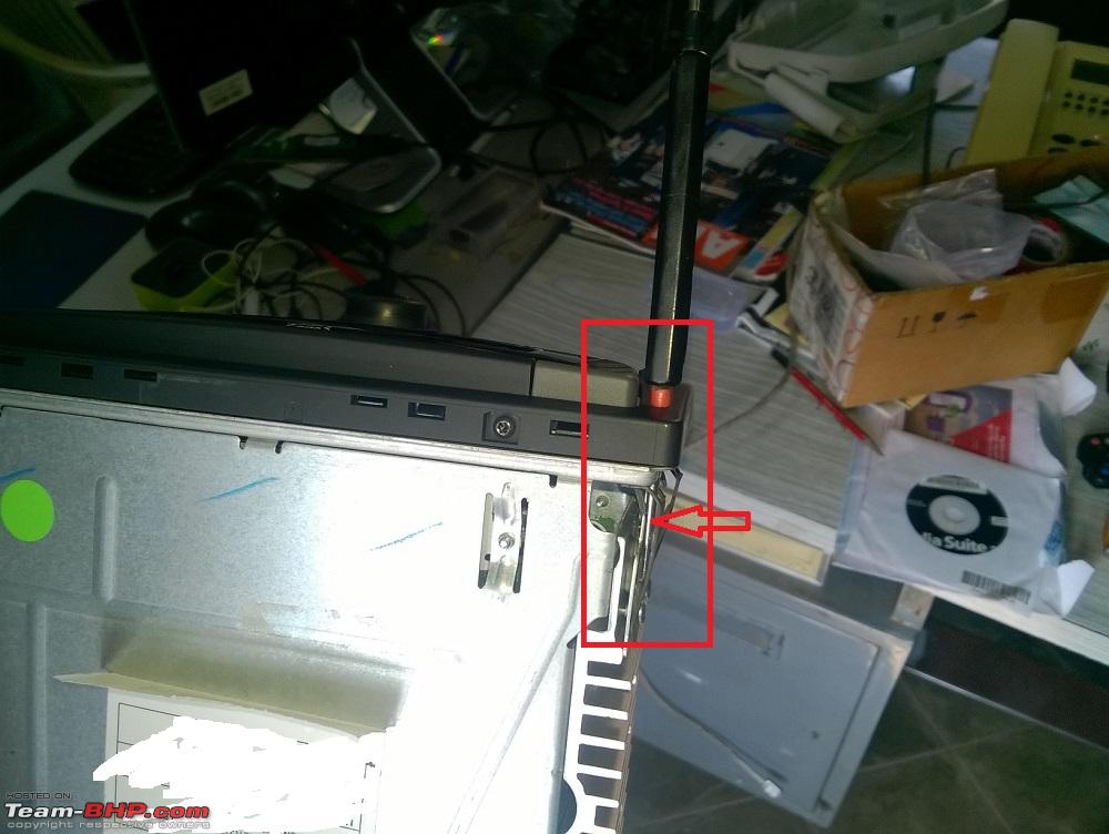

Originally Posted by Mr.Boss View Post
Just for everyone's information. Figo HU is made by Visteon Automotive Systems, India.
Just an update about the socket type for USB connectivity.. The pins (on the audio )are NOT rectangular now, So the sockets have to be circular to grip it. Posting the photos for everyone's reference.
Thanks Mr.Boss and my USB is working fine.
To remove the unit, push the U clamp to an "inch" inside and not too deep. Handle carefully or U clamp may scratch the plastics.
DIY: Adding a USB port to the Ford Figo-wp_20160410_007.jpg
