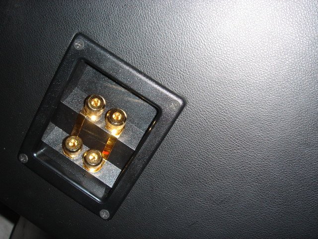

Also i just wanted to state that I havent been talking to a regular carpenter for the enclosure. Its a guy who builds speaker pods, planks, enclosures for the car accessory walla's... basically the source. So they have some experience with the buildling... I just need to make sure I get the required finished product. If I go with this custom option I plan on procuring quality connection terminals and pop them in the box instead of the local wire terminals these boys use.
Those terminals are too fancy. You can get good ones from MX for far far cheaper. The one in the pic is a bi-wire cup, you need just two terminals (the sub is a SVC, right?). More money saved, credit to damping account.
Your right, thata bi-wireable binding post terminal. Pic was to just give an idea of the terminal.... Of course If I were to buy it would be for a single sub application... would cost me 400 bux. Please provide a link or some info regarding the MX connectors you mentioned ??

Originally Posted by s0uljah
terminal.... would cost me 400 bux. Please provide a link or some info regarding the MX connectors you mentioned ??
The MX would cost about 55 bucks but would be nowhere near the quality of the AZcomp.
I suspect the builders use the MX connectors or something in that range. Since im getting a custom box I though I could use the money I save to invest in the terminals. It will be money well spent I reckon.
In Bangalore I don't know. In Bombay, Lamington Road zindabad. Maybe some place in Bangy where people go to buy electronics spares/ hardware? Sam said the quality is not comparable to whatever.. the thing is that it's well built compared to some really crummy connectors you get out there, and that's all you need to spend on a terminal cup for a system like this. It is robust and will last long. AND if anyone tells me that there will be a difference in sound quality in the MX and something else upwards of it, for the system in concern, I'll surely give up audio. After some proof accorded by a blind test, of course.
