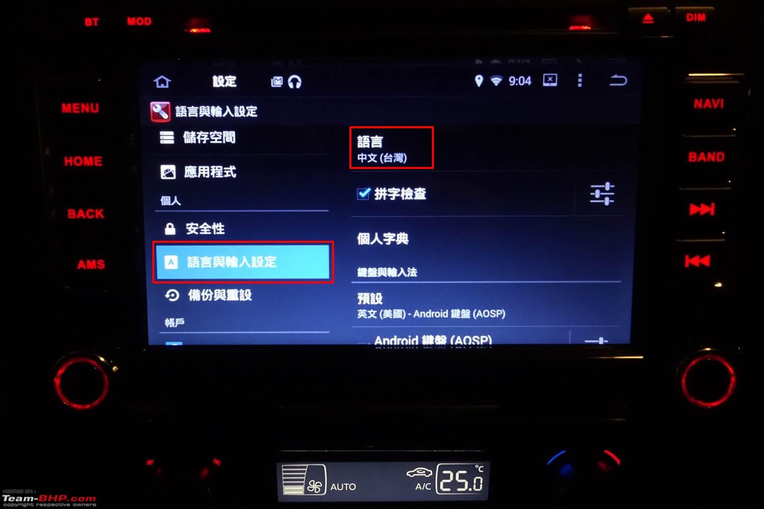

  2. While trying to solve problem #1, I did a factory reset, and the language changed to Chinese. Took some effort to find the right setting to change this back to English.

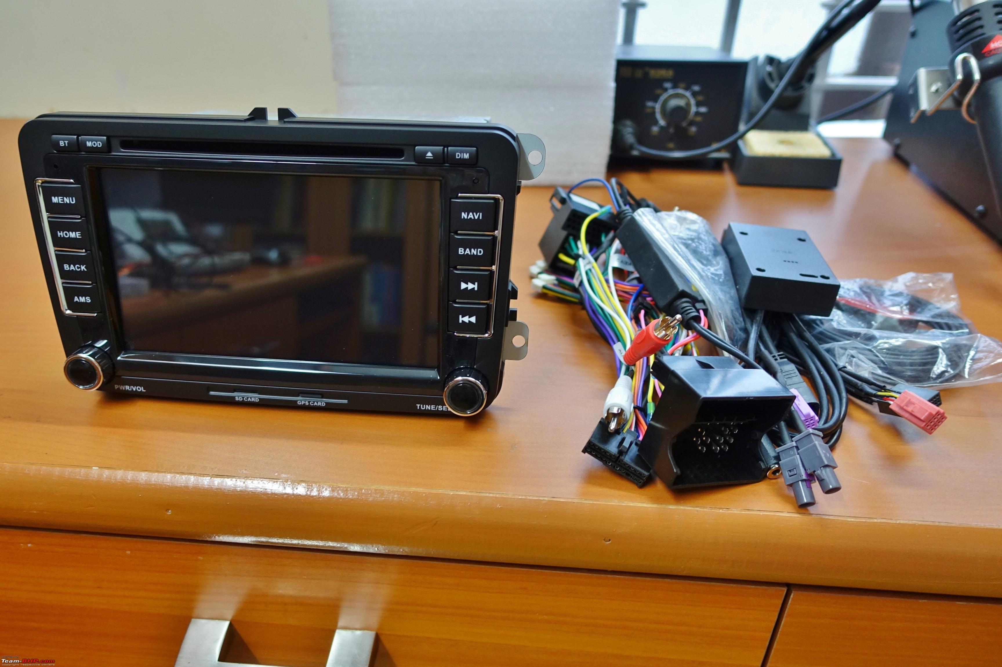

Everything unpacked. There is a plethora of cables that accompanies the system.
The front - I could not find a way to take this picture without the reflection!
The back – I have marked the connectors of interest

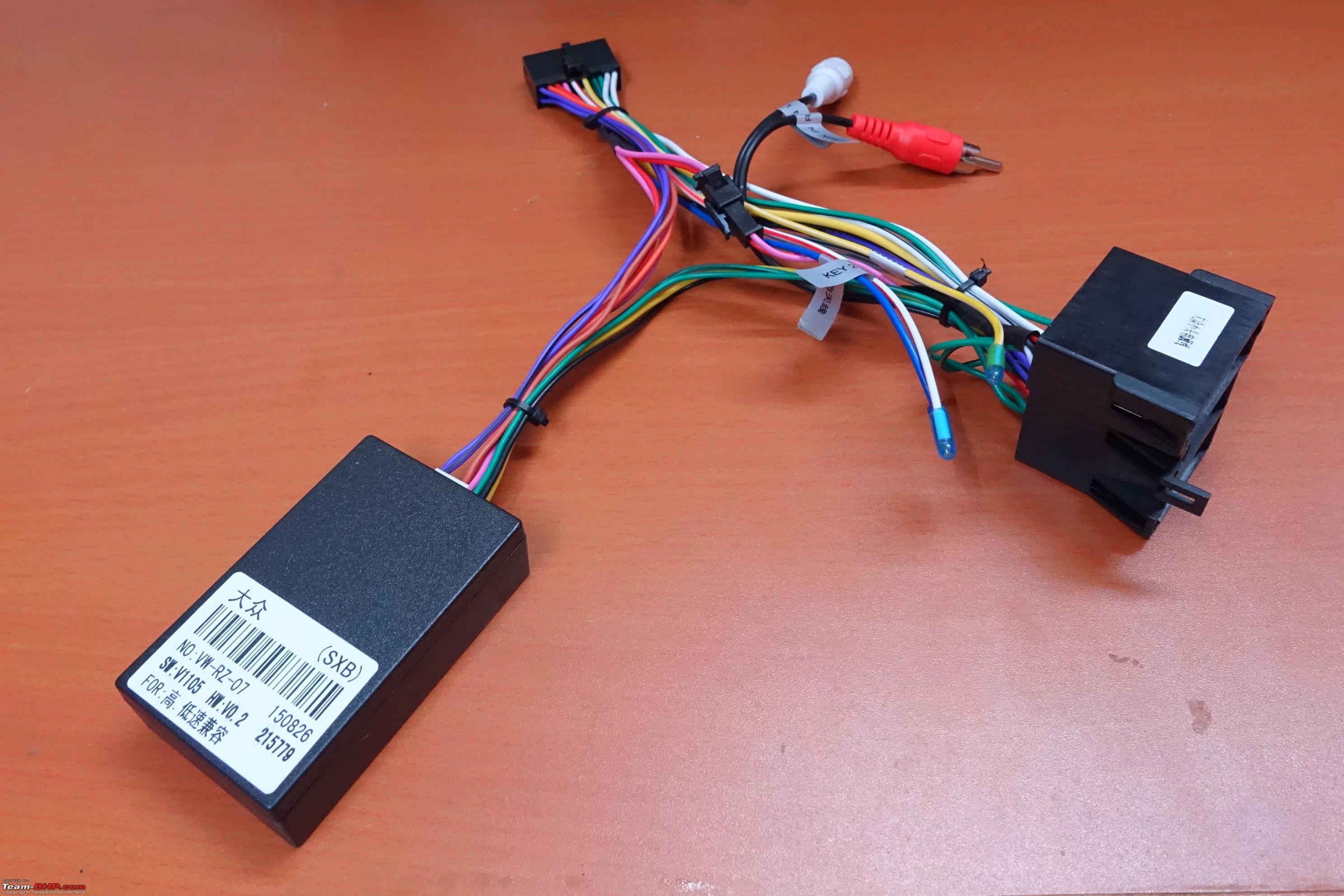

CAN Bus controller – This CAN bus controller integrates steering wheel controls and also vehicle status information.
Following are the cables of interest – Main cable, that connects to the two ISO connectors in the car’s original cable that has the power supply, CAN bus and speaker connections, radio antenna adaptor that connects to the single Fakra connector in the car’s cable, mic cable and the GPS antenna cable. A note about the radio cable. The radio cable as two Fakra connectors. For RCD320 that has a single Fakra connector, one of the two connectors can be used.

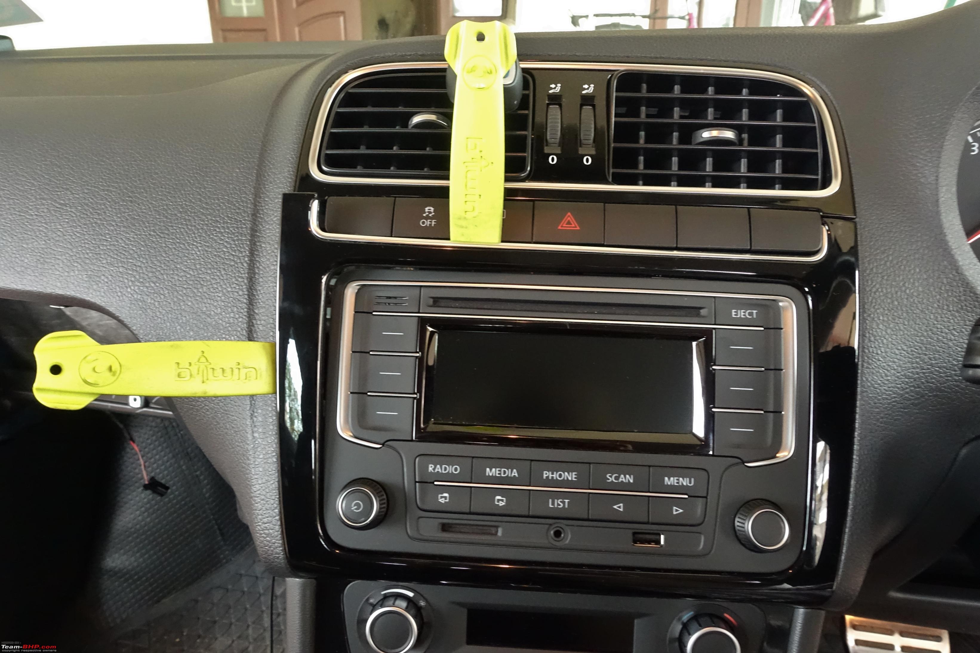

Remove the trim around the HU. I used tyre levers from my bicycle maintenance kit for this.
Next remove the four torx screws (marked with the red boxes).
Pull out the RCD320. The back side of the RCD 320 is quite basic. There is one radio antenna connector and two ISO connectors. Unplug these connectors and take out the RCD320.

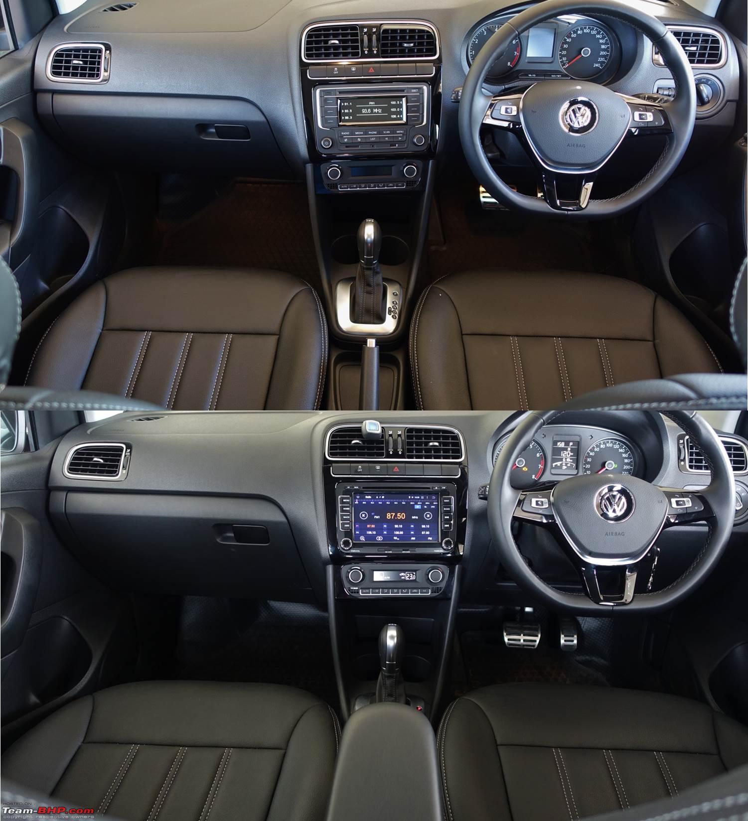

Here are a couple of before and after photos.

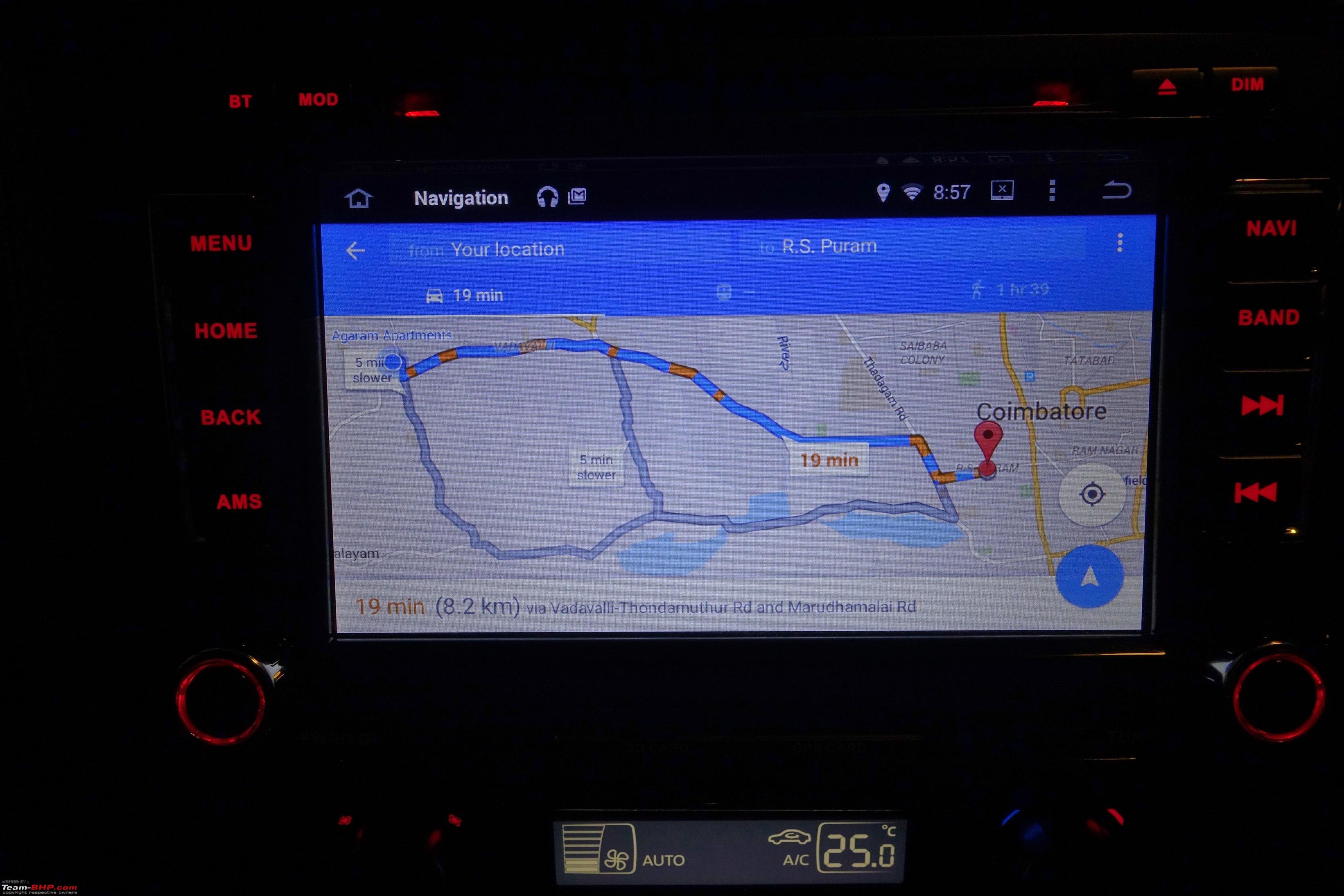

#3. Yes. For navigation, there is Google maps. When I received the unit, the stock firmware did not have Google maps - it had iGo navigation. Then the vendor sent me a firmware upgrade and in this upgrade, Google maps was installed by default. Google maps works awesome on the HU. I will post details in my next update.

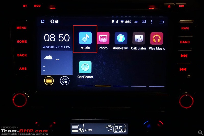

Music Player
The icon marked in the below picture is the default music player.
However, this music player is from stone age. The only thing you can browse with this system is the album. You select the album and it starts playing from the first song in the album. It does not even allow to select a particular song from the album.

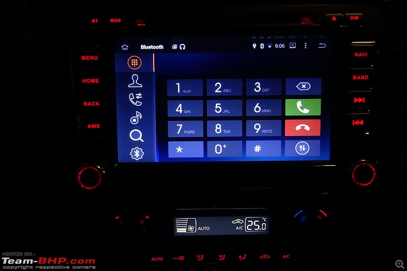

Bluetooth Telephone
Pairing your cell phone to the HU is regular android process. I am not going into details here. Pair the cell phone using the Settings screen. Once the cell phone is paired, press the BT button, and the Bluetooth telephony screen shows up.
Dial pad. You can dial any number from this screen.

Navigation
The HU with the stock firmware came with iGo as default navigation app, and Google Maps was not loaded. After I upgraded the firmware, iGo was not there, but Google Maps was there instead. All you need to do is configure your 3G cellphone as a Wifi hotspot and connect the HU to the phone, and you can use Google Maps as you would use it on your phone. The voice instructions from the app also plays on the HU speakers (any music fades out during this time) and it is very good. A couple of screens from navigation.

Recovering from Chinese language selection:
While researching for a solution to the "Google server error" problem, I found in some android forums instructions to do a factory reset to solve the problem. And I did a factory reset. After boot up, to my horror, saw the language change to Chinese. After about 10 minutes of trial and error, and comparing the Settings page layout on my android phone, found the right settings to revert back to English. Thought of providing this information here for the benefit of users who may face the same situation.
The Chinese home screen!
In the settings menu, select the marked parameters.
Note: I did not take photos when I faced this problem. Just to document the issue, I set the language back to Chinese (did not want to do a factory reset just to take photos) and repeated the process. There is a possibility that I selected the wrong Chinese version (Mandarin vs. Cantonese) for the photos and you may see different fonts after factory reset. But still, you can get this right by following the "A" in a box icon, and the first parameter in this menu.
