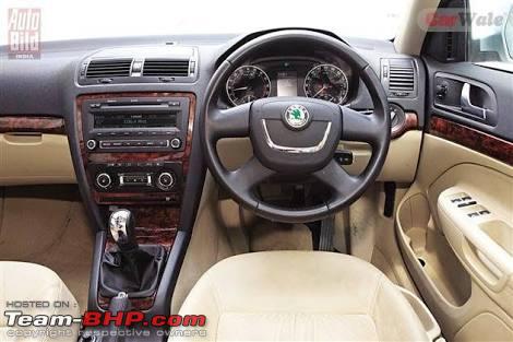

Hi, just had a doubt regarding fitting the RCD330 and 340. Didn't your Superb had a wooden panel? Is there any way to retain that and retrofit the HU? It currently has a Swing system.
I am planning to upgrade it on my Laura Elegance, which has a faux-wood panel, similar to the Superb and a black or silver insert might look out of place.
Also attaching a picture for your reference. Any leads would be very helpful.

Originally Posted by Akshitsi View Post
Hi, just had a doubt regarding fitting the RCD330 and 340. Didn't your Superb had a wooden HU? It currently has a Swing system.....
Attachment 1789037
Hi,
The Superb has the HU with integrated piano black facia. Hence, I had to get the trim to install the RCD330. Finding a faux wood trim to support RCD330 would be difficult. The silver trim Link is easily available.
