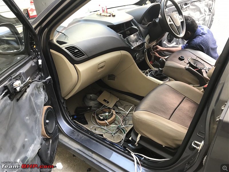

This is a fantastic thread. was very helpful in upgrading my Fluidic Verna OE HU to Sony XAV AX 5000. Till now I was using the OE HU along with Focal Auditor components in the front, hertz Co-axial in the rear door and JBL 1200W sub all driven by Blaupunkt EMA 455 600W 4 Ch amp.
Inputs Provided by @drhoneycake was helpful and sourcing the harness and the mounting frame. A local installer did a fantastic job in sourcing the harness, which even retained the OE USB port.
Damped front two doors with DrArtex iridium 2.0mm butyl sheets. Front components and sub is being driven by the amp. Rear door speakers are connected directly by the HU. Sound Quality is superb.DIY: Upgrading the Hyundai Verna's Head-Unit (Sony XAV-AX5000)-img_0606.jpg
DIY: Upgrading the Hyundai Verna's Head-Unit (Sony XAV-AX5000)-img_0616.jpg
DIY: Upgrading the Hyundai Verna's Head-Unit (Sony XAV-AX5000)-img_0618.jpg
DIY: Upgrading the Hyundai Verna's Head-Unit (Sony XAV-AX5000)-img_0619.jpg
DIY: Upgrading the Hyundai Verna's Head-Unit (Sony XAV-AX5000)-img_0600.jpg
DIY: Upgrading the Hyundai Verna's Head-Unit (Sony XAV-AX5000)-img_0622.jpg
DIY: Upgrading the Hyundai Verna's Head-Unit (Sony XAV-AX5000)-img_0625.jpg
DIY: Upgrading the Hyundai Verna's Head-Unit (Sony XAV-AX5000)-img_0677.jpg
DIY: Upgrading the Hyundai Verna's Head-Unit (Sony XAV-AX5000)-img_0678.jpg
Local Installer (Chennai) Mr Deva (+919003199324) performed a clean installation.
(he can install the setup at your doorstep)
Some pics attached herewith for ref.
