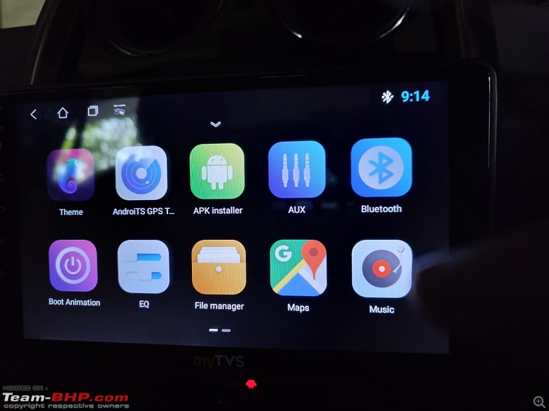

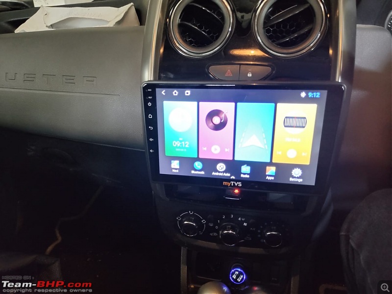

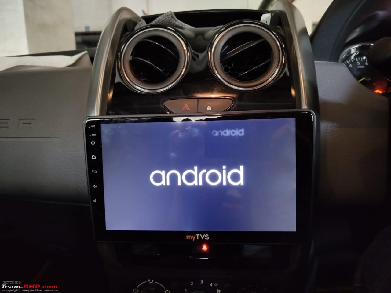

I've a 2017 Duster, and I was looking for an android head unit for some time, finally took a plunge.
Got MyTVS 2GB/16GB version, wanted to go for a higher version but had couple of observations and finally decided to go for a lower unit.
It is a 9" screen, with Duster original frame being 7", it does sit outside a bit, but doesn't look bad as many stock units also have a "floating" approach now a days.
Checked lot of systems, most of them were a bit laggy (not the 4GB/64GB ones though) to start with.
Initial application load was always a bit slow. When the car is idle, it would not make a difference but if you want to open maps while driving, it does seem slow.
Same goes with the few music apps I tried.

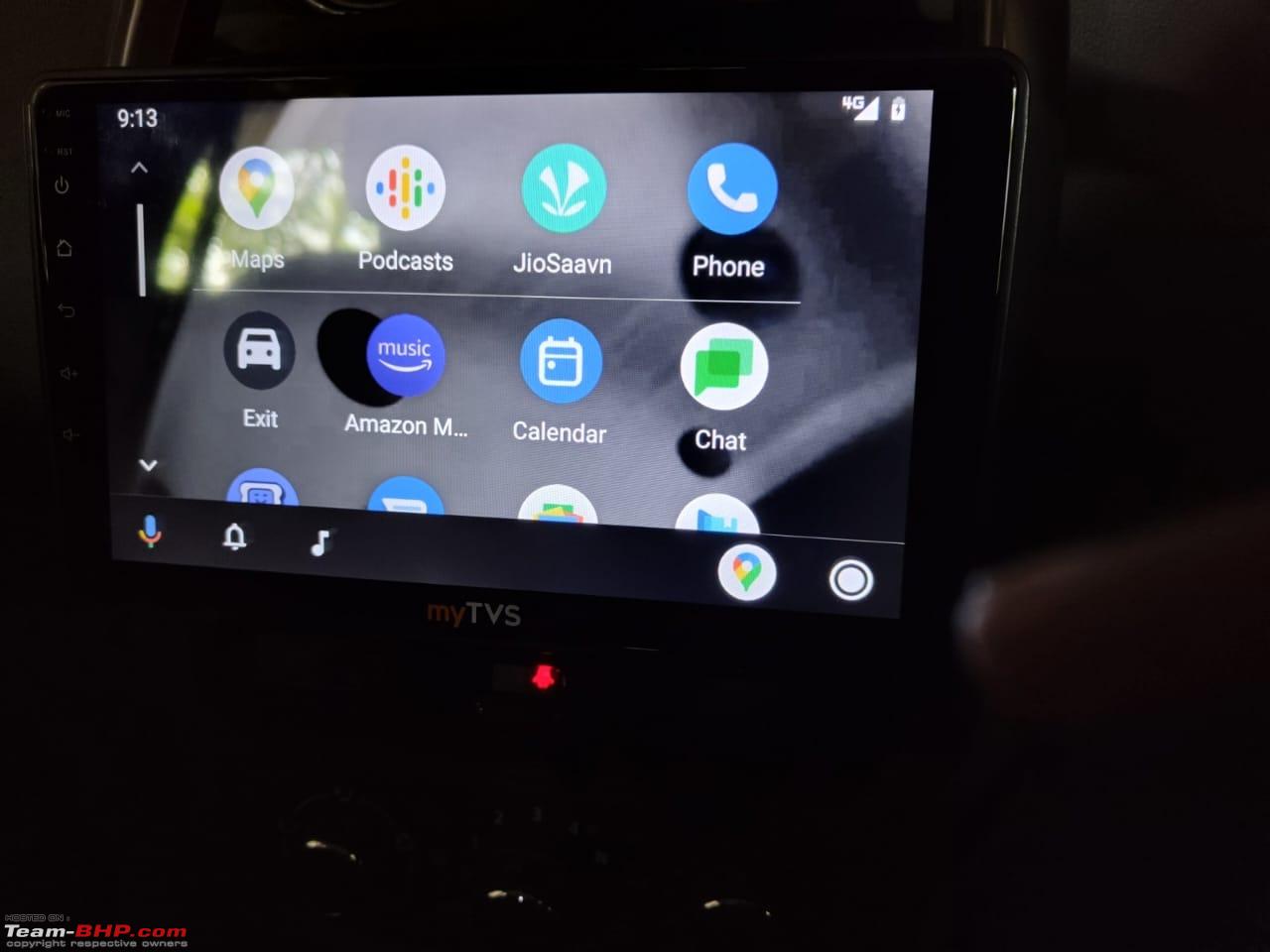

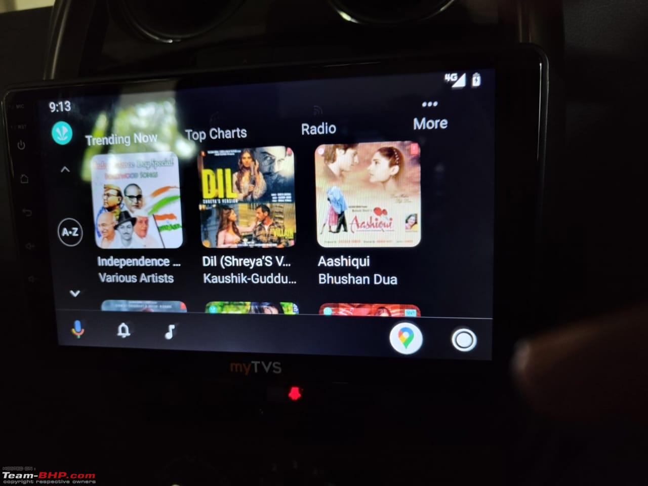

An alternative to that is Android Auto enabled systems. Although it might not make sense to limit the functionality by using Android Auto, when one can use a full fledged android experience, but there were few points to consider:
- Android auto UI extremely easy to use
- Absolutely no lag (even with my 2GB system)
- No need to connect wifi etc
- No need to install additional apps on the head unit
- SMS/whatsapp/messages etc work natively (reading out messages aloud if needed)
- My primary use case if of maps/music/podcast, this is fully addressed by Android auto
The unit I bought did not have android auto enabled by default, I installed an app called "Headunit reloaded", after that wired android auto connection was seamless.
Here are few of the points regarding overall installation:
- It took around 2-2.5 hours to install the whole thing.
- No wires were cut, and overall installation was neatly done.
- Additional GPS unit was added, and USB input was moved to the glove compartment.
- I had an aftermarket reverse camera (and sensor setup), this was not compatible with the unit. Camera was replaced (sensors still do not work, and need to be changed)
- Vendor mentioned that CANBUS would be needed for duster to get steering controls to work, got it installed. Most of the buttons work but Prev/Next behaviour is erratic
I've been using the unit for a week now. Maps/Music/Podcast is through Android auto (which as I mentioned earlier is seamless and a breeze to use).
If I want to view YouTube/video, then I use to apps installed on the Headunit. These apps, once loaded, work as expected and I not faced any issues so far.
One of my friends got MyTVS 2GB/32GB version, and that has Android auto (and Carplay I think) in build.
That unit also allows Android auto connection, the price difference is not much as well.
Overall I'm happy with the purchase, I would have been disappointed with the performance if not for Android auto. I'll be visiting the vendor to sort out Prev/Next and reverse issue.
