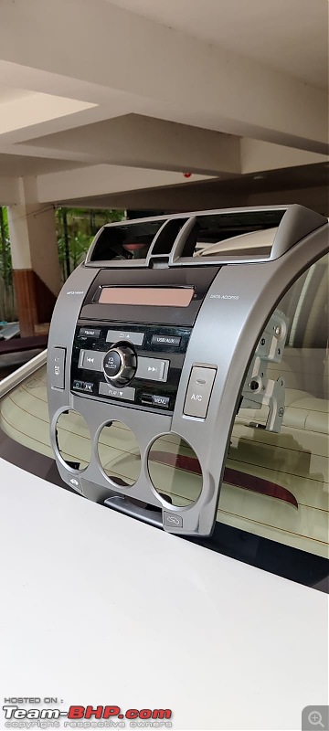

Posting a detailed install and initial impressions here
Model: Woodman Xtreme 3.0 4GB/64Gb
Price: 35k (after negotiation with sales guy)
Installation: 1050/- Done at home
Celebrating freedom from outdated stereos
Background
I drive a 2012 model pre-owned ANHC. I got it from an individualy seller in pristine condition at 35k kms in 2016. I was really analysing how long I am going to keep this car given it's 2022 and all the developments that have taken place. I recently went in for a tire upsize (Continental UC6 195/60/R15). Post which I have been really enjoying zooming down the highways of AP. I thought - at 87k kms the car feels sprightly. There are no issues and these tyres have solved GC issues and imbued new light and comfort in the car. All that's missing is an updated 'smart' music system.
Thus began the research: After going through 4-5 days of TBHP, understanding basics of android HU and youtube videos, I decided to go in for the Woodman. Conceptually I knew what I was going for, and although would have loved to go for Alpine or some such established one, it could have resulted in compatibility issues (not sure) and too much high cost at HU level itself.
The Purchase
I wrote an email to woodman's support id and a sales guy reached out. We whatsapped for 3-4 days where he sent multiple videos, answered arbitrary questions about screen resolution, service, compatibility, etc. Finally analysed multiple things about how long to keep the car, transferability, etc and took the plunge. Bargained with him to reduce the price as much as possible.
Delivery came in 3 days after ordering - 13th August. I wanted to get the install done on Sunday, but Vijayawada most of the showroom workforce is off on Sundays, as I discovered. The Woodman people recommended an installer and I called him. He sent the installer home on 15th August morning.
The guy did it beautifully in a very unhurried manner. Took 1.5 hours. Took good measurements to install reverse camera and left the car and panels looking as is, after he was done. Really impressed with the methodical approach to the install. He said in the last month he had installed 20 odd woodman systems in VJA itself and that seems to be the most preferred online brand. Other than that local brands are there which people can go for based on their budget he mentioned. Now whether it's genuinely the case, or he said it just to reduce potential buyer's remorse, I don't know.
Initial Impressions
Good responsiveness. Easy to link accounts and setup. Reverse camera, steering controls, radio, works perfectly based on a brief drive I did. GPS is accurate. Bluetooth pairing is a breeze. SQ sounded maybe 10% better on streamed songs, but I need to do a detailed listening to see if it improved due to so called DSP or it was more or less same from before. Need to still check android auto, mirroring and sim related features.
Another thing- While it is snappy, I'd say the overall interface is quite basic. 720p screen after being used to 1080p or higher on most other screens definitely noticeable, but the default big size of the UI makes it easy to navigate. I still need to play around with various settings and tweak and maybe even explore other launcher options. Looking forward to a renewed car ownership experience thanks to updated ICE
Like I posted in the advice section as well, I'm planning a step by step upgrade and thanks to Michelin star recommendations from a Guru, thinking I'll drive down to Chennai and go to Speedfreaks after setting up an appointment to ensure timely delivery.
Some pictures:

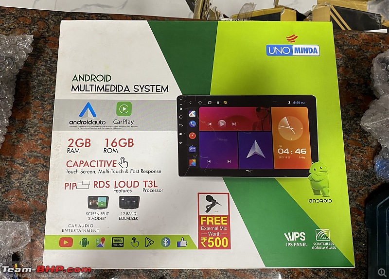

I've a 2017 Duster, and I was looking for an android head unit for some time, finally took a plunge.
Got MyTVS 2GB/16GB version, wanted to go for a higher version but had couple of observations and finally decided to go for a lower unit.
It is a 9" screen, with Duster original frame being 7", it does sit outside a bit, but doesn't look bad as many stock units also have a "floating" approach now a days.
Checked lot of systems, most of them were a bit laggy (not the 4GB/64GB ones though) to start with.
Initial application load was always a bit slow. When the car is idle, it would not make a difference but if you want to open maps while driving, it does seem slow.
Same goes with the few music apps I tried.
An alternative to that is Android Auto enabled systems. Although it might not make sense to limit the functionality by using Android Auto, when one can use a full fledged android experience, but there were few points to consider:
- Android auto UI extremely easy to use
- Absolutely no lag (even with my 2GB system)
- No need to connect wifi etc
- No need to install additional apps on the head unit
- SMS/whatsapp/messages etc work natively (reading out messages aloud if needed)
- My primary use case if of maps/music/podcast, this is fully addressed by Android auto
The unit I bought did not have android auto enabled by default, I installed an app called "Headunit reloaded", after that wired android auto connection was seamless.
Here are few of the points regarding overall installation:
- It took around 2-2.5 hours to install the whole thing.
- No wires were cut, and overall installation was neatly done.
- Additional GPS unit was added, and USB input was moved to the glove compartment.
- I had an aftermarket reverse camera (and sensor setup), this was not compatible with the unit. Camera was replaced (sensors still do not work, and need to be changed)
- Vendor mentioned that CANBUS would be needed for duster to get steering controls to work, got it installed. Most of the buttons work but Prev/Next behaviour is erratic
I've been using the unit for a week now. Maps/Music/Podcast is through Android auto (which as I mentioned earlier is seamless and a breeze to use).
If I want to view YouTube/video, then I use to apps installed on the Headunit. These apps, once loaded, work as expected and I not faced any issues so far.
One of my friends got MyTVS 2GB/32GB version, and that has Android auto (and Carplay I think) in build.
That unit also allows Android auto connection, the price difference is not much as well.
Overall I'm happy with the purchase, I would have been disappointed with the performance if not for Android auto. I'll be visiting the vendor to sort out Prev/Next and reverse issue.
Some snaps...

I changed the touch screen head unit of my Honda City with a UNO-Minda Android system. Total cost inclusive of fitting was Rs 20,500. Surprised that the Honda Unit lasted this long; it was weakest point of the whole car. This Android comes with wireless Apple Car Play and Android Auto, convenient. I retained the speakers as they're decent, will upgrade later if required. Kindly ignore the spelling mistake on the box

I changed the touch screen head unit of my Honda City with a UNO-Minda Android system...
Thanks for the update. I am in a dilemma to go for Android or the Sony/ Pioneer units. I have a 2015 Honda City- V MT. would greatly appreciate some more details please.
1. Did you changed the default mic (in case of V or VX variant) and OR the reverse camera. I understood that in some cases people went for another mic. I really want to keep the default mic as well as reverse camera as is and make them work somehow.
2. Call receiving and rejecting buttons on the steering - Are they working with the unit? I see that some of the units are not able to make them work.
3. Sound quality - how is the audio quality. I have read that the sound quality of these android units is not that great. Any comments on it.
4. Any specialized harness required for the installation or the system comes with everything required?
Would greatly appreciate your remarks on these points. The price you got it for seems VFM. I am really interested on something like these and even the fitments looks quite good here.
