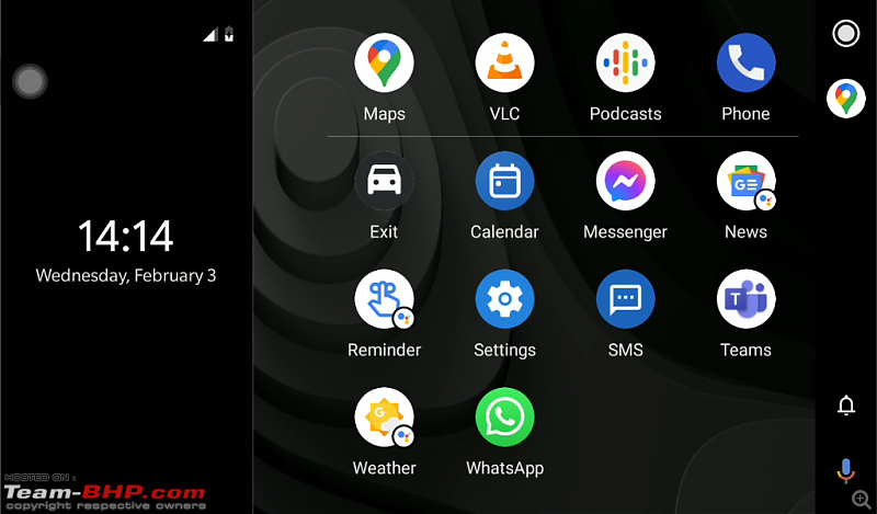

Some workarounds for a better experience
Problem 1: The default screen share app on most android HUs just mirrors the phone's screen onto the HU's display and the inputs have to be done on the phone rather than the HU's screen.
Problem 2: The hardware of the HU is not optimized to give snappy performance of apps like google maps.
Workaround for 1 & 2: Enable android auto interface on the HU which is not there by default.
  • Install an emulator called Headunit Reloaded from the play store on your head unit. Available for free also through some third party websites.
    There is a thread on XDAdevelopers which discusses the installation and functionality on offer by this emulator.
  • Android Auto is pre installed in your phone (which is taken care of by the OS by default in most cases). The app will be hidden in some phones, for which you can download this app from the play store.
  • Connect the phone to the HU via a supported data transfer USB cable and you are now live with Android Auto on your HU.
Problem 3: In some phone models, the telephony is done via the phone's mic and speaker by default even when triggering a call or receiving it via the android auto screen on the HU.
Workaround for 3:
To use telephony functionality via the car mic and speakers, you need to install this patch from the play store. This brings up the hidden android auto settings in the settings menu from where you can toggle the bluetooth setting and some other features.

... and, after android auto.
Advantages:
  • Near seamless functionality
  • Uses the phone's processing capabilities and is much faster
  • Ease of setting-up - just plug in via the cable and you're off
  • HU's screen becomes the only input / output device while the phone is left aside
  • Sophisticated UI compared to the cheap pre-installed one
