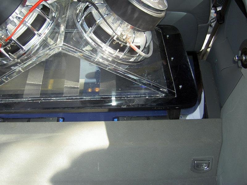

Why... Why !!!
I was staying away from this for so long..
But I guess the cat is out of the bag now...
The HU is Clarion HX-D2
For the Highs using Kicx Pro X2 series Tweeters
Kicx Pro 5 inch Midrange
Kicx Pro 6 inch Mid Bass drivers
Ample Audio 1000 watts RMS 10 inch subs.. Handcrafted in USA
Soundstream Tarantula 4 Channel Amp.. Handcrafted in USA
Ample EXONIC 400 Special Edition 1000 rms x 2 amp for the subs...
Audio Plus Cabling..
RCA SNR 700 OCC
Speaker Cables.. 8502 10 gauge
Bach Cable for Sub woofers
Complete Dynamat Extreme and Sonic Dampers behind every speaker..
1 Gauge battery wire to the distribution block and 4 guage thru a Gold plated Distribution Block to the other components ..
2 Ample Caps 2 Farad each
Subs as can been seen are mounted in a 18mm custom made polycarbonate box...
I guess thats about it!!
Dont remember if i have missed out on anything
Cheerssss

Pardon the noobie question here, but I never understood the concept of aiming the woofers into an enclosure. Wouldn't that be bad for sound? What's the logic behind a setup like that?
Rtech is offline
Old 14th March 2007, 16:21   #13
EVO6's Avatar
Join Date: Apr 2005
Posts: 488
Thanked: 13 Times
The box volume specified for this speaker is so small that you can't fit them the regular way and hence they have been fitted the other way around.. All u need to do is change the phase of the speakers in the electronic crossover and it works the same...
