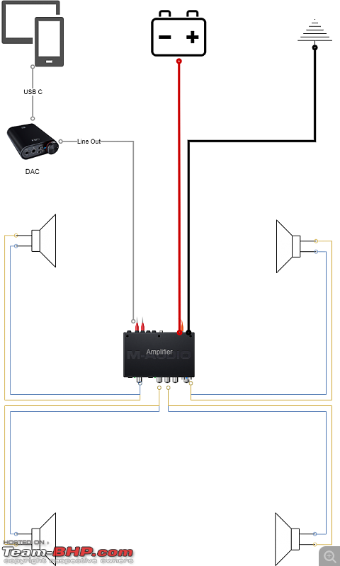

So what am I proposing? I have a rough sketch, which I need this wonderful community to validate and add flesh and bones to:
  • Pick a non 'ICE loaded' car. While not getting into 'What Car' territory, Hyundai Creta 'E' and XUV300 'W' variants come with no touchscreen, no speakers even, but with a top-of-the-line engine option. Splendid by me :-). The Korean sisters are top-of-the-league at bombarding consumers with features of questionable utility, but I have to give credit where its due. They push out so many options that you're likely to catch the bait with one variant or the other. Anyway, if you are looking to buy a car, pick one with a minimalistic ICE setup. If you are looking to upgrade your ICE setup, read on.
  • BYOD - Bring Your Own Device: all occupants these days carry their own devices, their own music, and uniformly bad sound quality. What if we give them a USB (-C preferably) cable to extract the digitized audio, bye-passing the onboard DACs.
  • A reasonable DAC: Feed USB-C to something like Fiio K3 which decodes upto 384kHz/32 bit samples into a line-out. Don't like wires? Throw in a tablet serving a hotspot and hi-res songs. Chromecast Audio is a super cheap and sweet DAC in that case.
  • Feed the line out to a 4-channel setup.
What does this buy us? No Head-Unit required. No signal hopping from smartphones into a head-unit only to muddy the sound further. I am at my liberty to evolve the setup, based on what sounds nice to me and my budget, rather than live with what bean-cutters decide as my taste in audio - after polishing off with my bank account.
Alas, working off base variants forces you to negotiate with safety essentials, a sad part of the automotive scene till the 'bling' aspect of the safety technology gives way to some standardization and regulation. You should not have to make this compromise, but there you go.
Back to our setup. Looks something like this.
Do I really need a 'smart' head-unit...or a head-unit at all?-audiowiring.png
Questions:
  • Is this bonkers? Please tell me if swimming against the tide is a loosing idea or if this is unworkable or if factory warranties are in jeopardy or whatever.
  • Turning a car, specially if new, into a permanent rattletrap for the sake of custom ICE is for me, like everybody else, a big concern. Any suggestions for trustworthy installers in south Bangalore?
  • What amplifier and speakers assuming a 40-50k budget? I am not looking for the thump. And I suppose dealers can retrofit sail panels from higher variant spares if we choose to add tweeters?
  • Is a DAC like Fiio K3 which has no independent power source sufficient here? We are not going to use its headphone amp stage, so driving just the DAC with smartphones may not be a problem is my guess. Are there alternatives?
  • I assume we can use the DAC to control sound volume?
  • I see most 4 channel car amps have 4 line-in inputs, while a stereo line-out from DAC will provide 2. Do car amps have a 'stereo input mode'?
  • How do you wire the amp for the 'turn-on' signal in this case? A fuse box wire-tap or a 12V signal from a power bank maybe?

No this is not bonkers and has been discussed at length here
https://www.team-bhp.com/forum/car-e...will-work.html (Crazy Idea - Direct connection to Amp (no Head-Unit) - Will it work?!?)
Yes, but most component speakers come with tweeter mounting pods which do a decent job. if you want a stealth install - then using the OE panels would be the better option
The fiio K3 has 1.9V pre outs which should be acceptable (ideally 4V are better for lower SNR, but you'll need something like a line driver which we will come to in a bit
Yes
Usually no, but an RCA Y splitter is a cheap and effective hack.
Hook it up to the ignition voltage. That should do
In general, People give up on the idea because they lose steering wheel controls, front/back adjustment, and most of the money you save on ditching the HU ends up spent on an entry level amp which makes the tradeoff not worth the inconvenience for most.
