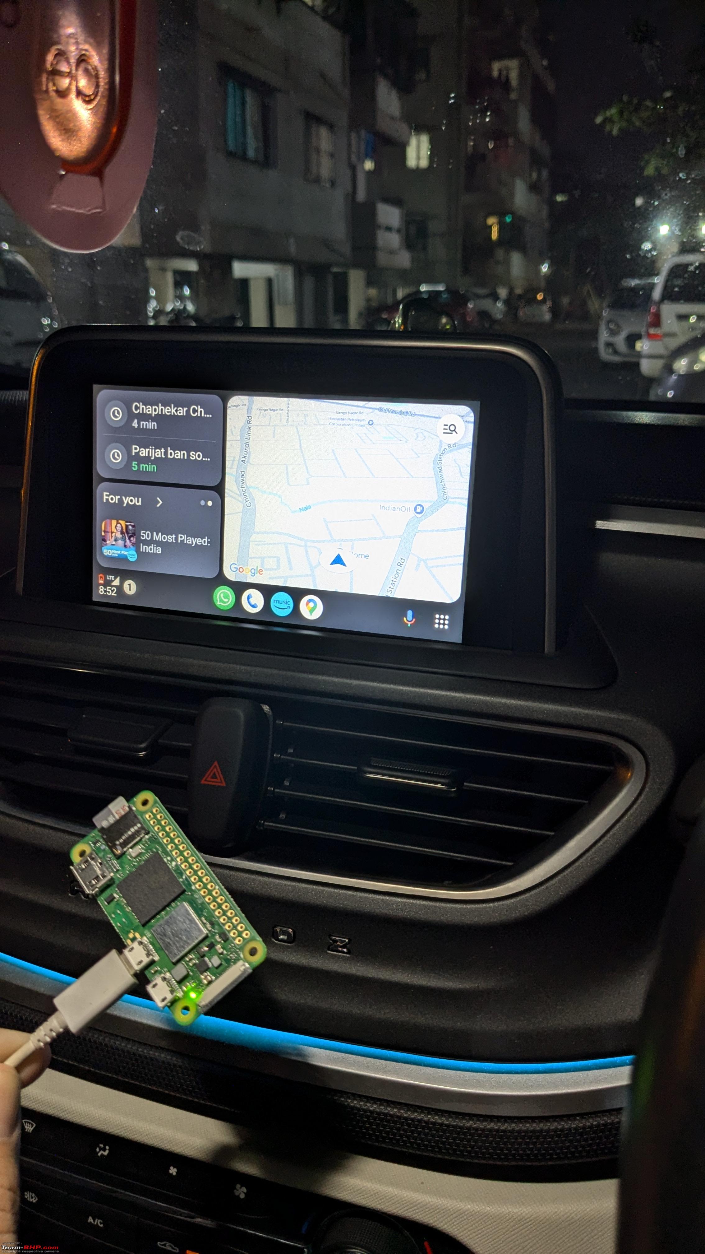

Firstly many many thanks for this post
Been trying to buy a Motorola Wireless AA adapter from acquaintances in the US for sometime now.
This post has provided a solution in INR 1600 which is amazing..
I have a 2022 Altroz i-Turbo & reading in the trailing posts that this worked on a Tata PUNCH I went ahead with trying it.
The steps are spot-on as mentioned. So followed them to the T.
Had a bad Cable when I tried to connect to first time. Replacing the cable solved the problem.
Observations:
Yes, as mentioned in the post it takes about a minute to connect once the car's instrument cluster is powered on.
I noticed, its actually a bit fast in responding than the wired connection. Will keep observing if thats really the thing.
Question: The Raspberry Pi has a very tiny LED that stays powered on. Would it really contribute in draining the Car battery if I forget disconnecting it while exiting the car. The size of the LED really looks harmless.
No this shouldnt be a problem as Tata's infotainment system disconnects supplying power to USB after 30 secs of car lock. I have checked it in my Nexon EV and this is how it happen there.. And the moment we unlock the car, the power gets supplied to Raspberry Pi and by the time we turn on the car, the connection is already established between mobile+HU through AA
Though I am still trying hard to find a logger which can print the power consumption of Raspberry pi so that I can study if my presumptions are indeed correct!
