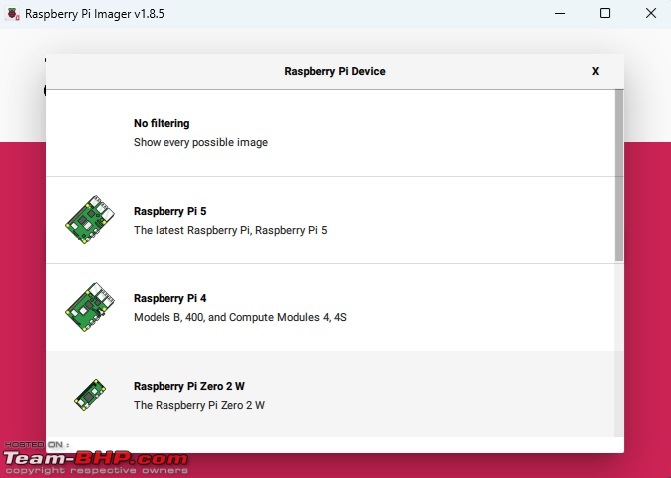

4. Select Device, for me it was Raspberry PI Zero 2 W.
Use Rpi Zero as a cheaper alternative for Wireless Android Auto | Cost under 2,000 rupees-piimager1.jpg

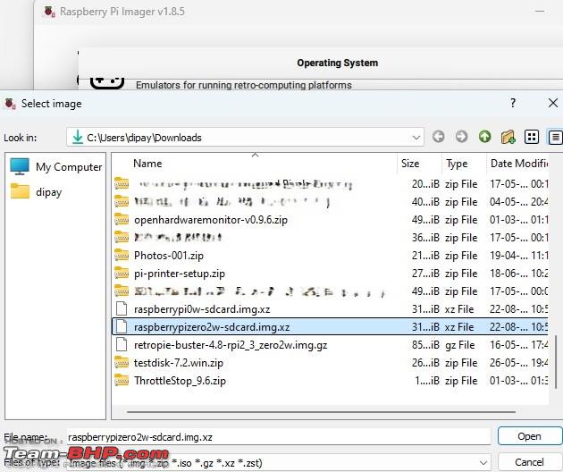

5. Then in "Choose OS" select custom, browse the image you downloaded and open
Use Rpi Zero as a cheaper alternative for Wireless Android Auto | Cost under 2,000 rupees-piimager2.jpg
Use Rpi Zero as a cheaper alternative for Wireless Android Auto | Cost under 2,000 rupees-piimager3.jpg

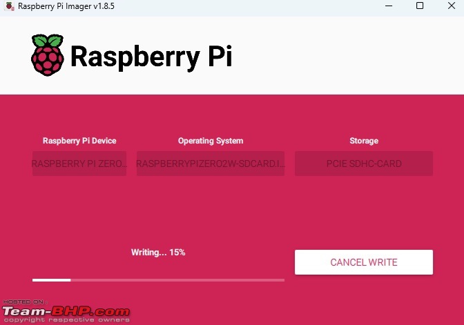

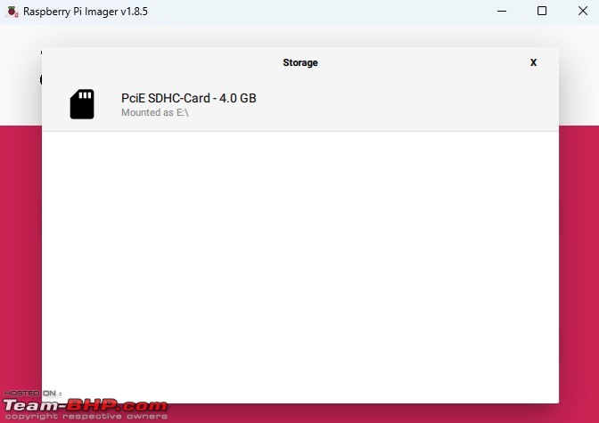

6. Inset the SD card in your PC/Mac and then click on "Choose Storage" and select the SD card. Make sure you are selecting correct one if there are multiple connected to your laptop/PC.
Use Rpi Zero as a cheaper alternative for Wireless Android Auto | Cost under 2,000 rupees-piimager4.jpg

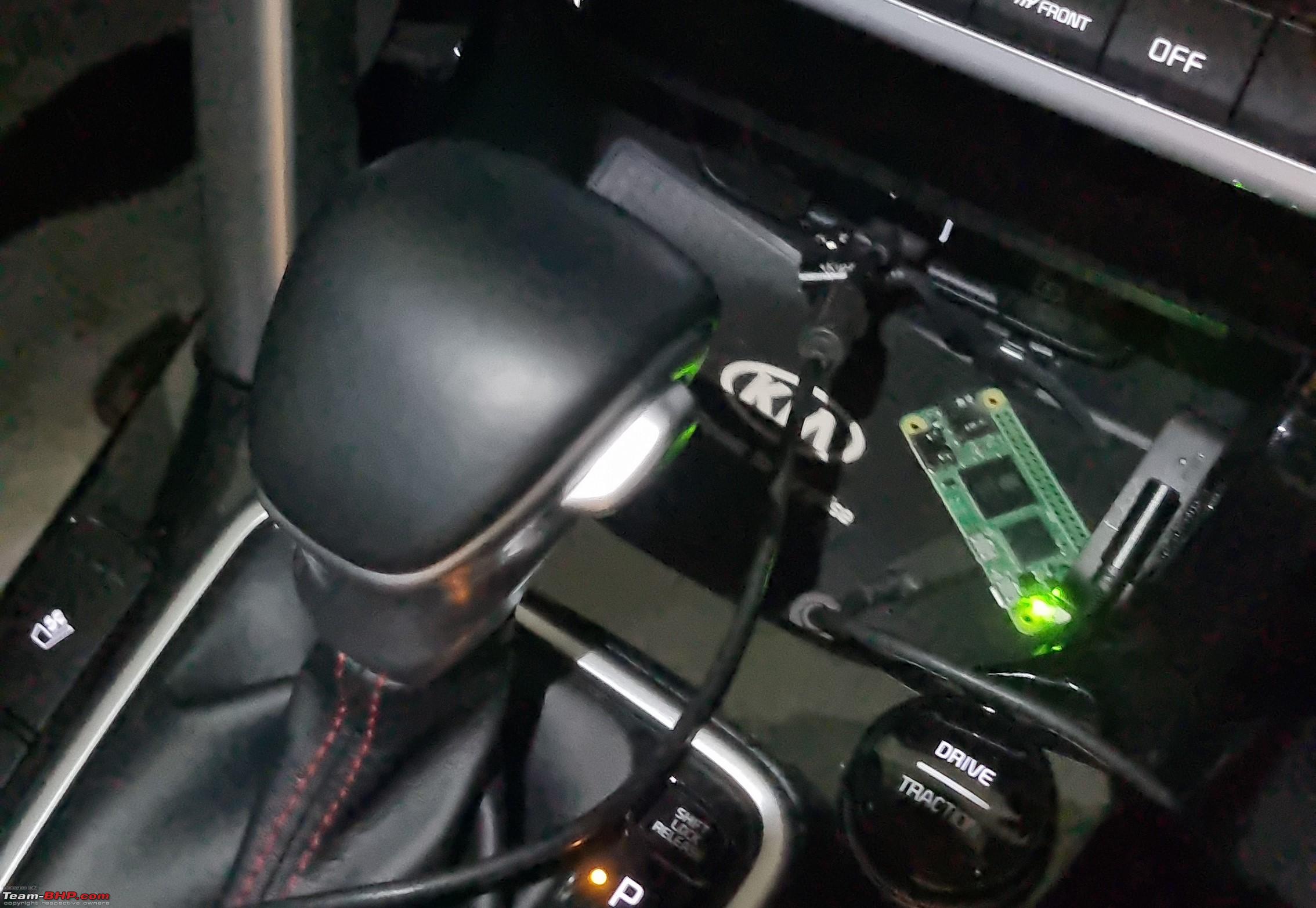

8. Insert the SD card in RPi SD card slot. Head to your car. Switch on. Connect the micro USB cable to RPi OTG USB (marked as USB, not PWR IN) and USB A side to your car's AA USB Port.
Use Rpi Zero as a cheaper alternative for Wireless Android Auto | Cost under 2,000 rupees-20240823_144128.jpg

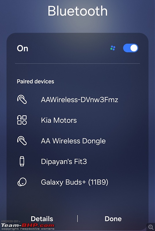

Make sure in your mobile both Bluetooth and WIFI is enabled and "Wireless AA" is enabled in Android Auto settings.
9. First time it takes around a minute and you would see "AA Wireless Dongle" available in your Bluetooth devices list on your mobile. Pair with it.
Use Rpi Zero as a cheaper alternative for Wireless Android Auto | Cost under 2,000 rupees-screenshot_20240823_144414_one-ui-home.jpg
Use Rpi Zero as a cheaper alternative for Wireless Android Auto | Cost under 2,000 rupees-20240823_134345.jpg

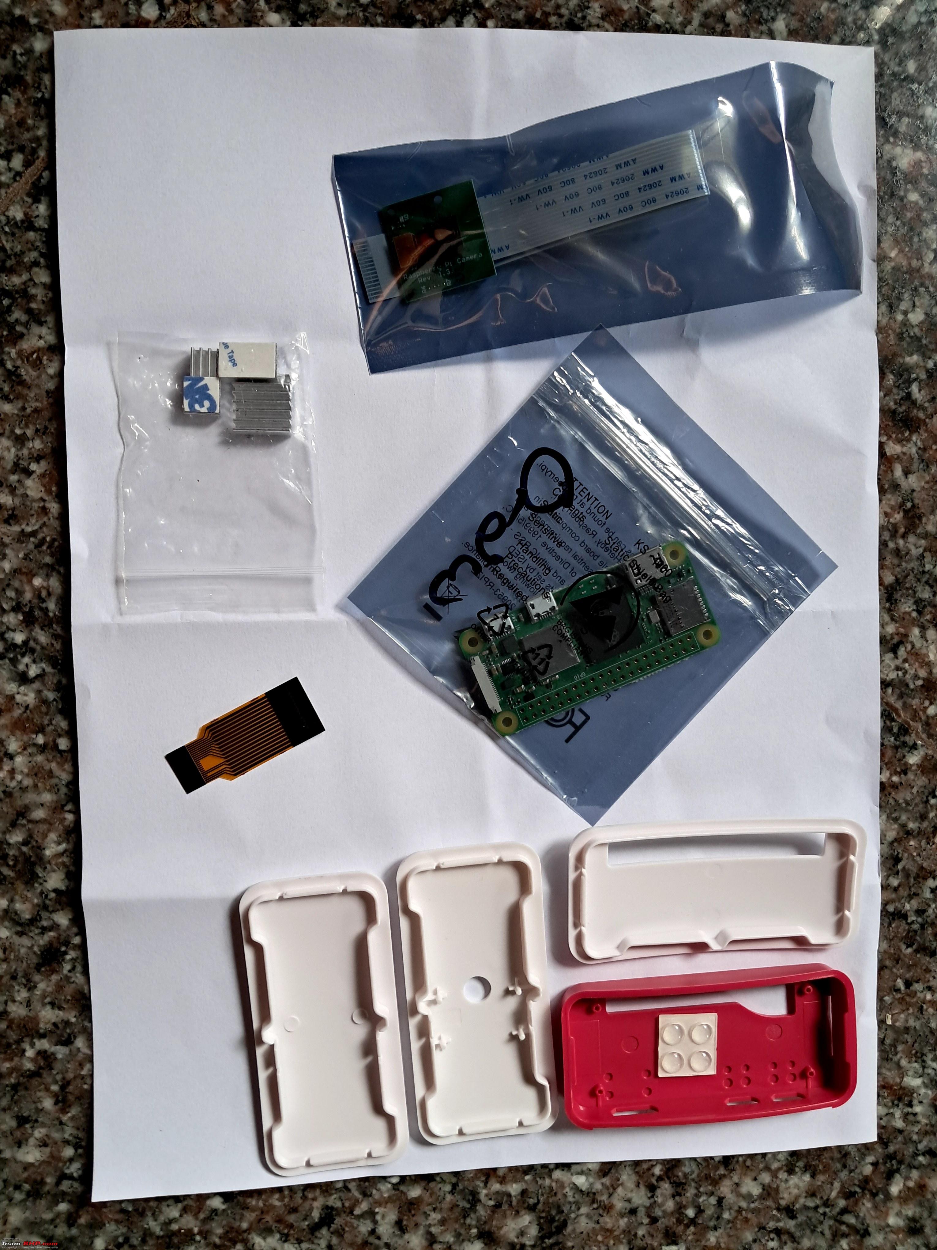

Thank you, Dipayan for the input. I took the plunge and ordered the following items on 26 August from different portals as not all the items were in stock at one place -
  1. RPI Zero 2W, RPI camera, heatsinks from Silverline Electronics
  2. RPI Zero case from Robocraze
  3. Card reader from Amazon
Use Rpi Zero as a cheaper alternative for Wireless Android Auto | Cost under 2,000 rupees-20240829_165748.jpg
Use Rpi Zero as a cheaper alternative for Wireless Android Auto | Cost under 2,000 rupees-20240829_212614.jpg
All the items were delivered yesterday and I first set out to build the camera project. It was a flop as even the board did not turn on. I did not realize it until the light on the board gleaned on plugging into my Punch's USB port. I did not know that an indicator light existed on the board. I later realized that the charger I used and my desktop's USB port was insufficient to power it on.
I then focused on getting the Android Auto right. Raspberry Pi Imager was easy to set up on my Ubuntu 24.04 and I got the image written onto the memory card. Quickly inserted the board onto the case and stepped on to the car to test things out. The Bluetooth kept disconnecting and the WiFi stayed connected. Started wondering if Punch's default Bluetooth connection was causing this. The default one would get added on using Wired Android Auto even if unpaired. The plug/unplug, using a different cable cycle ensued to no avail. I re-read the GitHub documentation and noticed this line -
On Raspberry Pi Zero W and Raspberry Pi Zero 2 W: Use the second micro-USB port marked "USB" and not "PWR".
and that was my mistake. I went back to the car, used the USB port on the board this time and the phone successfully stayed connected.
Use Rpi Zero as a cheaper alternative for Wireless Android Auto | Cost under 2,000 rupees-20240829_211950.jpg

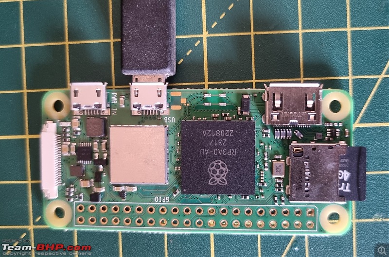

Attachment 2645342
I have mentioned about it also.
Originally Posted by saikishor View Post
When I plugged it in for the first time, it connects to bluetooth first and then wifi. Once the zero 2w connects to wifi, it disconnects from bluetooth immediately. It pairs and disconnects from bluetooth instantaneously. Is there any solution for this?
Similar issue as gischethans mentioned above. Have you checked the usb connection as mentioned -
Please see the image Attachment 2645342

Update:
I am happy to report( literally happy tears, as this is the first ever DIY I did that turned out to be successful) that the device is working in both of my cars on two different head units(stock honda HU and Sony XAV AX100). Used a branded Realme Braided cable and it worked. Not only this, I suspect part of it to be my fault as well, because I did not follow the installation steps properly. I mean, I did everything perfectly except for the first time connection step. I did not connect my phone via wired android auto before initiating first time connection. I think this was where it went wrong.
Use Rpi Zero as a cheaper alternative for Wireless Android Auto | Cost under 2,000 rupees-screenshot_20240831094654.png
Use Rpi Zero as a cheaper alternative for Wireless Android Auto | Cost under 2,000 rupees-pxl_20240830_134130083.jpg
Use Rpi Zero as a cheaper alternative for Wireless Android Auto | Cost under 2,000 rupees-pxl_20240831_094010347.jpg
Use Rpi Zero as a cheaper alternative for Wireless Android Auto | Cost under 2,000 rupees-pxl_20240831_094321241.jpg
