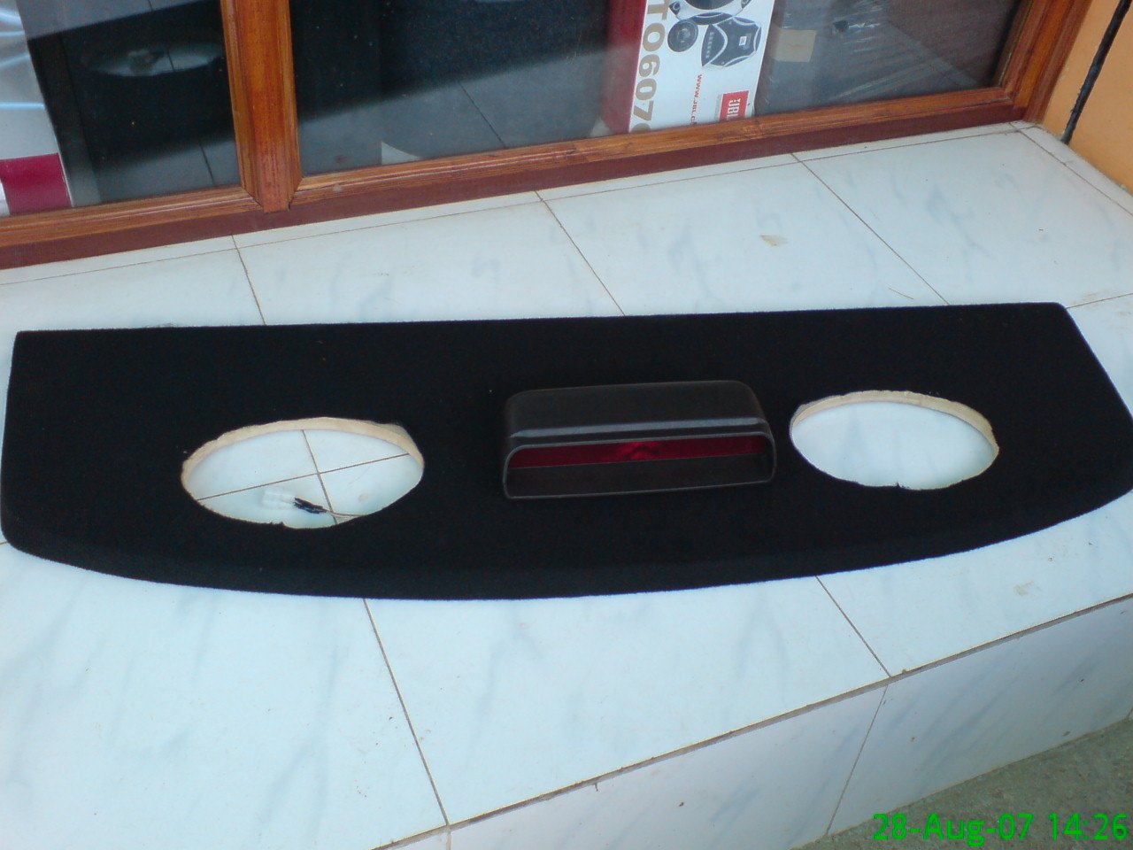

Rear: Scosche eFx HDC6900 6X9 Coaxial Speakers

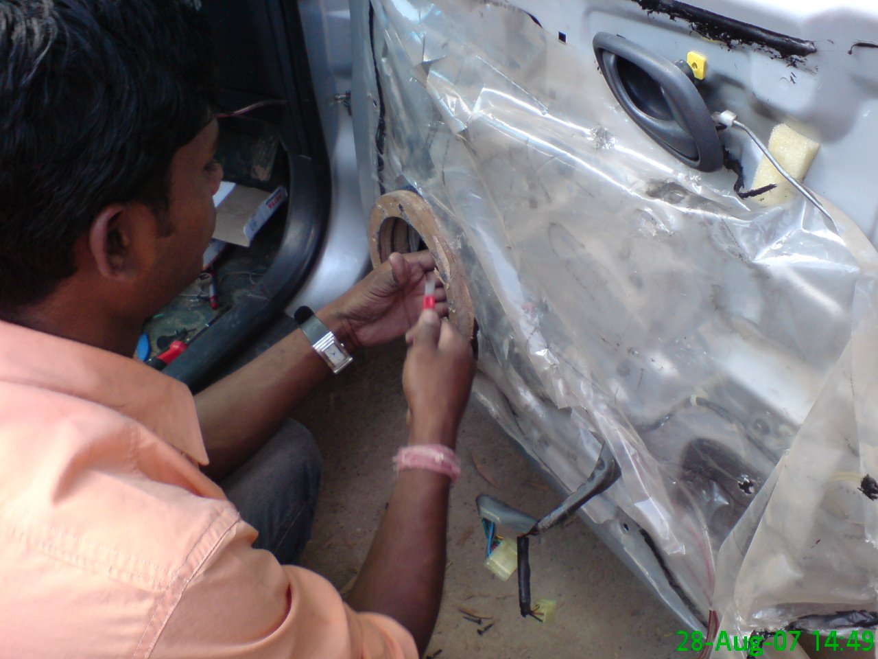

These are the old speakers. They are not even 2nd rate duplicates but 3rd rate cheap duplicates as per BlueRaven.. Hey dont look at me. that was put in by the last owner (lady). Yes the metal pieces you see were used to hold the 3" speakers in the 5.5" front bay. we had a good laugh when the door panel was removed. Sorry we were discussing what went through the guys head when he set it up and forgot to take a pic.

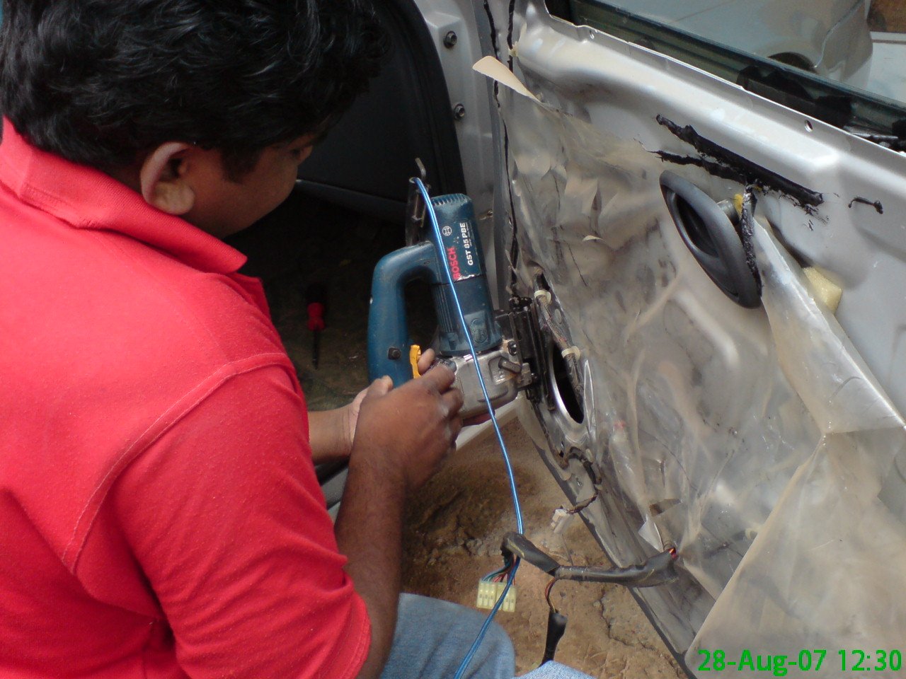

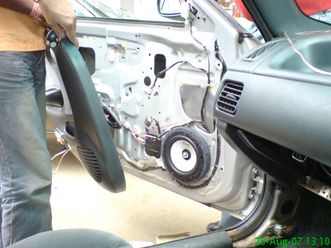

The Front Hifonics had huge magnets which could not sit in the stock housing which meant cutting the inside part of the door. The fronts needed lot of adjustment as it was either hitting the door panel or the glass behind when glass was rolled down. so little shaving of the rings and adjusting the speaker did the trick. Neat job by ravens man. The rear panel is nice and fat with jet black cloth.
Yes the Front Speakers have LEDs which makes the white speaker glow. The LEDs are neatly connected to the cars Headlights.
I had the 4650 HU in my old Esteem with (Orginal) Pioneer and Blaupunkt speakers. The output from the old Pio 4650 now with these speakers is a world apart. Cant wait for a decent Amp to feed these puppies. Anyone selling??
