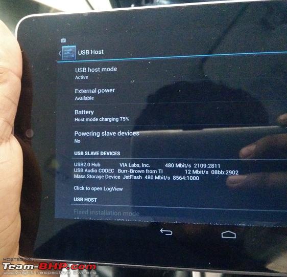

Can I connect the USB hard disk (see above) to a portable DAC and then the DAC connects to the HU? How does the HU connect to the DAC? I assume the hard disk would connect via USB. The HU still needs all the "metadata" of the music so it can display Artist, Album, Title and Album Art so you can't use analog outputs of the DAC can you?
You need to connect all of this to an android device and use its interface. The RCAs coming out of the DAC can be connected to the head unit.
EDIT : with this setup, android bypasses its internal/phone DAC and sends digital out thru USB which is then converted to normal audio signals by the DAC. If you use normal/stock player apps on android, it gets resampled to 16/4.1 or 48khz. If you use a dedicated app like USB Audio Player Pro, it bypasses this restriction and can send upto 24/192.
I have done a/b testing with my laptop and phone on such a setup in the car and it sounds exactly the same.
If you want an all in one solution, you can look at chinese android HUs. I know few people who have connected a DAC and a USB HDD to it, routed audio out thru the DAC going into amps. Except these, I'm not aware of any other head units where DAC can be directly connected to the head unit.
How do I power the DAC? via USB?
I use a powered USB hub, USB hub is powered by a phone charger.
Here's a photo from my Nexus 7, which has the powered USB hub connected to it alongwith a 128GB pen drive and a Behringer DAC.
Which DAC do you use? Schitt? Dragonfly? Audioengine?
Pretty much any USB DAC will work. I have personally used a Behringer UCA202, Audinst MX1, Objective ODAC and currently using an Alien DAC.
PS: I just pieced together unused audio stuff I had for my car setup viz Nexus 7, Alien DAC and the hub. Even the cheap Alien DAC sounds miles ahead of the supposedly very good 80PRS.
If I feel lazy to take out the tablet, I can even connect my phone and play songs through it, although it wont charge with OTP on, unlike my Nexus 7.
