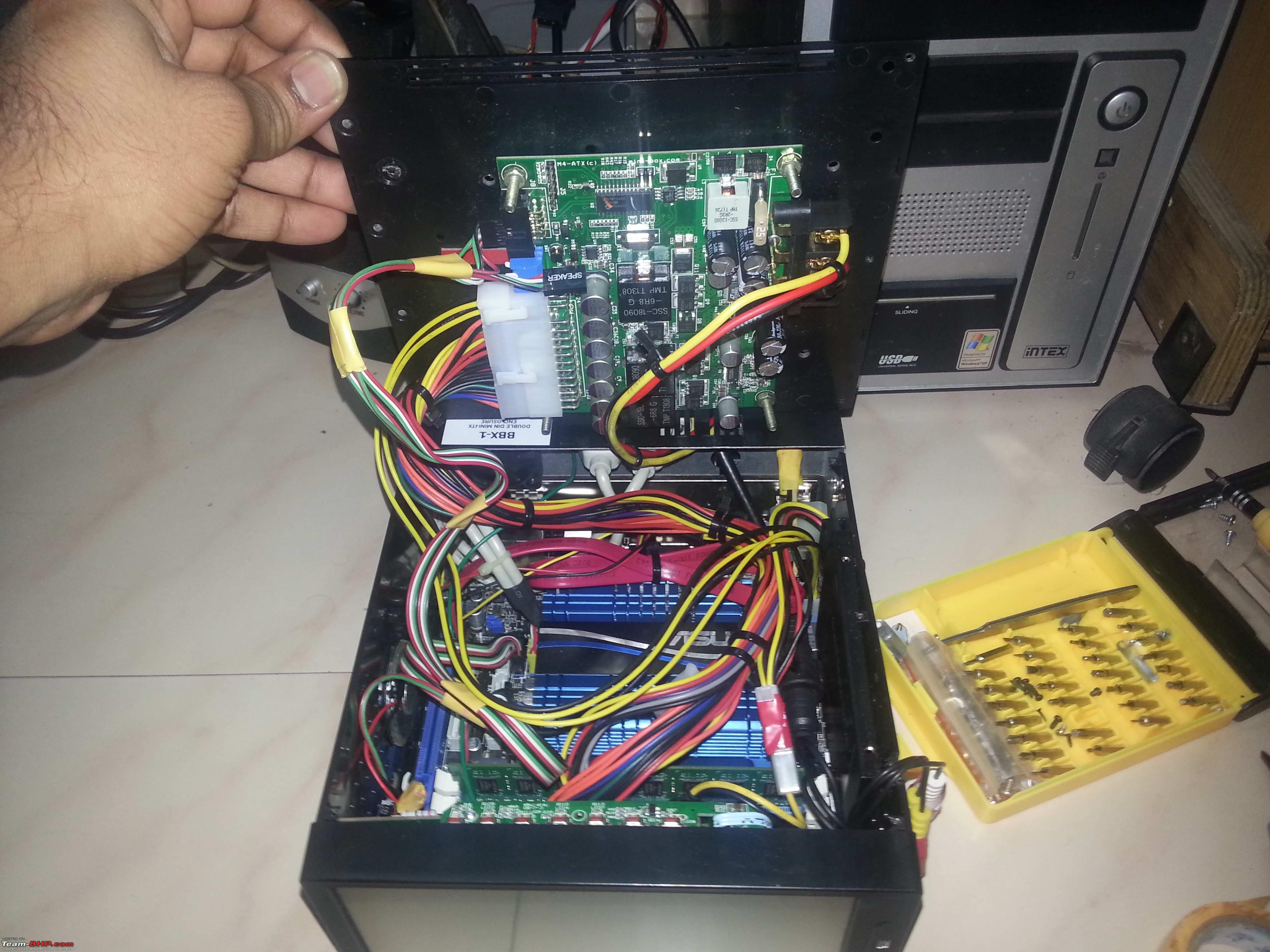

@ sprucegoose: Regarding the PSU, i suggest you for this http://www.ebay.com/itm/M4-ATX-250W-...item1c2b7844e2
I have used in my cousin's carputer (will open thread on it by this weekend).
The M4 ATX is rated 250W and caters well to the requirements of a carputer.
Here is a pic of the setup
The CarPC / Carputer Thread-20120904_193956.jpg
@badboyscad which case is it ? can it accommodate sound card ?
