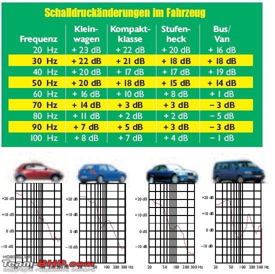

Originally Posted by abhibh View Post
Who knew 2 iDv3 can do 151.2 DB. Remember Sam's car ?
Debatable! The same equipment couldn't do more than 140 or 144 (i think) in an SUV on the so-called infamous delhi db drag!
@ Mods: I'm NOT starting any issues, but its just that what I've been given to understand over last couple of threads!
Kindly feel free to edit if its not acceptable.
panky12345 is offline
Old 8th April 2009, 15:14   #69
abhibh's Avatar
Join Date: Sep 2005
Location: Back in the HOOD near you!
Posts: 2,768
Thanked: 39 Times
Arey this is a healthy discussion. I hope you will understand after checking out the attached image.

.. now if I see and analyze this chart carefully, the actual db figures would further come down!
depends on cabin gain. remember my old posts about the 60-80Hz region being where most cars have problems. guess they still have not sorted out these issues.
Look at the chart again see that boost sub 50Hz. This boost will make the car sound bass heavy and not natural if you stuff a sub that is flat in anechoic conditions in a car. this is why I have hinted in the past that a car actually allows you stuff a sub in a box one size too small (high Q say 0.7<Q<1)and then flatten the Q by increasing box losses (QL) by going aperiodic. The loss in sensitivty due to box losses is made for by cabin gain below 50Hz. Use the cabin gain for your gain. Use the cabin loss for your gain. DIYers have a huge advantage over speaker companies. They can design for their cabin/room!
