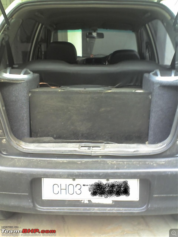

Ok time has come that i get my car ICED. Have listened to a lot of setups in past 2 - 3 months different brand speakers, amps and what not.
Normally what we get to listen here in Chandigarh is BOOM BOOM BOOM from 2 block away. Check the pic below what we get here.
But after hearing some good brand speakers and subs and reading here too, decided to almost do DIY myself by sourcing good equipment.
In past few months have listened to the following brand speakers in my city-> Chandigarh:
1. JBL GTO 607C - Good VFM considering they cost 4700 with B/W. Get little harsh on high volumes though.
2. Infinity Reference Series - Again good components but didn't find them to be much different from 607C
3. Some Illusion(don't exactly know what model) - Nice sounding, Good midbass.
4. DLS - Dont know the model number but best sounding of all the above. Costs around 9K-10K.
Now i can spend around ~8-9K for components. Any other suggestion on which components to go for will be appreciated.
Head Unit:
Now comes the HU part. Maximum i can spend is 8K. USB is a must. Pioneer is out of the list due to lot of problems like randomize etc etc. That leaves the options to JVC and Kenwood. I like the new 2008 kenwood series so most probably will go for that. any other suggestions regarding HU ?
Amps / Subs:
Have heard a lot of desi amp Alpine, Glider, Nakamichi, Soundblaster and what not. Chandigarh is flooded with them. Some good branded amp i have heard are kenwood 8401 and JBL 300.1 and 75.4. Both JBL amps are good. The 75.4 is a very rare find though. My friend got once recently. I like the good power but have to turn down treble sometimes. But very good overall.
Any other 4ch amp within the budget of 5K - 6K for powering the components.
Sub is one of the hardest thing to decide because i don't want the sub to play too much harsh n loud. It should blend perfectly with music and should not be booomy at high volumes. At the same time i want it to play loud and do TIGHT boom boom which should not give headache. 90% of the time it will not be in BOOM BOOM mode. Just plain and simple SQ.
I have heard all pioneer, JBL, JVC, kenwood, BOSS blah blah couldn't find a good one that satisfies my need OR maybe be due to the enclosure we get here the subs doesnt sound good.
To power the sub i will need another amp probably a MONO. So a good mono @12k will be good for that.
Installation / DAMPING / Wiring:
Again as compos will go in front door i would need to damp the front doors and boot. Dont wanna end up spending 10k just for the damping so economical damping product will be good. Price and suggestions are welcomed.
Same goes for the wiring. Don't like the DESI BOSS or JBL, but also do not want to spend just 10k on wiring. Some good wiring even house-hold will do the job but it should be good so that I don't miss the listening pleasure of components and subs.
I think i have covered almost every thing except for install which will be a DIY so i don't need to pay myself except for the stuff used like spacer rings etc..
So let the suggestions flow through this thread
P.S. Install will take place in 2 stages.
1st phase: HU, Components, amp, 2 front doors Damping
2nd phase: MONO amp and Subs and boot damp if needed.
