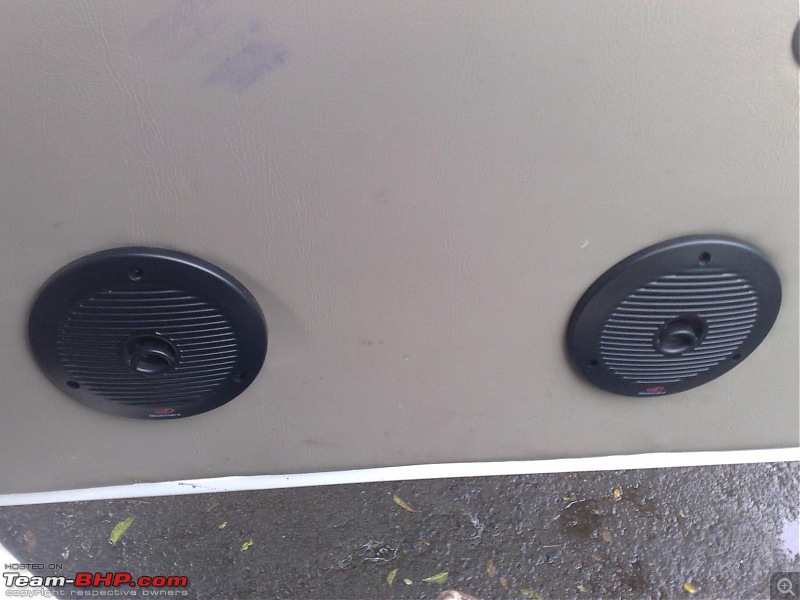

i have a scorpio VLX in which i have 4 standard kenwood speakers, two 400W sony speakers in boxes and a 1000 W sony subwoofer. the amp is sony too, 2 channel. but somehow i am not getting the desired bass level. a friend told me that the standard kenwood head unit is not good enough and i have to change it. is it true? i want a good bass effect at minimum cost now!
which brand of head unit should i opt for considering i need a good power output. which brand and which model has the best looks, features and power o/p at the lowest price?
i will prefer upgrading the head unit and i have a budget of 7000-8000 for the same. i can also exchange or trade-in the current head unit to replace a new one. kindly suggest a good brand of head unit with good power output.
also, is there anything wrong with the sub and amp (in terms of power or compatibility). the amp runs both the subwoofer as well as the 2 sony 400W speakers, is this ok?
i wont prefer changing the sub or speakers as that would require a bigger budget! i am happy with the sound quality, only wish much more bass effect.
here are some pics of the same:
the front speaker in the front door, standard kenwood:

Major problem is the Enclosure in which your equipment is installed. And second major tuning issue like speakers running out of phase in refer to the sub which is canceling all the bass. Try going to a good installer. You can try BOOM

Yes the sub box is too small. Sony woofers are not known to be great anyway.
Use the HU to drive front and rear speakers and the 2 ch amp for the sub.
Like LBM said, get a good installer and first extract the best out of your current components then think about upgrades.
you have 6 speakers and a sub. you need 7 channels of amplification. so after you are done with 'extracting the best' these are the upgrades youd have to keep in mind...

You got to bridge the 2 channels in your amp & give the brridged output to the sub woofer & run the rear speakers off the HU.
