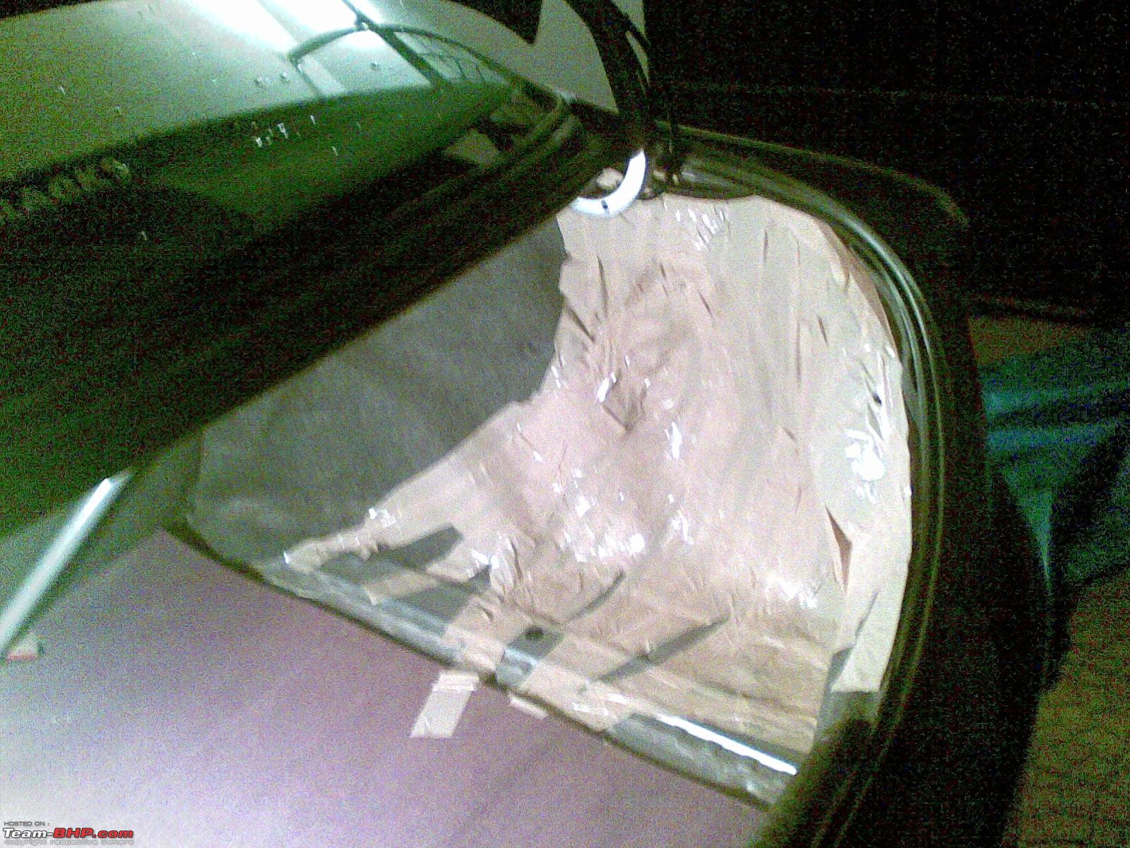

3: Initially i was trying to line up the boot with the plastic sheet , but it turned out that the sheet was too thick to handle the contours of the car sidewall. Besides, it was also difficult to stick the sheets in place once pressed. Masking tape was not adhering to the carpet lining on the sidewalls. This idea was ditched and started layering brown tape all over for the 1st stage of protection.
4: stage completed completed

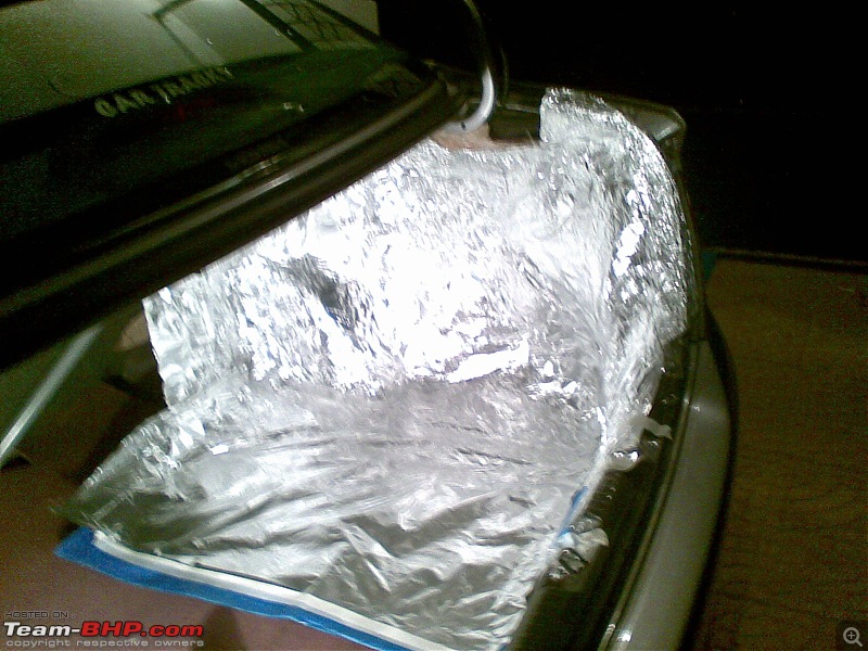

6: 2nd stage/level Protection - Aluminum foil lining , this was easy to do since the foil was bending into the contours of the vehicle and staying in position .Taping and lining the sidewall could be done separately.
Found- Fibreglass sheets retailer in Hyd-aluminum-foil-1.jpgFound- Fibreglass sheets retailer in Hyd-al-foil-complete.jpg

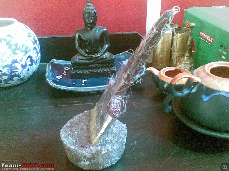

and here's the final outcome of mixing 5%hardener to the Resin,If you match it with the relevant pictures above in this thread, you can notice how this has crystallised completely and hardened.This is my NEW PAPERWEIGHT.
