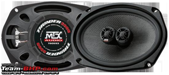

2. Rear Ovals - MTX Thunder 6000 series T6C693
Name:  MTX thunder 6000 T6C693.png

4. The RR ovals were fitted with custom made MDF planks at both the extremes of the Tailgate door.
