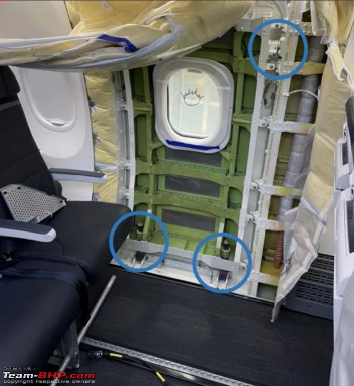

Looks like Boeing and Boeing only is responsible for this near-catastrophe, not Spirit.
https://www.ntsb.gov/investigations/...y%20report.pdf
Missing bolts picture:
Alaska Airlines Boeing 737-9 MAX mid-cabin exit door blows out mid-air, forcing emergency landing-737.jpeg
The two circled parts in the bottom of the pic are not bolts. Those are springs to aid pushing the door up and out in case of emergency.
The door plug is held by four bolts and also secured to 12 different locations along the side the door frame.
sagarpadaki is offline

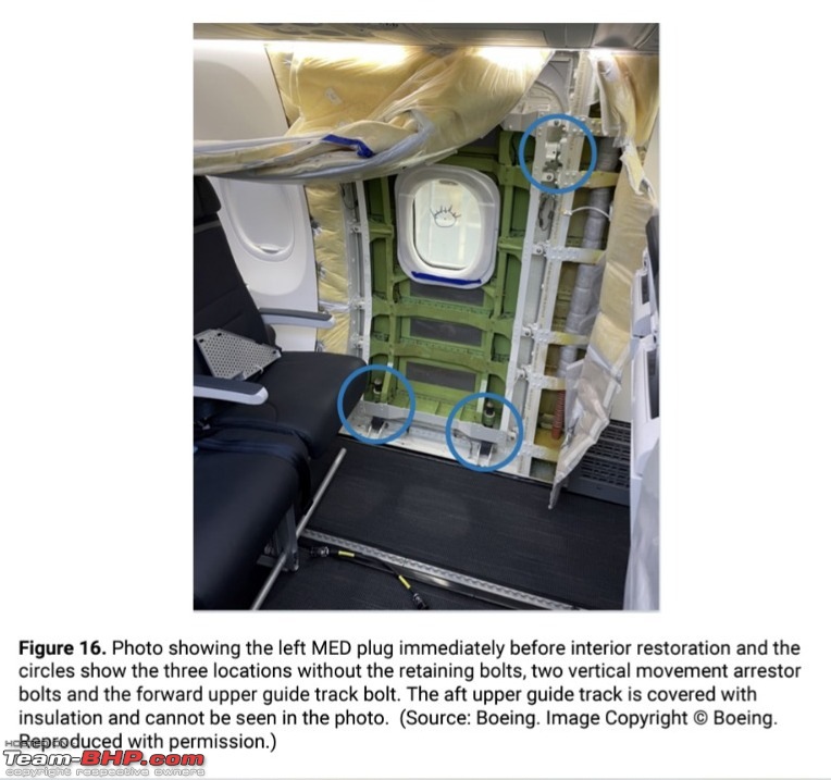

The picture is from the NTSB report itself.
Alaska Airlines Boeing 737-9 MAX mid-cabin exit door blows out mid-air, forcing emergency landing-2.jpeg
