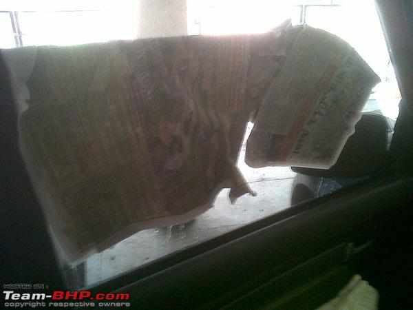

Thanks to this thread and others here at TBHP, I completed my DIY project for sunfilm removal this morning and feel liberated now with so much more light coming into the car :D
Pretty much followed the steps given in this thread and others, some pictures here for the steps followed:
Soak newspaper in water (make sure it's not very soggy)

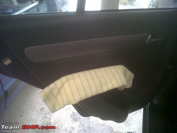

Protect the switches on door panel (used a towel here)
Paste the newspaper on the inside of the glass

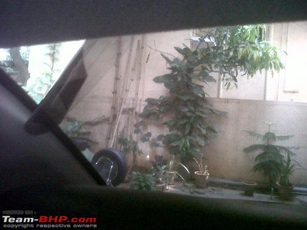

Get hold of top corner of the Sunfilm (you can use a small knife/blade carefully) and Start peeling
OR you can Get hold of bottom corner of the Sunfilm (you can use a small knife/blade carefully) and Start peeling
Continue peeling the sunfilm across the width of the glass
Done with one glass
