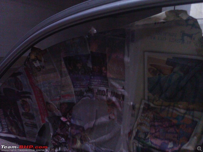

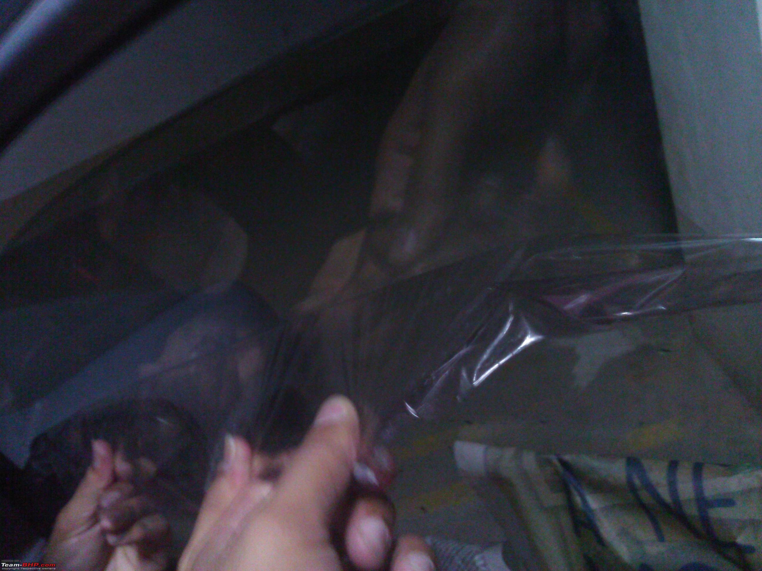

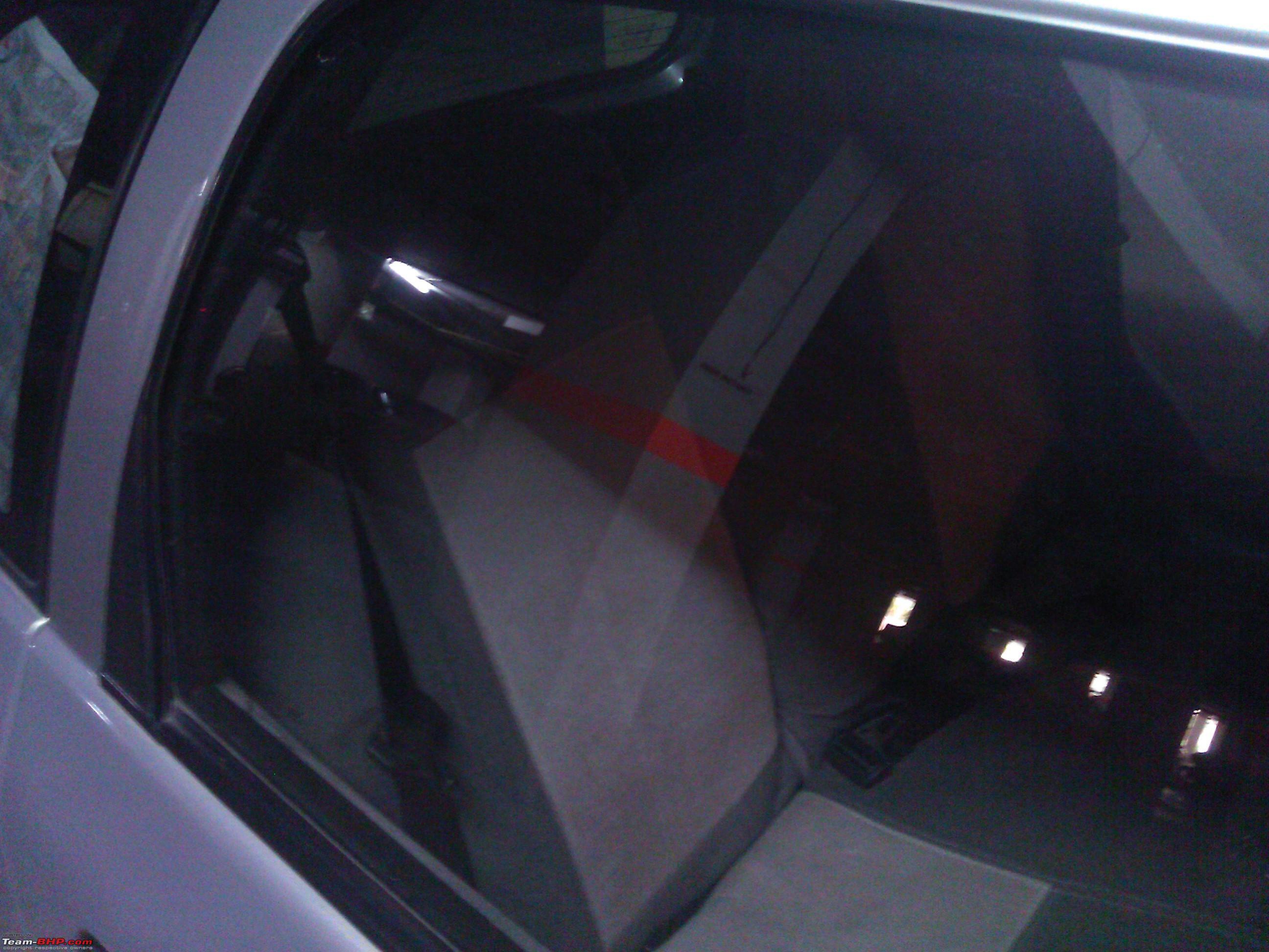

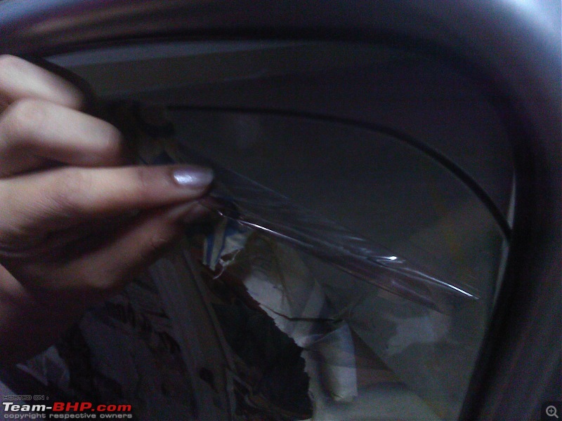

I finally removed the sun films on my Corsa today. It was quite a easy and quick procedure. The films on 3 windows and both quarter-glasses came off very easily. One window had some residual glue left.
Here's what I did -
1) Paste wet newspaper on the window; especially at the top end from where I intended to peel the film. Let it be for 5-10min
2) Removing the film; top-most layer at a time
3) Clean the glass twice with Colin+dry newspaper.
All glasses look clean now. Luckily the rear windshield did not have film (the installer had advised us against putting it on in the first place since there is a defogger).
Here are some pics :
