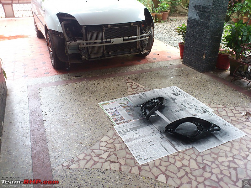

I've painted the headlamp bezels of my Swifty in black. The pictures will explain this DIY. I'm a newbie here. Suggestions and comments are welcome.
DIY: Headlamp Bezel Painting (Maruti Swift)-dsc_0661.jpg
The bumper was first removed.
DIY: Headlamp Bezel Painting (Maruti Swift)-dsc_0662.jpg
DIY: Headlamp Bezel Painting (Maruti Swift)-dsc_0666.jpg
Headlamp assemblies are removed.

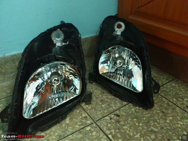

DIY: Headlamp Bezel Painting (Maruti Swift)-dsc_0668.jpg
I used hot air gun to soften the silicon gum and a screw driver to open the assy.
DIY: Headlamp Bezel Painting (Maruti Swift)-dsc_0669.jpg
The bezel was screwed on to the case with two screws and they were removed.
DIY: Headlamp Bezel Painting (Maruti Swift)-dsc_0670.jpg
Bezels were cleaned and rubbed using fine grit sand paper. Indicator reflector was masked (using masking tape). And the first coat was given.
DIY: Headlamp Bezel Painting (Maruti Swift)-dsc_0671.jpg
After the second coat.
DIY: Headlamp Bezel Painting (Maruti Swift)-dsc_0672.jpg
After the third coat.
DIY: Headlamp Bezel Painting (Maruti Swift)-dsc_0673.jpg
Headlamp assy. resealed by melting the existing silicon gum.

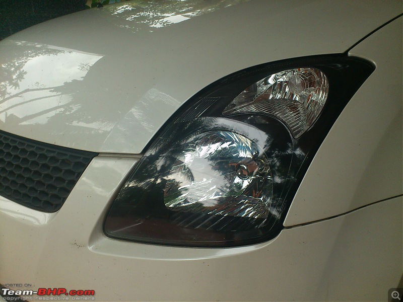

This is how my car looks now.
DIY: Headlamp Bezel Painting (Maruti Swift)-dsc_0812.jpg
Didn't notice any loss in illumination. But of course, there will be some loss in reflected light. But not too much, I suppose.

Not at all a bad job. But can you post an un-processed closer look of your headlights? Can give us guys a better idea on the end output.
Also any changes done to the rear lights? I feel they'll really come out with the above/similar setups!
Thanks ninjatalli. Here's another picture, unprocessed one.
And nothing is done on rear lights.
