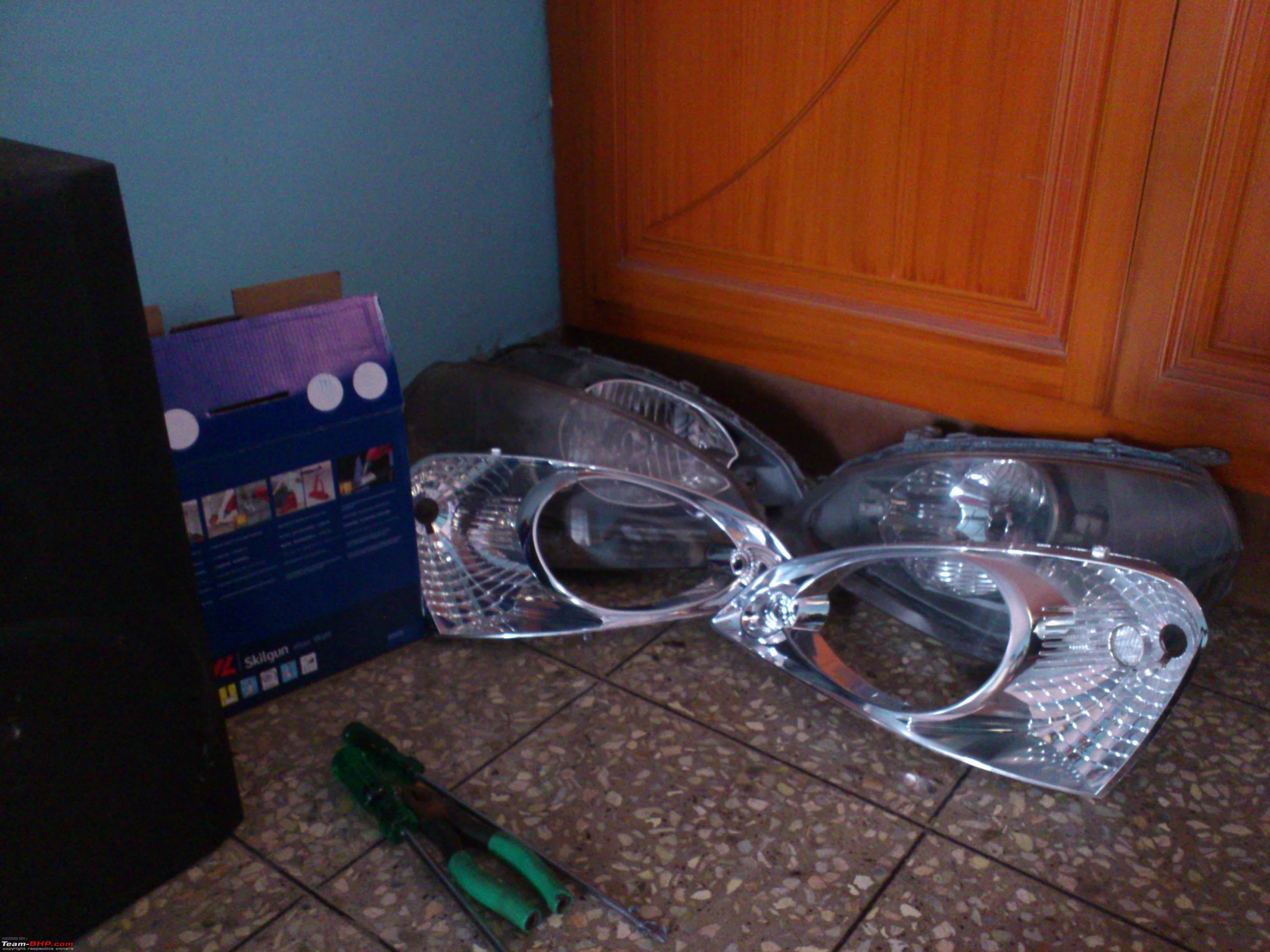

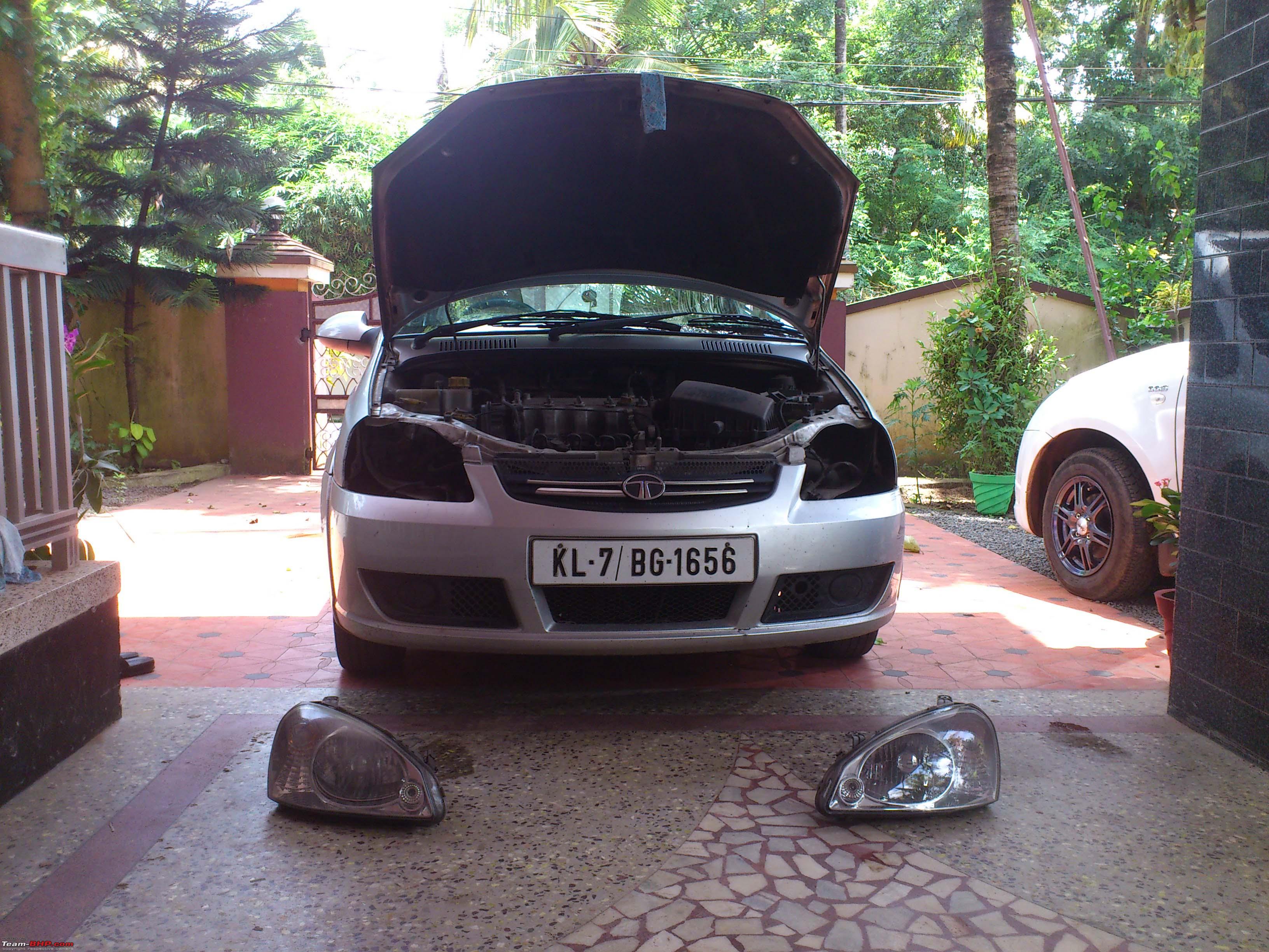

Painted the bezel's of my cousin's Indica on a lazy Sunday afternoon.
Here are some pictures of it. All the steps are same.
DIY: Headlamp Bezel Painting (Maruti Swift)-dsc_1036.jpg
DIY: Headlamp Bezel Painting (Maruti Swift)-dsc_1037.jpg
DIY: Headlamp Bezel Painting (Maruti Swift)-dsc_1044.jpg
First Coat
DIY: Headlamp Bezel Painting (Maruti Swift)-dsc_1047.jpg
Final coat (3rd coat)
DIY: Headlamp Bezel Painting (Maruti Swift)-dsc_1053.jpg
DIY: Headlamp Bezel Painting (Maruti Swift)-dsc_1054.jpg
The final outcome. Comments and suggestions are welcome.
At Mods: I thought of posting this here,because there's no need for a new thread. Please change the name of thread or move it to appropriate thread, if needed.
