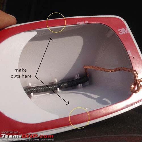

Task : Replace OEM stick antenna of the Vento / Polo
Time : 10 - 20 mins
Brightness level: 7 years and above
Package Components : Sharkfin antenna, Nut and Bolt, Double sided adhesive strip
Other requirements : Paper cutter(sharp), Hair dryer, a beer(s) , friend(s)
Step 1 : Take out the screw and nut from the packet and screw it on to the sharkfin antenna hole. Stuff the entire copper cable into the antenna cable.
Step 2 : Take the double sided adhesive strip provided, remove the white backing paper and stick it on the sharkfin antenna base. This adhesive is quite strong but pretty thin so the gap between the car roof and the antenna base is minimal
Step 3 : With the cutter Make 2 cuts on the red coloured 3M adhesive backing. This should be on the narrow side and enables easy removal once the cable has been screwed on to the car.

VW Polo DIY: Installing the OEM sharkfin antenna-cuts.jpg
VW Polo DIY: Installing the OEM sharkfin antenna-img_2187.jpg
VW Polo DIY: Installing the OEM sharkfin antenna-img_21861.jpg
VW Polo DIY: Installing the OEM sharkfin antenna-img_2178.jpg
