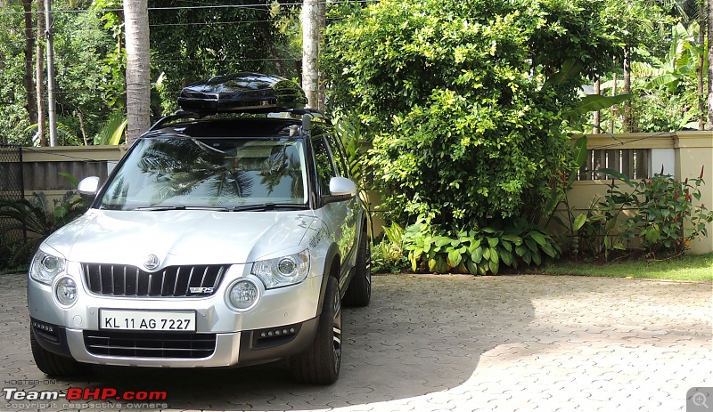

New Thule roof rack and roof box.
My Skoda Yeti - DIYs, OE Upgrades & Custom Mods. UPDATE: Park Assist video on Page 8-9.jpg

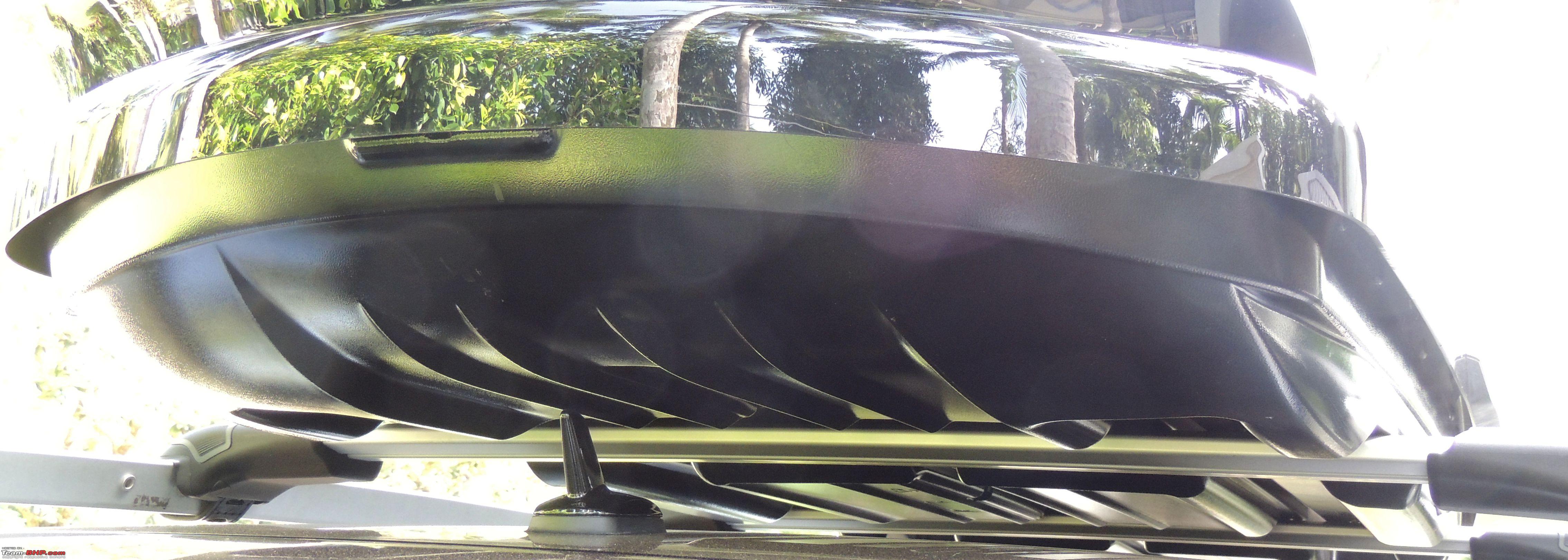

See the box just sitting over the bars without any fixtures? That’s what T track adapters are for.
My Skoda Yeti - DIYs, OE Upgrades & Custom Mods. UPDATE: Park Assist video on Page 8-10.jpg
No claws or fixtures visible. Just a box sitting on the cross bar.

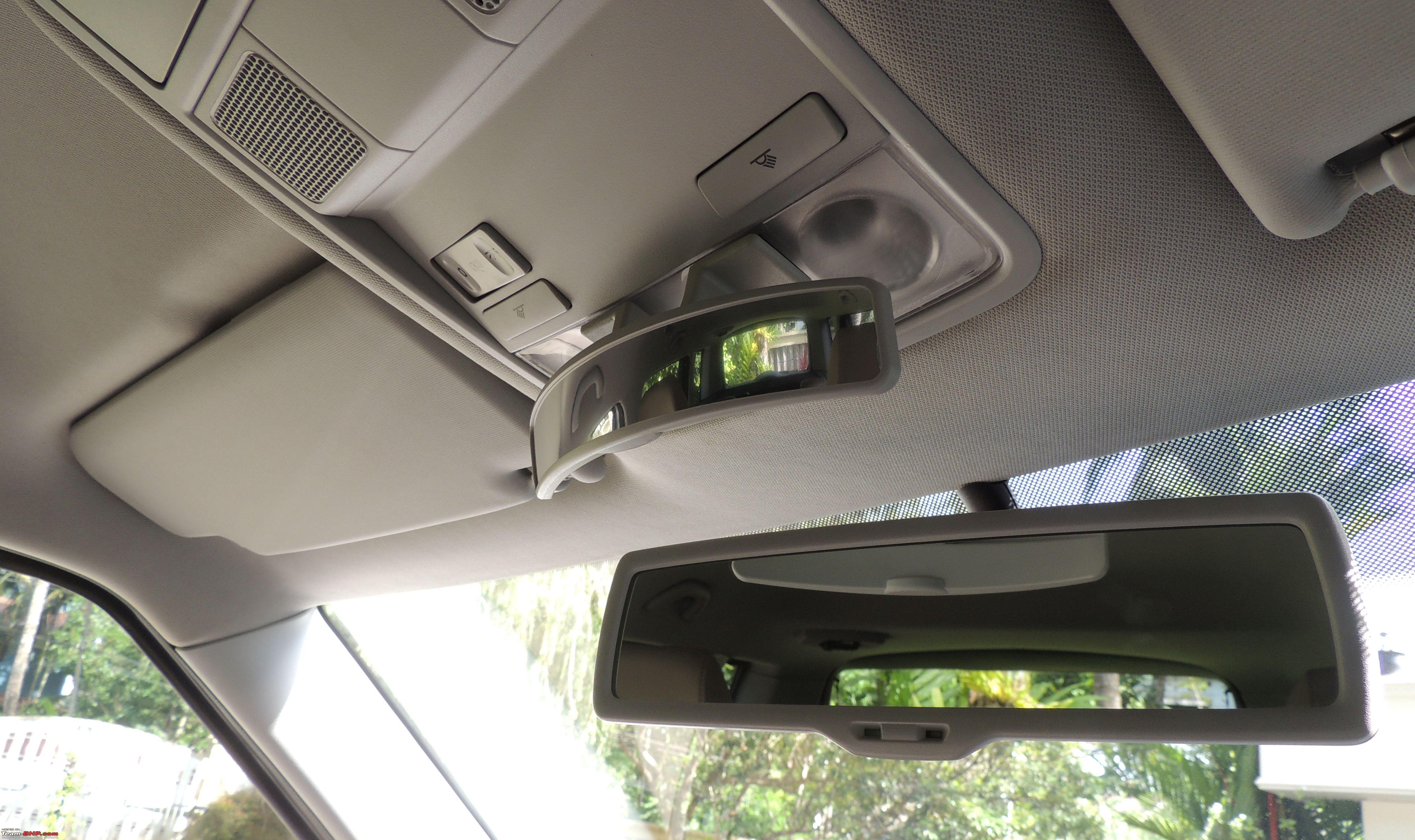

Baby mirror (OE). Both front driver and passenger gets a full view of full rear seat to keep a watch on the kids belted up on the rear seats. The location as per instruction booklet is between the roof lining and the IRVM. But there is no space there in the Yeti to fix the baby mirror. This location is good. Gives a good view as well as does not block the cabin lights.
