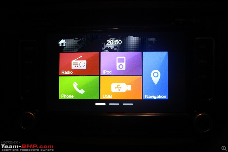

Since you wanted a teaser pic anyways, here it is :D Dynavin Installed!
My Skoda Yeti - DIYs, OE Upgrades & Custom Mods. UPDATE: Park Assist video on Page 8-dynavin-teaser.jpg
Finally! I know that the resolution is very good, but how is the touch sensitivity? And post a video of the UI, hope its not glitchy.. And is a 'smooth operator'. Good luck with it :)

Touch sensitivity is good. It is quite a 'smooth operator' :)
Have put up detailed initial review in a separate thread dedicated to Dynavin N6-VW. There is a video in the review showing the smooth operation of the touch screen. Will post a link in this thread as soon as the review is shifted out from the assembly line. Thanks Adi!
