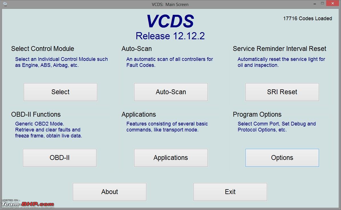

Yep. It is pretty basic. There is a SRI reset button on the VCDS main screen. Attaching a screen shot.
Attachment 1268029
Resetting it to 15000/365 days can be done via the MFD menu in my case as well. I have to set it to a particular value which was as per the reminder from the stock cluster. Can this be done via VCDS?
I haven't done it myself yet but have read somewhere that it is possible through VCDS. Will have to look deeper to find out how it is done, or else you can contact Sugesh. He should be able to guide you if any problems.

I thought SRI reset option was available as shown here.
ventoman is offline   (1) Thanks
Old 13th April 2016, 08:38   #29
frankmehta's Avatar
Posts: 4,029
Thanked: 3,668 Times
Re: VW Polo DIY: Removing / upgrading the instrument cluster
Nope. That's not the one to reset the ODO. Even vw dealers don't have options to "clock" the newer cars.
