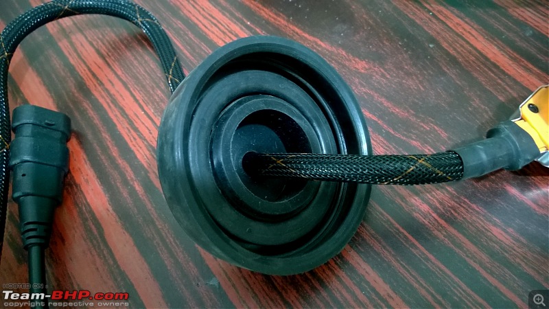

Ballasts: Morimoto 3Five DSP Long Cord
Wire harness: MotoControl Bixenon H4/9003

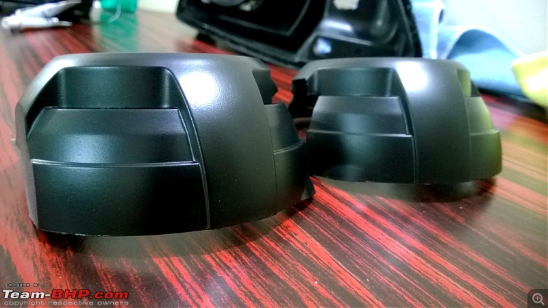

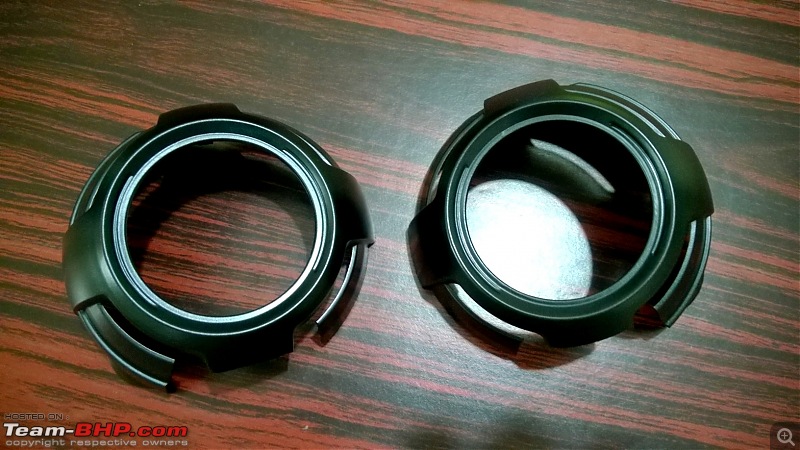

Shrouds: Apollo 2.0 Flat

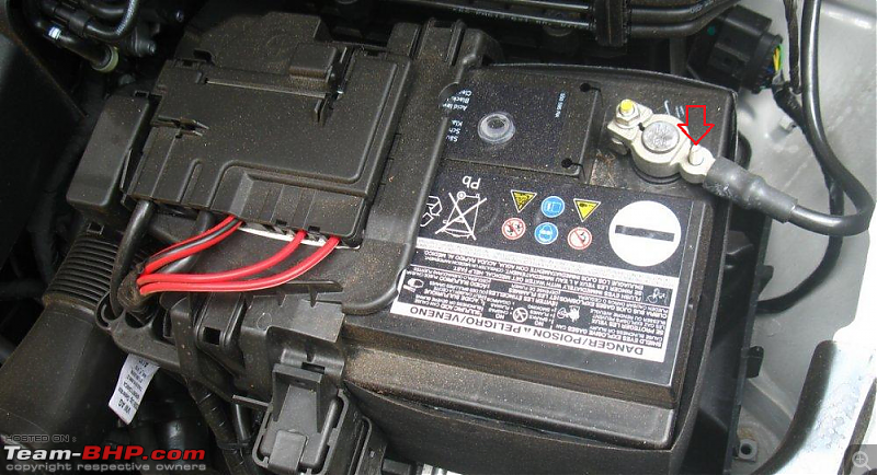

  2. Ring spanner (10-11) - for unscrewing/fastening the nut on the battery and for screwing the ballast units to the body.

  20. Dremel/rotary tool with a cutting wheel - to cut the shrouds to fit the stock reflector bowls and grinding the H4 bulb flange on the rear of the reflector bowls. This tool is strictly optional. Any engineering shop will do cutting/grinding for you for cheap and takes 10-15 minutes tops.

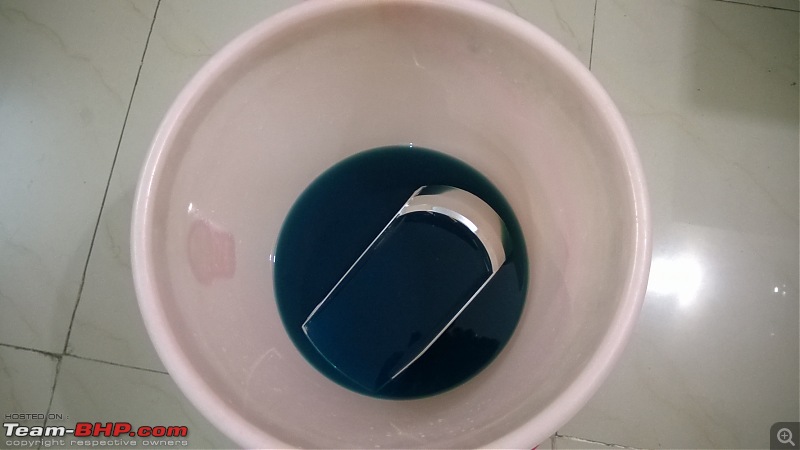

    Removing chrome is very easy - empty a bottle of Mr. Muscle toilet cleaner and Mr. Muscle kitchen cleaner into a bucket:
    DIY: VW Polo Bi-Xenon Projectors. Morimoto Mini D2S Stage III Installation-wp_20141030_19_17_10_pro.jpg
    DIY: VW Polo Bi-Xenon Projectors. Morimoto Mini D2S Stage III Installation-wp_20141030_19_32_25_pro.jpg
    And pour some water sufficient enough to immerse the reflector bowls. Keep them immersed for at least 3-4 hours. The best option would be to leave them in the solution overnight.
    Take the reflectors out later and using a scouring pad, scrub the bowls gently. The chrome would come off easily revealing the base material.

    TRS suggests that the positive part of the harness be connected to the battery directly. So open up the plastic flap on the battery:
    DIY: VW Polo Bi-Xenon Projectors. Morimoto Mini D2S Stage III Installation-img_0836.png
    There is one empty slot for fixing the +ve clamp:
    DIY: VW Polo Bi-Xenon Projectors. Morimoto Mini D2S Stage III Installation-img_0838.png
    Unscrew the nut, connect the clamp, tighten the nut and direct the wire through the channel:
    DIY: VW Polo Bi-Xenon Projectors. Morimoto Mini D2S Stage III Installation-img_0841.png
    Replace the plastic flap on the battery.

    Before resealing the headlights, the last but one step remains - attaching shrouds to the projectors. Shrouds do not serve any specific purpose other than hiding the internals of the projector; they are just there for enhancing the aesthetics. Without the shroud, the solenoid coil, cutoff shield and the bulb would remain visible. The bulb would leak some light as well and might be a distraction. All said and done, some shrouds may require some cutting and trimming before we can attach itself to the projector inside the reflector bowl. For instance, the reflector bowls inside the Polo, Ecosport, Fiesta etc. aren’t spherical, are wider but shorter and thus, some shrouds may not fit while some others would with some trimming. OTOH, the reflector bowls of the Punto, Swift, Beat, Brio, Ertiga etc. are spherical, larger in size and thus, would accommodate most shrouds without any trimming.
    Here’s an image indicating reflector bowls from various cars:
    DIY: VW Polo Bi-Xenon Projectors. Morimoto Mini D2S Stage III Installation-reflectors.png
    I had ordered the Apollo 2.0 Flat shrouds from TRS and had to trim the lower part and the side (adjacent to the engine) to avoid interference with the reflector bowl while attaching it to the projector.
    This was how the shrouds were trimmed:
    DIY: VW Polo Bi-Xenon Projectors. Morimoto Mini D2S Stage III Installation-apollo_2.0_shrouds_5_1.png
    (Image courtesy - TRS)
    After trimming and filing the rough edges, the shroud was fixed to the projector inside the assembly to check if the fit was right. Final adjustments may be made if necessary.
    After that, the chrome was stripped off using the same solution used for stripping the chrome from the reflector bowls (refer post #5, step no. 6) and they were spray painted in matte black:
