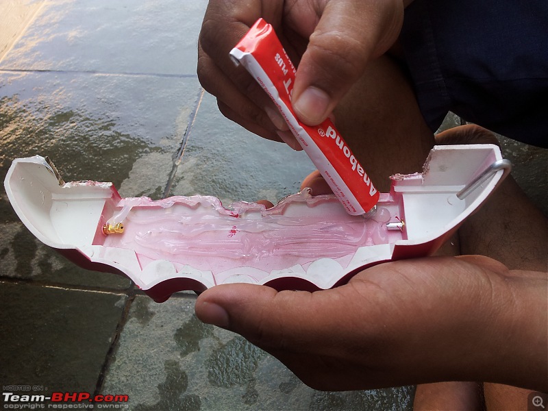

Applying glue generously so that majority of the portion is covered up.
DIY: Installing Brake Caliper Covers-8-apply-glue.jpg

The anabond you have used is Silicone Rubber RTV.
Rubber = Insulator for Heat.

I did not understand your point well,Anabond being an insulator for heat is good or is it bad ?
Mostly a bad thing. The caliper will not be able to dissipate heat as effectively
