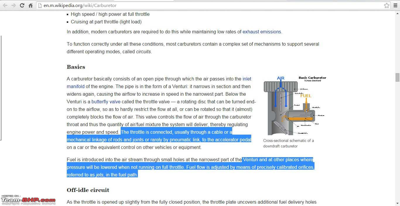

Where did I even mention that the carburettor does not have an arrangement for extra fuel during power operation.
What is the argument here?
I guess, the discussion point was, if the Accelerator of a carb'd car is connected directly to anything else other than the throttle plate? I only said it is not (apart from vehicles with accelerating pump and that too in certain cases)
Fuelling is mainly controlled through the suction created by the expanding air, or the engine. The accelerator cable doesn't (Accelerating pump case to be taken as an exception)
For the sake of simplicity and to avoid discussing something in detail which is irrelevant in this thread, I was taking the example of a simple downdraft carb.
From the same Wiki post that you have posted.

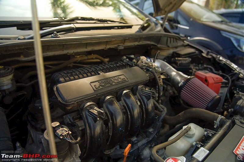

This looks similar to any conical filter upgrade.
Nevertheless, I have performed a Diy Version of it in my '17 Honda City iVtec.
https://www.team-bhp.com/forum/attac...1&d=1630604431

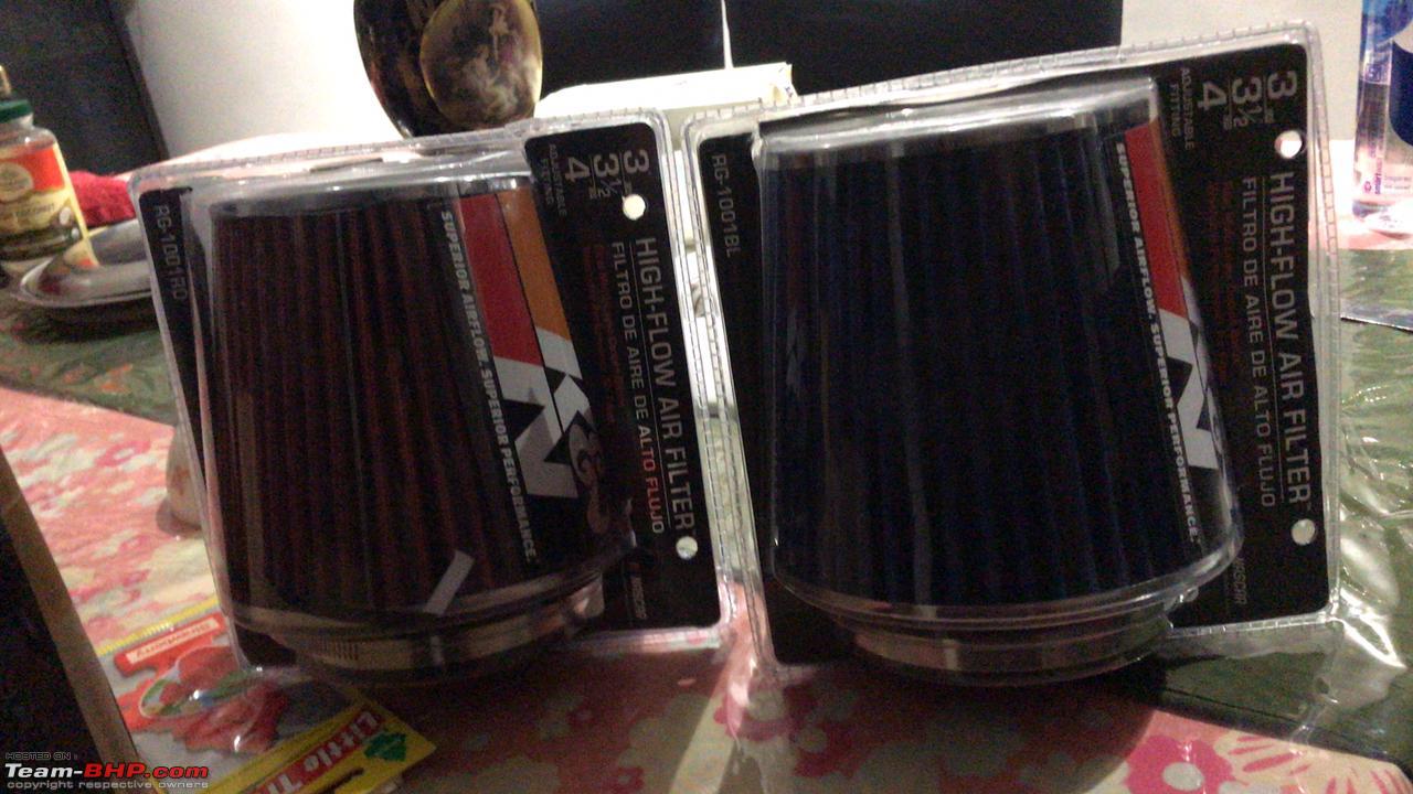

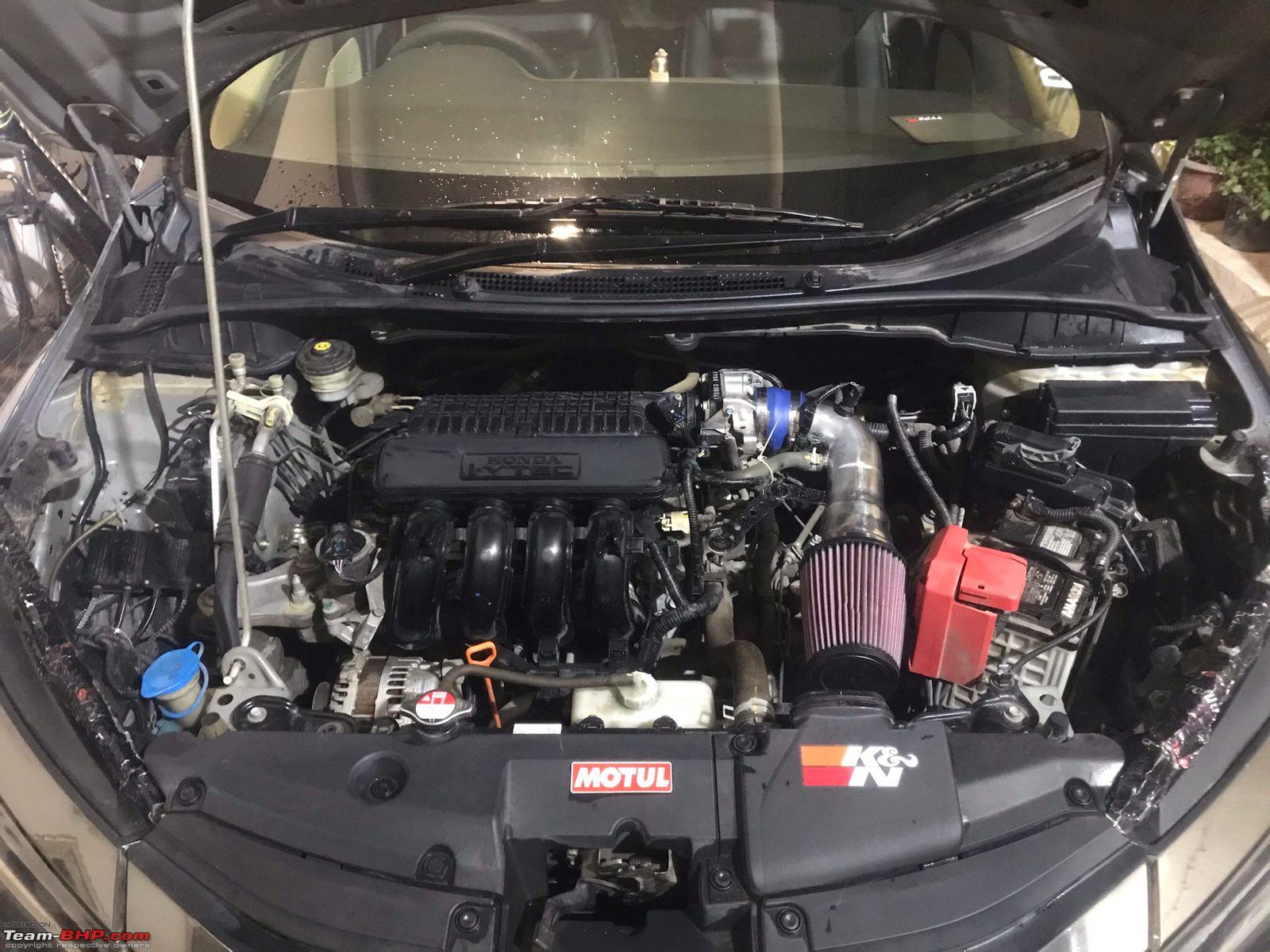

At first, I had purchased a K&N conical filter with customized Stainless steel piping, having slots for inlet pipe and MAF sensor.
https://www.team-bhp.com/forum/attac...1&d=1630604542
I enjoyed it very much but after some time it didn't please me in terms of performance so I sought to make a Cold Air Intake by using a suitable box.
https://www.team-bhp.com/forum/attac...1&d=1630604282

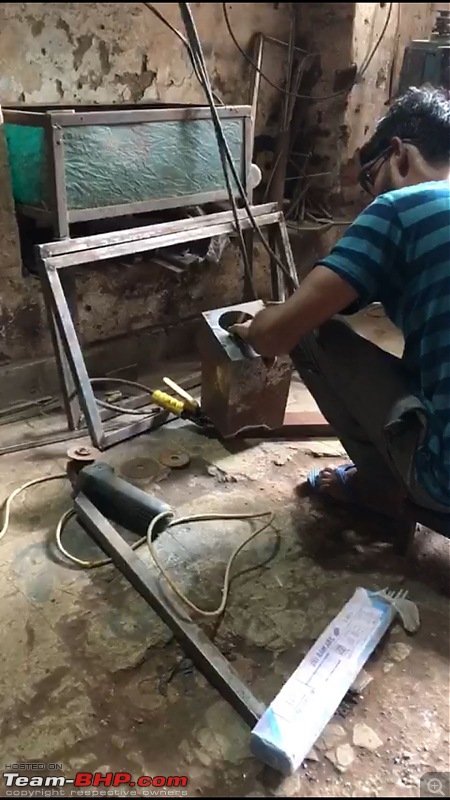

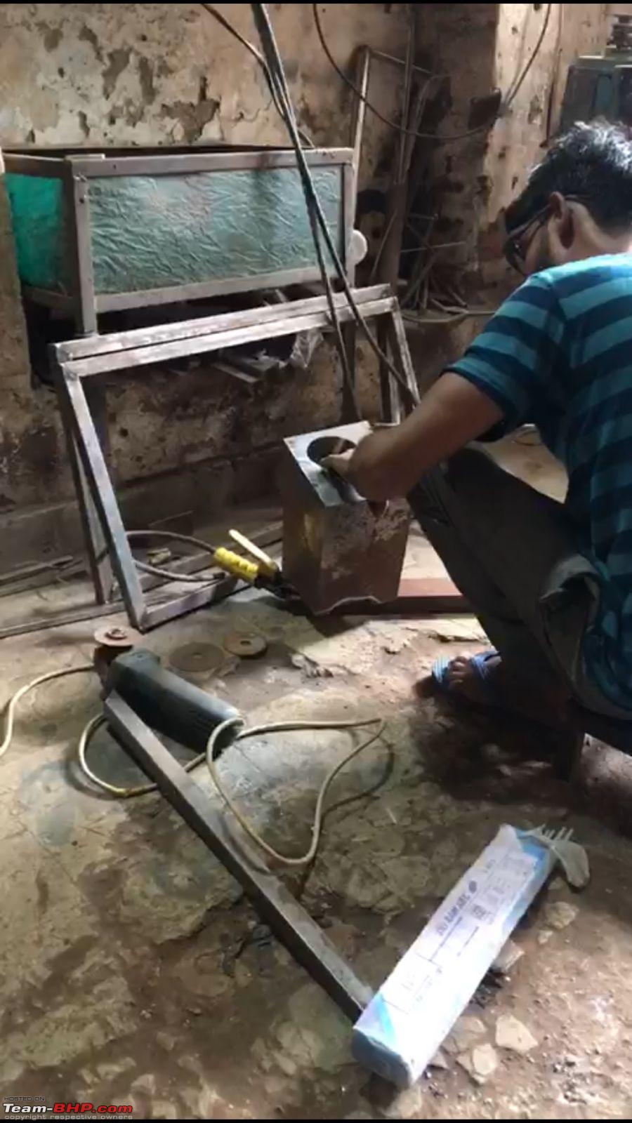

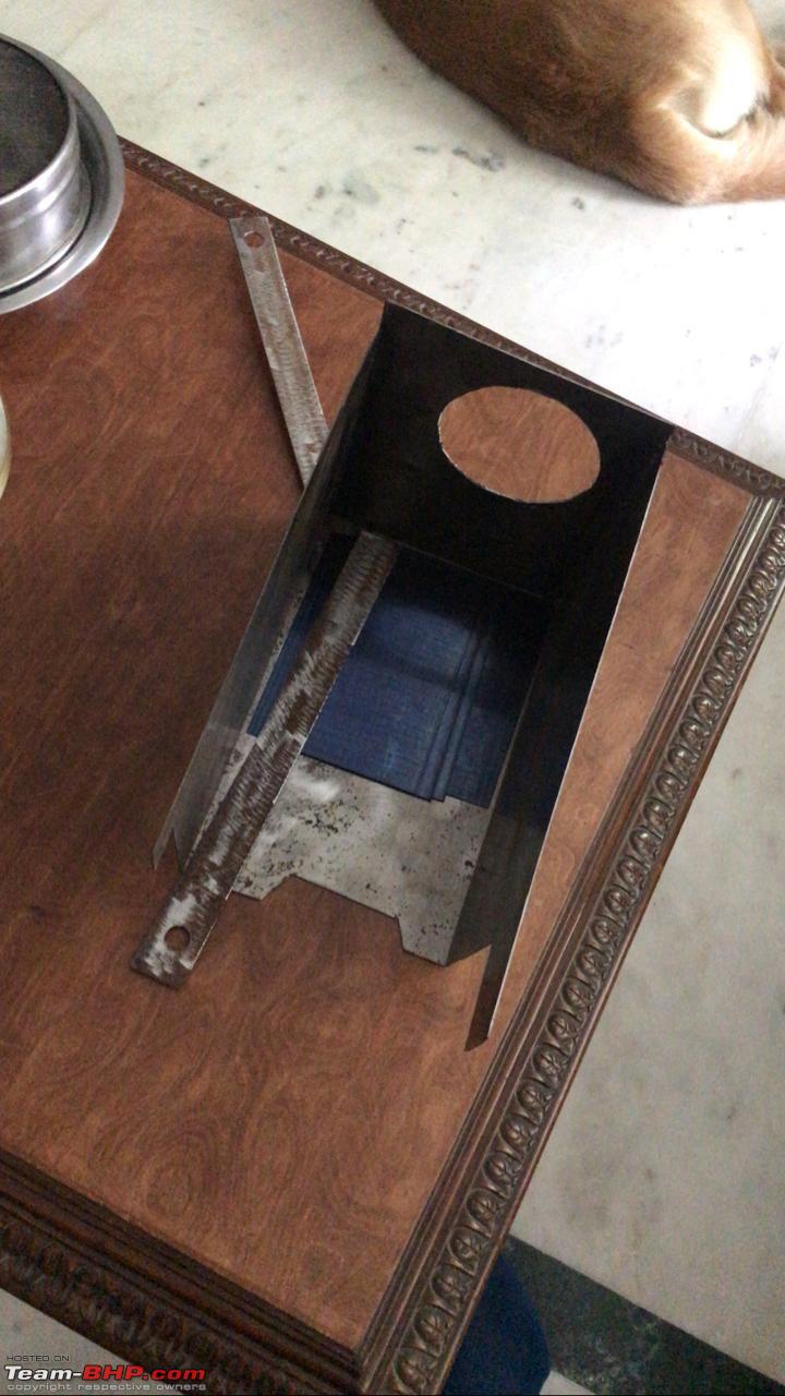

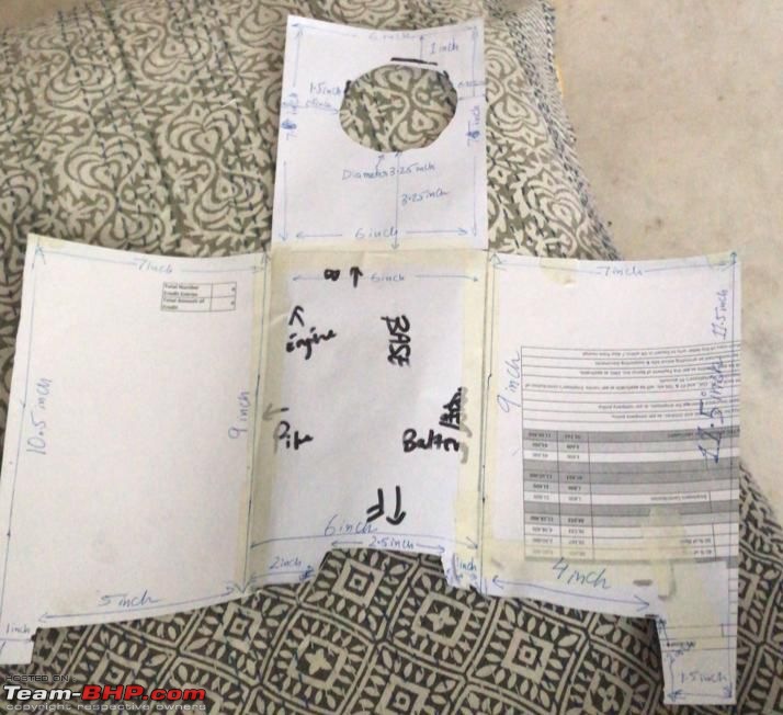

It all started with cardboard and paper. I had the design ready within a day but kept it aside due to the lockdown that struck in April in Delhi. I almost forgot about it till a month back when I found that blueprint I made while cleaning the garage.
I rushed to my local welder and had gotten made a Steel Box out of the design I had created, and to my surprise, it fitted perfectly without any major gaps. The gaps were filled when I had placed a rubber beading on every edge of it. Steel because it doesn't conduct heat, I could've gone Aluminium because of its lightweight but it would've just spoiled the reason for COLD AIR intake since it conducts heat well. It was eventually painted gloss black with spray cans and clear coated. It sits on the previous mountings I used for the filter's piping and one from near the front grill made sure it didn't interfere with the engine.
After recharging the K&N filter without the kit (mild gear oil) I felt a major increase in performance since it was not sucking hot air from the engine anymore. The car felt different and kept on pulling.
One month down the lane and it is still going strong.
