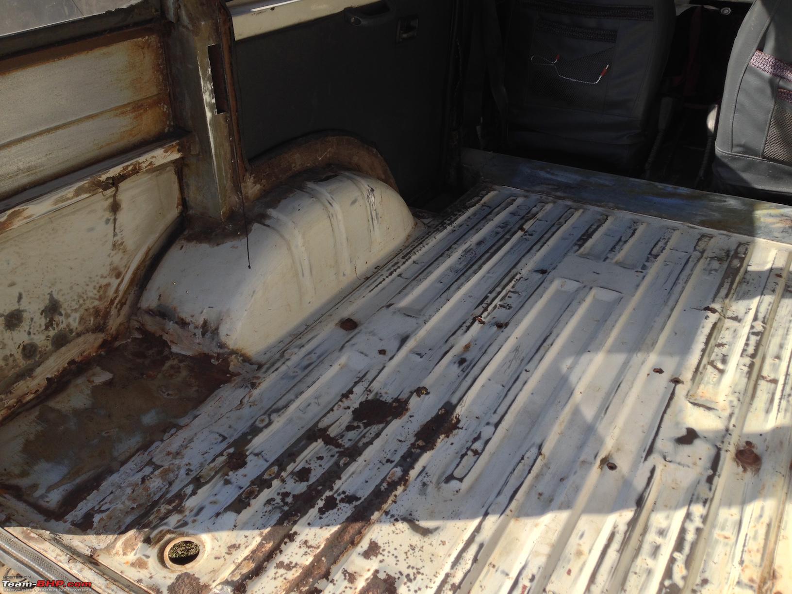

2. Wheel arches with dried carpet glue and rust
DIY: Anti-rust treatment for a Gypsy-img_0456.jpeg
DIY: Anti-rust treatment for a Gypsy-img_0458.jpg
3. Worst bit, may need to be cut off and a new metal sheet welded in place. Musing over what needs to be done. I am a fair welder, by the way.
DIY: Anti-rust treatment for a Gypsy-img_0457.jpg

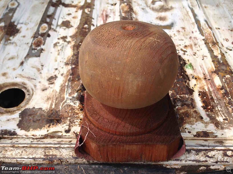

  2. Create a DIY sander block. Used an old table foot for a sander block and screwed sandpaper along its sides.
    DIY: Anti-rust treatment for a Gypsy-img_0494.jpeg
    DIY: Anti-rust treatment for a Gypsy-img_0495.jpeg
  3. Use steel wool in the sander block to get rid of tough rust spots. Use liberal amount of water (bucket and mug) to keep the surface wet and hands free of steel wool strands.
  4. Use 80 grit sandpaper with the sanding block for less rusty sills.
  5. After finishing use liberal amounts of vaseline on your hands to keep them moisturised.
Today has been rediscovering the abrasive power of steel wool and 80 grit sandpaper. Most of the tough rust is dealt with, but it did require a lot of It will take a couple of days to complete but the results are encouraging. See before and after

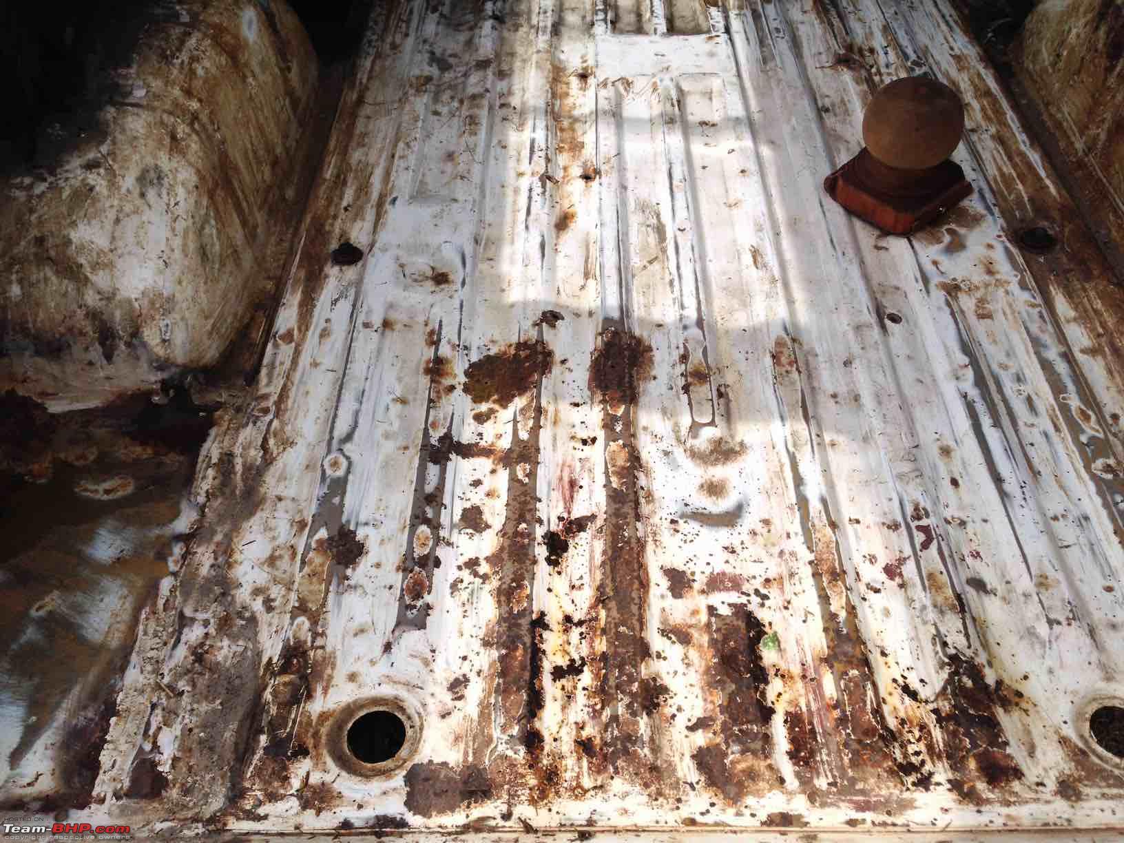

Before
DIY: Anti-rust treatment for a Gypsy-img_0493.jpeg
After
DIY: Anti-rust treatment for a Gypsy-img_0497.jpg

I have been kept busy by the recent rain and floods in J&K. An update is long overdue.
Originally Posted by Jaggu View Post
Has the metal given away and started holes on the bed? If so you need to do patch work.
Thanks Jaggu, work done so far:
  1. Using an angle grinder to cut off a two patches in the floor which had rusted through
  2. Closing the cut offs by welding (underbody and overbody) metal sheets.
  3. Final rinse and clean
  4. First coat of red oxide primer goes on the floor
Next few days:
  1. Apply knifing putty and prepare surface
  2. Sandpaper primer with 180 grit and wipe clean
  3. Coat 2 of red oxide primer
  4. Sandpaper primer with 180 grit and wipe clean
  5. First coat Asian paints Premium Satin enamel
  6. Sandpaper with 320 grit and wipe clean
  7. Second coat Asian paints Premium Satin enamel
Now most of the choices have a health dimension to them
  • Red oxide - the least harmful primer. As i pointed out earlier Zinc Chromate primers are carcinogenic.
  • Asian paints Premium Satin enamel. Contains no added lead / mercury / arsenic or chromium according to their flyer. After 2008 Asian paints claim to be following EU norms (<180ppm) for lead content.
    The other and easier option would have been to use a Rustoleum spray enamel. But as I dug deep, this is what I found
    EFFECTS OF OVEREXPOSURE - CHRONIC HAZARDS: Contains Titanium Dioxide. Titanium Dioxide is listed as a Group 2B-"Possibly carcinogenic to humans" by IARC. Significant exposure is not anticipated during brush application or drying. Risk of overexposure depends on duration and level of exposure to dust from repeated sanding of surfaces or spray mist and the actual concentration of Titanium Dioxide in the formula. May cause central nervous system disorder (e.g., narcosis involving a loss of coordination, weakness, fatigue, mental confusion, and blurred vision) and/or damage. Reports have associated repeated and prolonged occupational overexposure to solvents with permanent brain and nervous system damage.
    PRIMARY ROUTE(S) OF ENTRY: Eye Contact, Ingestion, Inhalation, Skin Absorption, Skin Contact
    From their web site
Originally Posted by ariesonu View Post
ALWAYS ensure that any such insulation material is FIRE PROOF.
Originally Posted by fighterace View Post
Good point. Where does thermocol stand in this department? What would you suggest instead?
Any consensus on this yet?
I am again planning on going the natural and easily available route here. Rockwool is out of the question and since I do not see why polystyrene will spontaneously combust, I might end up with that. But I am waiting for a better option, or a consensus here on what works best.
Oh and this is how things look like so far.
DIY: Anti-rust treatment for a Gypsy-img_0579.jpg
